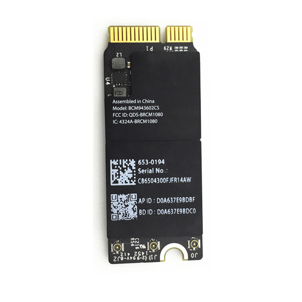

BCM943602CS (802.11AC 1300M WIFI+BT4.1) is the newer card can be used.

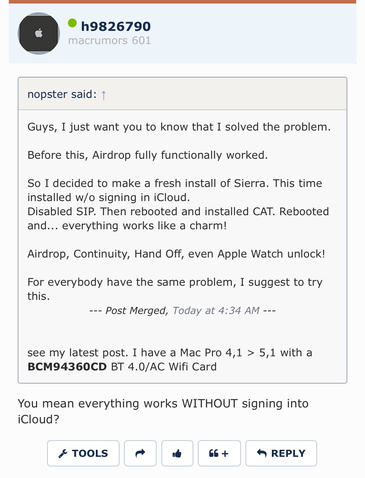

You mean everything works WITHOUT signing into iCloud?
Nope, read my post. With a fresh install of Sierra I didn't signing into iCloud, installed CAT, rebooted and then signing in iCloud!
You didn't say that, that's why I asked.
In fact, I read multiple times before I asked, because that looks strange to me.
I know, and I did emphasis if it works WITHOUT sign in, because you never mention that you sign in again. Please read my capture in the last post!
Misunderstanding. I believe you were writing about "without" signing.
It's obviously re-activated, because if you don't sign into iCloud again, every new feature (Continuity, Air Drop, universal clipboard or Unlock with Apple Watch) will not work at all.
Anyway, the only newer Mac Pro is the 6,1. And doesn't looks like any Wi-Fi /BT "card" in there. Apart from the SSD and RAM, I don't know if anything in the nMP can be used in the cMP.
Should it be BCM943602CD instead?

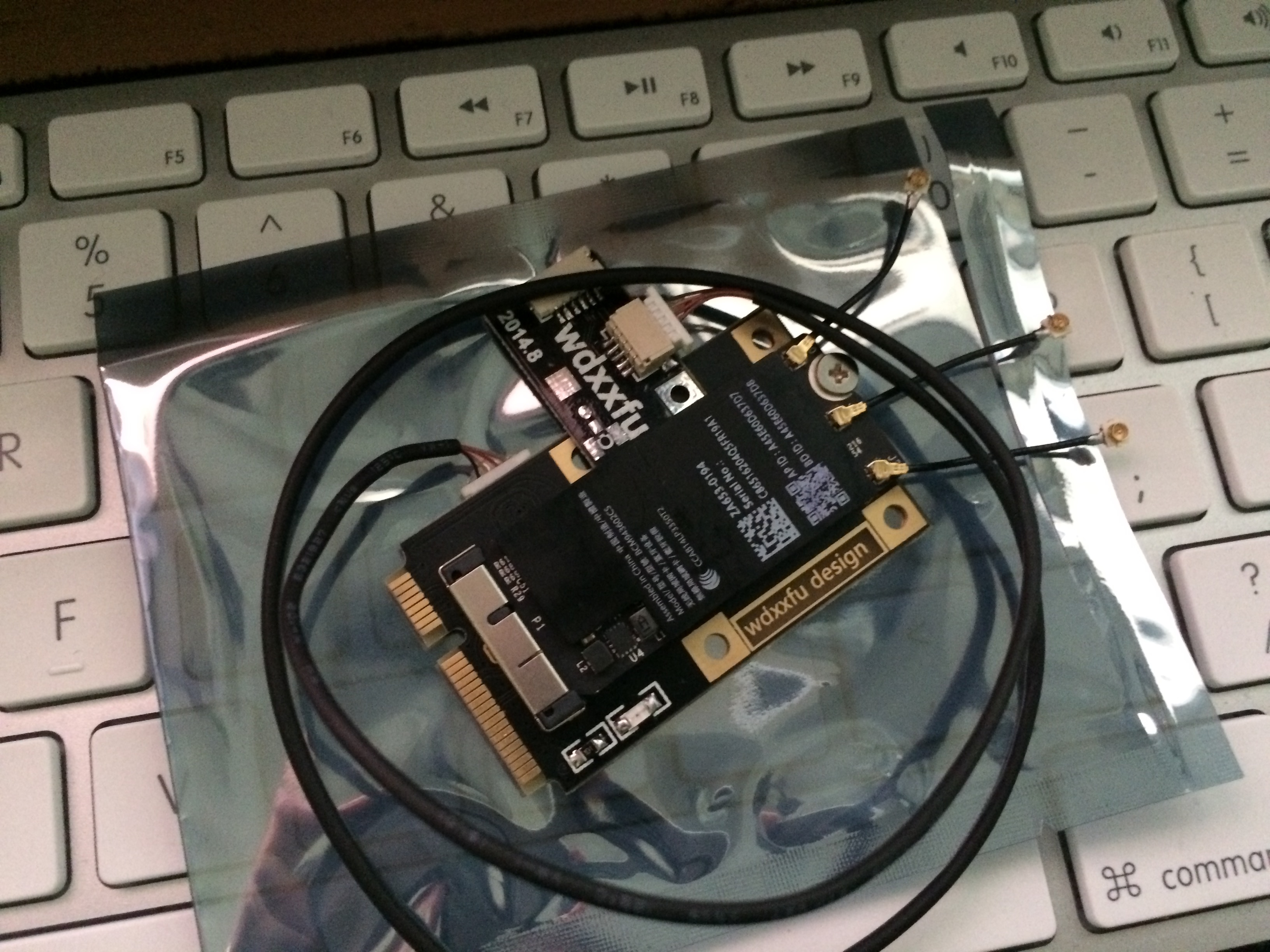

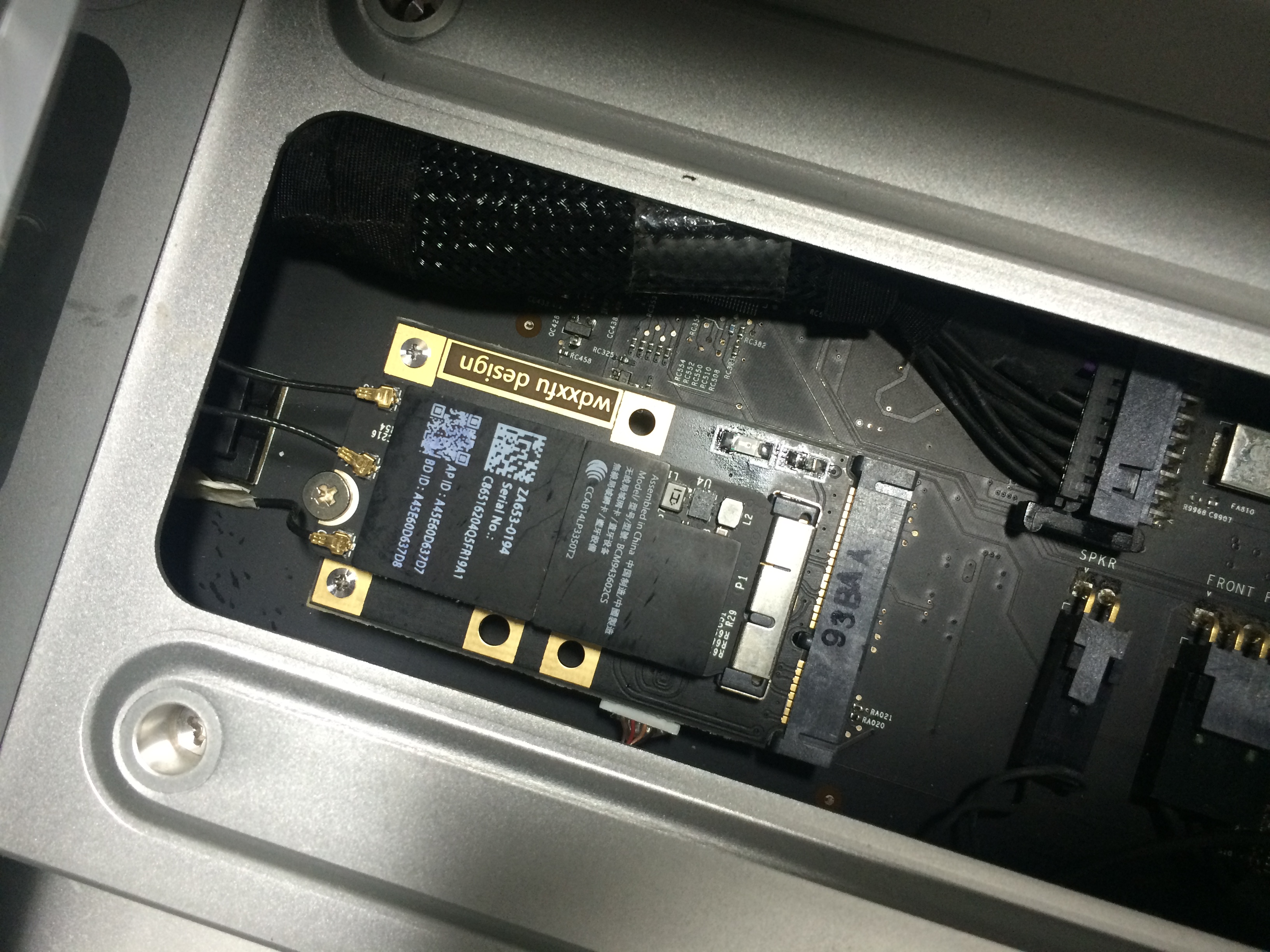

I just upgraded my old MacPro 2009 with this latest AirPort card. No CAT required, just plug & play. So cool! The installation's easier than I thought.
View attachment 650236 View attachment 650237
Thanks for your suggestion. I eventually get the same card from your seller. Good quality.
Since my 4,1 didn't come with the wi-fi card and all the antennas are hidden behind the logic board. Therefore I decide to remove the whole processor cage to do the wi-fi card installation.
Because there are plenty of room for my hand to move around, the installation process is very easy. The package cable length (between the wi-fi card and BT card) is prefect.
All Wi-Fi, BT work straight after boot. Airdrop works (between Mac and iPhone, my main purpose), Siri works (all functions need location required Wi-Fi), Handoff works (a bonus for me), Auto Unlock successfully enabled (tested, and work).
What worry me most before the upgrade is the Magic Mouse connection. I use BT Explorer to monitor the connection quality, very good, stay at max.
And I take this opportunity to clean all the fans, heatsink, graphic cards etc. Everything cost me around 1 hour, a successful upgrade with some fun.
Anyway, I have absolutely no idea which antenna is which, I just randomly connect them. Luckily has good result. I don't need extreme Wi-Fi speed, my primary network still via the cable connection. All I care is the BT connection quality. And I got it right by luck.

I contacted the seller and asked him which antenna is for the BT. He told me is the middle one. Also, to achieve best BT connectivity, the 2.4GHz Wi-Fi should set to channel 11 (if in use).

Have a little question. I received the WiFi/Bluetooth Continuity module for my Mac Pro 5,1. Have hooked up the antenna cables to jacks J0, J1, and J3. The bluetooth being hooked up to J3 and antenna cables 1 to J1 and 3 to J0. Is there any reason why antenna cable 2 to be hooked up to J2? I don't have it hooked up but I can see the WiFi networks and my bluetooth trackpad.
Thank you.
P.S. I'm having a much more difficult time trying to hook up antenna 2 cable to J2. Other parts were easy and fast.

BT is the port that must connect, not sure which port on your card, but that's a must.
The other ports are for Wi-Fi, connect all all them will give you better speed. One Wi-Fi antenna missing won't affect the function, but just slower speed.
And even though there should be a optimum way to pair those antenna and port, but it doesn't really matter, unless you have poor BT reception, then may be swap the BT antenna can help.

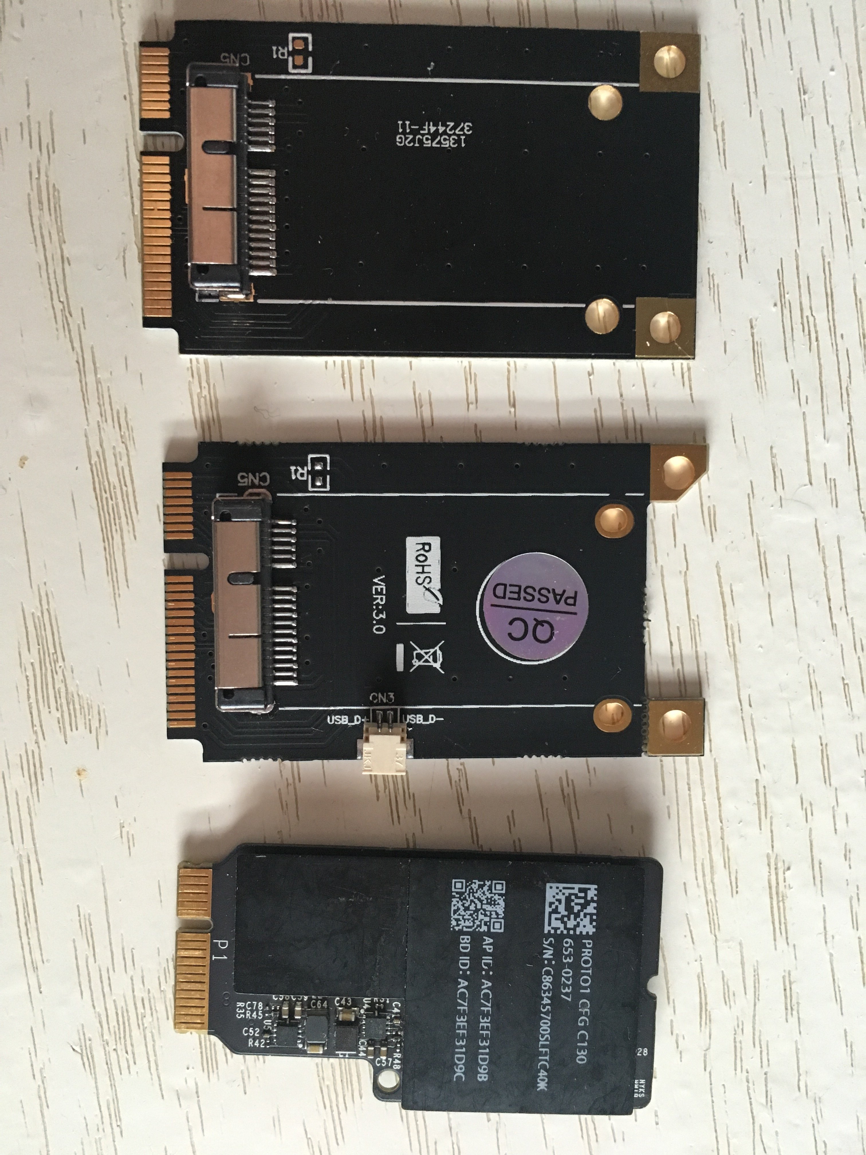

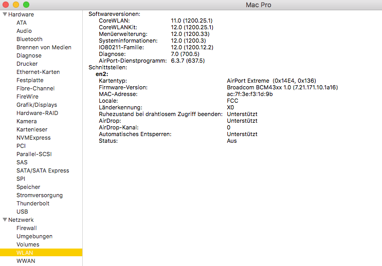

I bought this card: http://www.ebay.de/itm/121966117471?_trksid=p2057872.m2749.l2649&ssPageName=STRK:MEBIDX:IT
It is supposed to be a BCM94360CD, though it doesn't say so anywhere on the card, contrary to the pictures on eBay.
I tried it with two different mPCIe-Adapters, and none of them worked (I bought te second one because the first one didn't have the USB connectors). I expected some problems with Bluetooth due to the D+ and D- connectors, but I couldn't even get Wifi to work. The Mac does seem to recognize "something", but Wifi is disabled and can't be enabled.
Do you think I have a wrong or faulty BCM94360CD card?Any help would be appreciated
Thanks in advance!
Yes, it's a prototype version , and it only work until Yosemite, not work with El Capitan or higher AFAIK .
