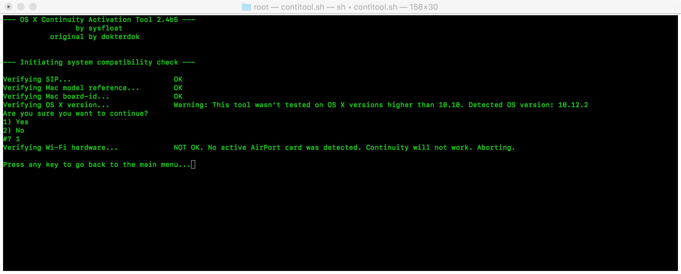

Any help please? All worked fine in Elcap, now i update to sierra and handoff is not supported! I try continuity activation tool and it generate this: NOT OK. No active AirPort card was detected. Continuity will not work. Aborting.
I haven't airport, so i don't know how can i resolve this...any suggestion please?
