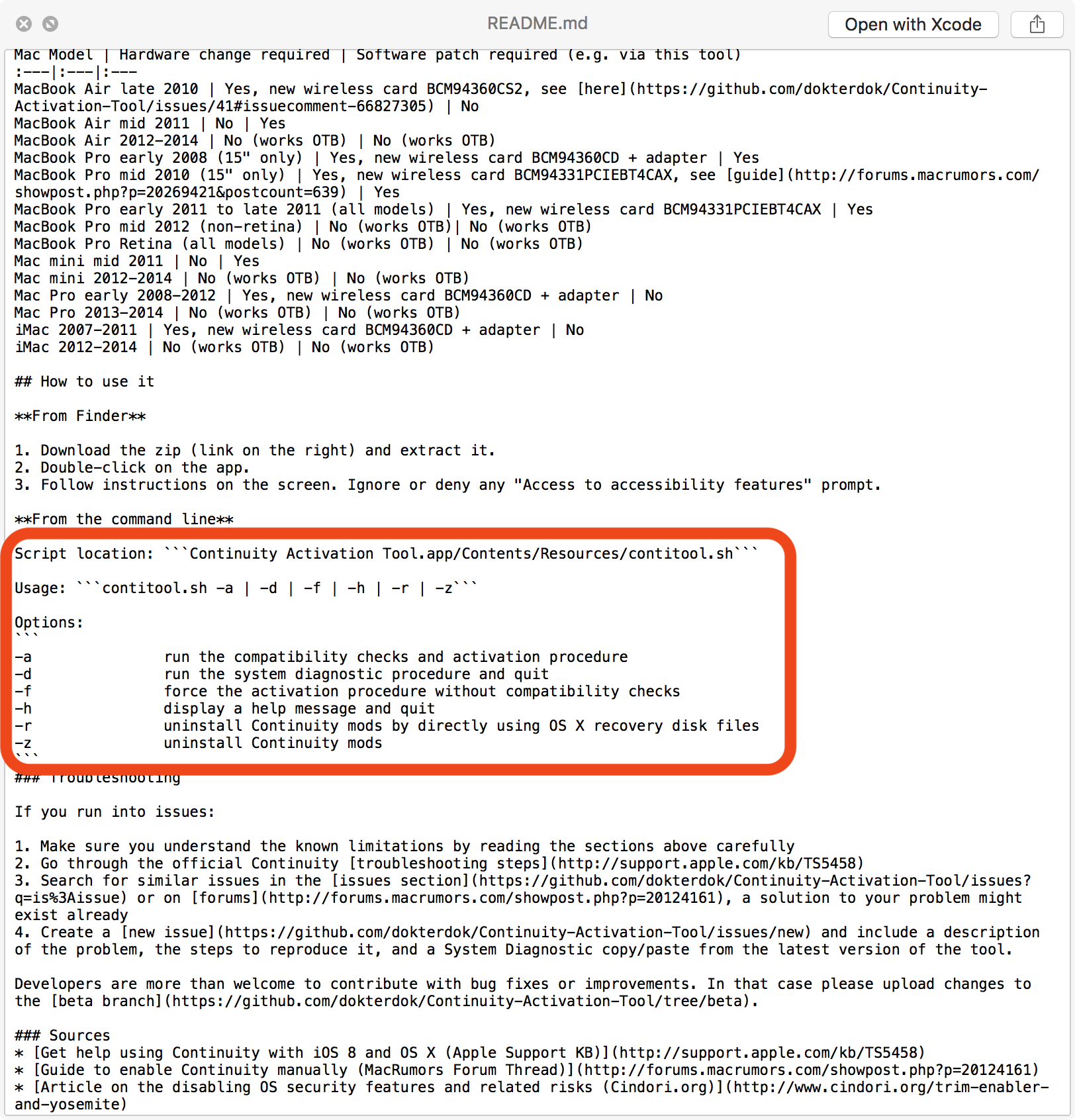

is there a manual way to remove CAT completely and reinstall?
My system is kinda screwed up and when I try to uninstall using CAT, it goes thru uninstallation, but when I try to reinstall, it says it's already installed and activated.
when I open up a contact on my iphone, mac will show handoff on the dock and will see it but it won't do it in vice versa.
I'd like to get this thing to work.
Which OS version you are running now? I experienced your symptoms back in 10.13.0 or 10.13.1. But from memory, since 10.13.3, Handoff work very flawless with CAT.
I'm 10.13.4
It looks like all the handoff function from iphone to mac works, but not from mac to iphone.
Yes
[doublepost=1525387555][/doublepost]or is there way to modify kext so that CAT thinks it's not activated so that it installs again?

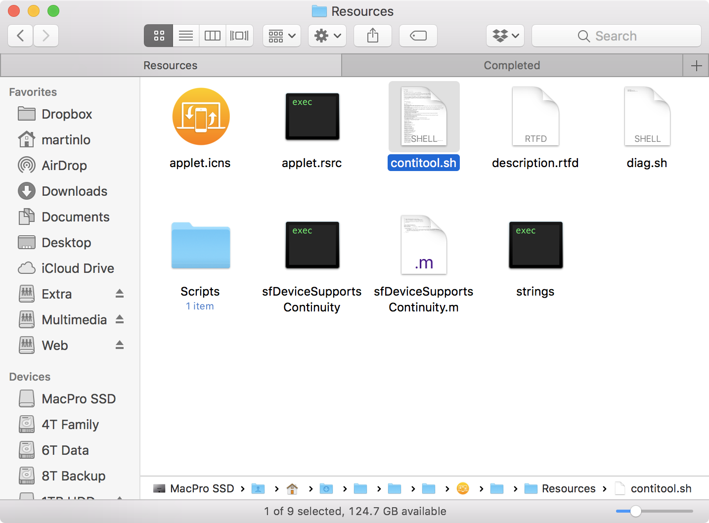

So, you tired both
sudo contitool.sh -r
and
sudo contitool.sh -z
but still can't uninstall CAT?
do you do that in terminal without starting CAT?
I haven't tried it.
From terminal, but you need to know the script location, which is stated inside the readme file.
