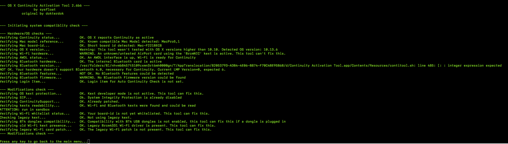

Hi, I've got a cMP 5.1 3.33. I upgraded the Bluetooth/Wifi card 5 years ago to the one sold by OSXWIFI and Handoff and Continuity have been working fine in Yosemite.
I loaded High Sierra on another SSD (test drive) and have been trying to get Handoff and Continuity to work to no avail.
When I go to System info ~ Bluetooth it simply states "No information found"
I've downloaded CAT 2.6b6 and disabled SIP before rebooting and running the Activation tool. I logged out of iCloud and rebooted, then booted into recovery and enabled SIP, then rebooted again and logged into iCloud, still no bluetooth. I also tried running the code from page 39 of this thread, no luck:
802.11ac, BT 4.0 and Continuity & Handoff are working on Mac Pro 2010 (Keep Updating)
The Compatibility report says the bluetooth card is active and continuity is active - it's all working in Yosemite but not HS.
Am I missing something there?
I really want to get this working so I can upgrade my GPU and get Mojave, but am not going to spend the money on a GPU if I can't get C & H working.
Look in System Profiler > USB. Does "Bluetooth USB Host Controller" show up there? What are the Product and Vendor IDs?
I don't think CAT is going to help you so long as System Profiler > Bluetooth shows "No Information Found".

Thanks bookemdano, but I think I've stumbled on the solution.
To make for a neater install I was trying to use an internal USB on my Sonnet PCI USB 2 card to connect the bluetooth card. I recalled that I did originally have some trouble getting the internal USB working, however it did eventually start working and I have been using the internal USB with Yosemite for ~3 years and the card has been working fine. It's a bit puzzling why the internal USB seemed to be the stumbling block with High Sierra when it was working fine with Yosemite.
Anyway, I thought I would try to plug the USB into the external native USB and when I rebooted into High Sierra the card was there and it was working.
