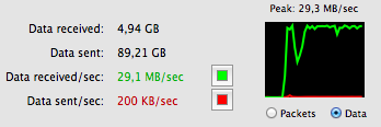

Just upgraded from a Time Capsule 802.11n (2nd Generation) to the AirPort Time Capsule 802.11ac, the process was pretty smooth using the iOS app.
Now, I'm moving the Time Machine data from the old TC to the new TC via Cat6 cable on the Mac mini (2012).
My MBA (2012) is ~18 feet away from the TC on 5Ghz band.
