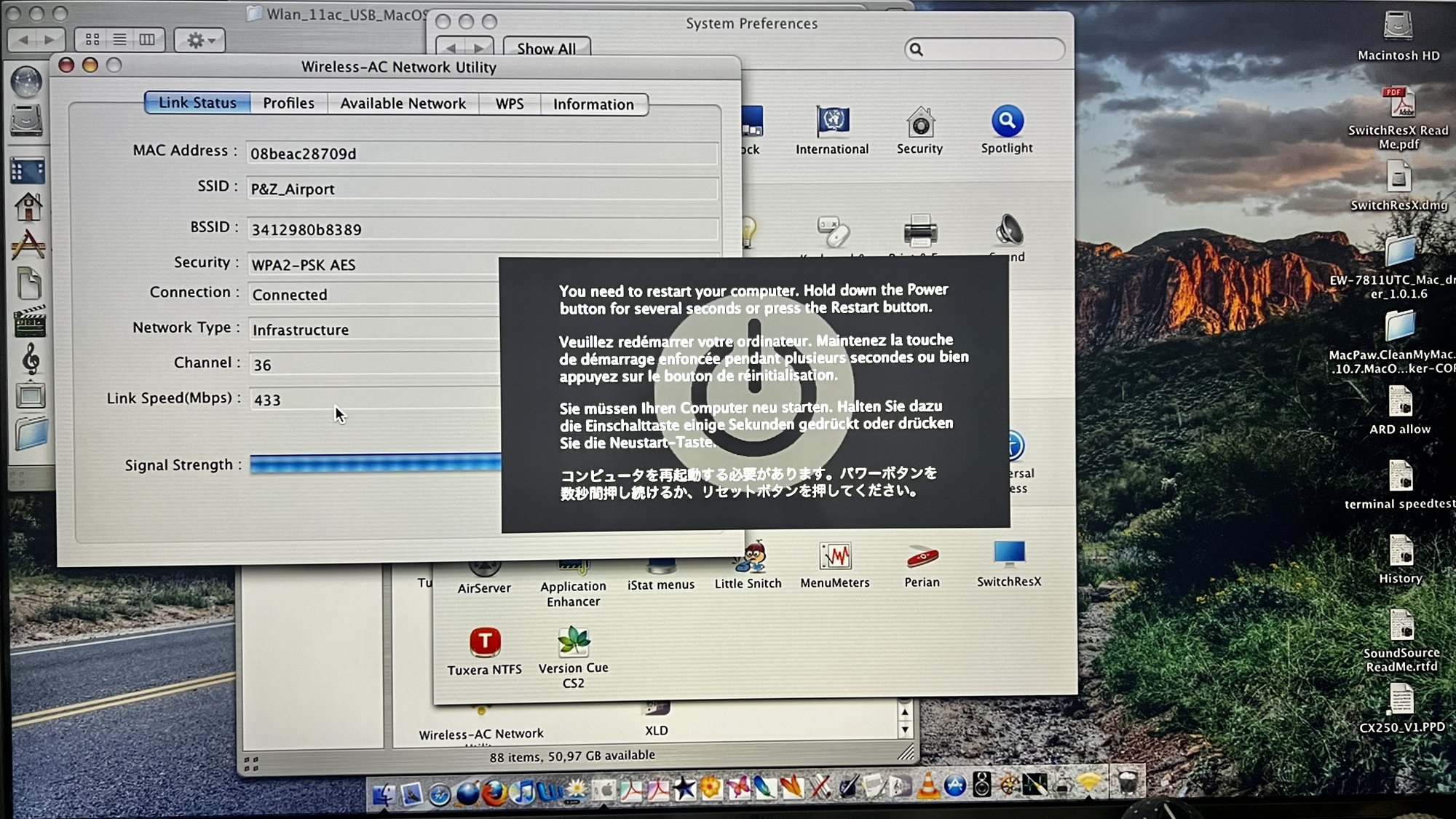

I have no idea how you got it working! i bought 3 7811utc units specifically for my old macs running 10.4 (mini G4) and 10.5 (2 powermac G5s) and every single driver i install from the manufacturer and forum posts either dont open the wireless utility or dont recognize the dongle, or, in worst case, the ones that i have received from Edimax crashes the computer either when i attach the dongle or when the wireless connection is established. The one you linked also just crashes all 3 of my old computers constantly.

Yes, after installing it, it didnt recognize the dongle. In the meantime, i got it working, i had to do a 2.4 only network and they all work since then with OPs drivers. the operating system cant recognize 5ghz so it panics when it tries, 2,4 works steadily at 72mbps, which is quite slow, but better then lan cables hanging around. also, the mac mini g4's wifi speed is double with the dongle then with airport. i would have loved to use them at 5ghz speeds but it seems i cant.

As a bonus here’s a pic of the g4mini doing 433mbits right when crashing, its connected to a 55inch tv so i only managed to take an actual picture instead of a screenshot, you know, like grandmas do, hahaha

So, if it works why the kernel panic ? Was that because of your ram in the G5 ?
As far as i know leopard is not compatible with 5ghz, it didnt exist then really, it only knew it up until wifi b/g. Probably thats why. I might be wrong, the mini is 1.5ghz 1gb ram, the g5s are 2.0ghz dual from 03, with 6 and 3.5gb ram, 8gb soon. You think i should try again and see is it panics?
