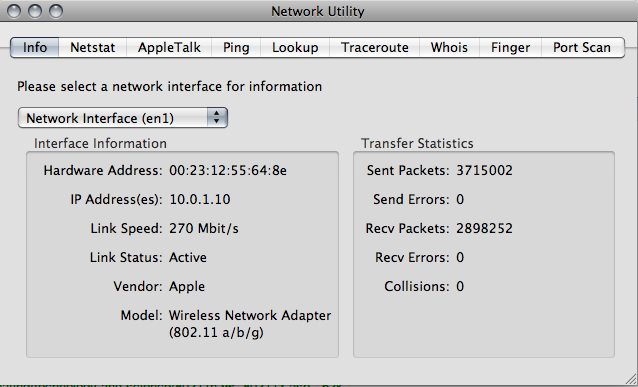

Oh, I opened network utility and this is what I got:
I've seen screenshots with 802.11n enabled, 802.11n is supposed to be listed under Wireless Network Adapter.
Well you are getting the 130 Mb/s speed that is 802.11n speeds. I've noticed that the new MacBooks might not be reporting 'n' support though.

I phoned Apple tech support earlier today. They told me it's just a glitch in the OS software code and the "n" is just not showing., but as you can clearly see, the speeds are more than twice what g can support.
Also mentioned was that a likely update in the near future would remedy this discrepancy in the Network Utility App.

Mine is also missing the 'n', but my speed is good.

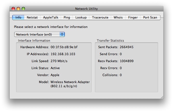

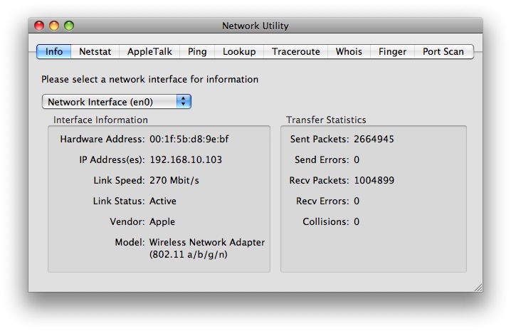

Not true. Here's my MBA with a TimeCapsule
