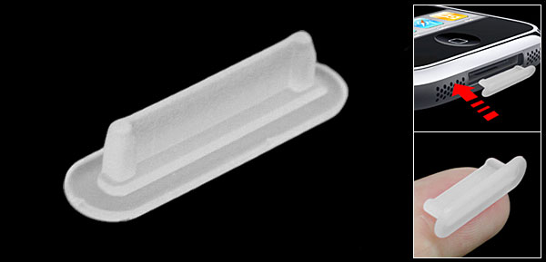

Looks like you would benefit from a dock connector cover:
As well as a headphone jack cover:
