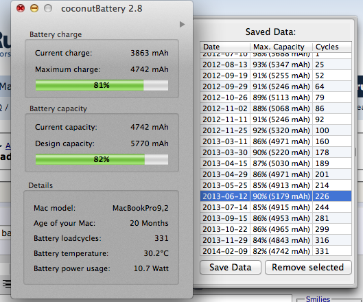

Hi,
my mid 2012 mbp has only 82% of battery life with only 330 cycles, is it considered "normal" by apple?
I'm not sure, what you are doing, but you are doing something really wrong....
on my opinion your capacity drop is too heavy...
I tend to keep it powered with the power source when I'm at home (95% of the time). Is it better to run it on battery power even if I'm at home? Wont this increase my battery cycle drastically?
Is there a chart that lets you know if you are eligible with a replacement from apple?
I don't think so, my mid 2012 mbp still charges to 5560mAh... Oh, it has 300 cycles too...
what is your use? we have roughly the same cycles and model (mid 2012)
Apple might get you a replacement when you have less than 80% capacity while having less than 1000 cycles.

I'm at 82% not 79%, and in less than 4 month my warranty will expire, should I contact apple support now?
I think mine was close to 80% after 2.5 years. I took it to Apple, they ran some diagnostic, and a couple of hours later I had a brand new battery.
What kind of warranty is this? 2 years only?
The battery seems to be at the low end of Apples own specifications (up to 1000 cycles with 80% charge remaining), so maybe it is a good idea to show it to Apple. But nobody here can guarantee you that it will be replaced.

it is a consumable but it has consumed more than the normal rate. there is the problem...maybe at 82% I'm not legally eligible for a replacement but at 79 i SURE DO. on the apple website it states that the batterys are designed to hold at least 80% of the capacity in 1000 cycles (it does not say however if the 1000 cycles must be in the 2 year of warranty).
being very close to the limit, with a third of the stated cycles I expect they will replace the battery, if they don't I'll wait the 23rd month and try again hoping it wil have dropped under 80% by then
While you may get them to make an exception, usually Apple won't even look at it until the battery health is below 80%.

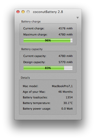

Doesn't seems very normal, at least compared to my 2010 MBP 13".
