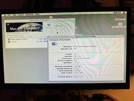

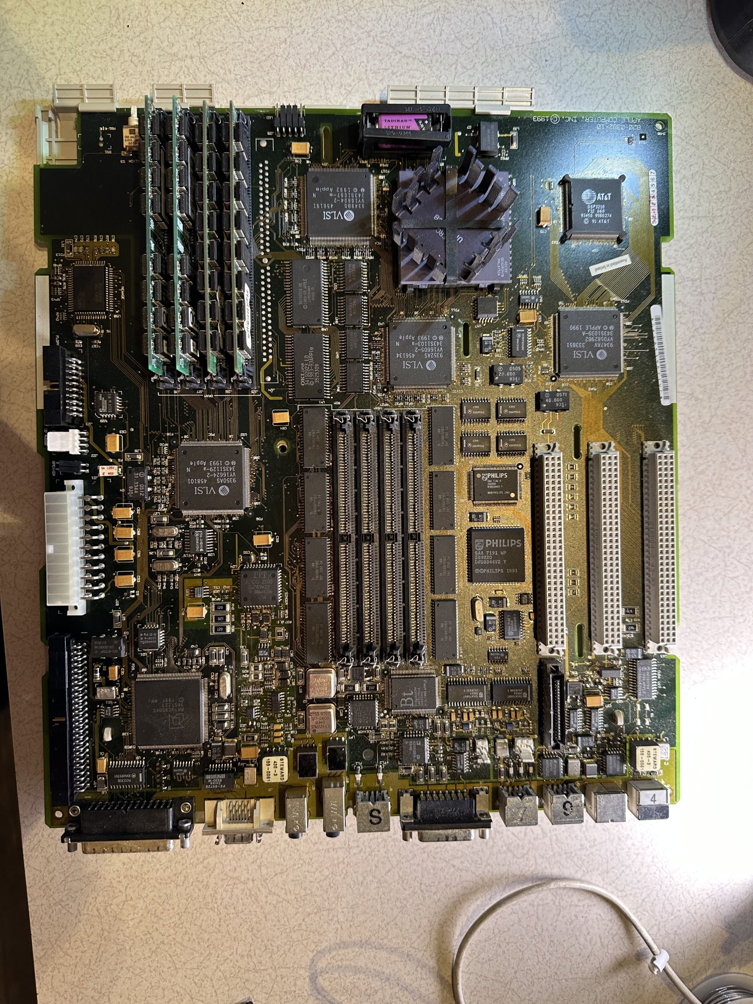

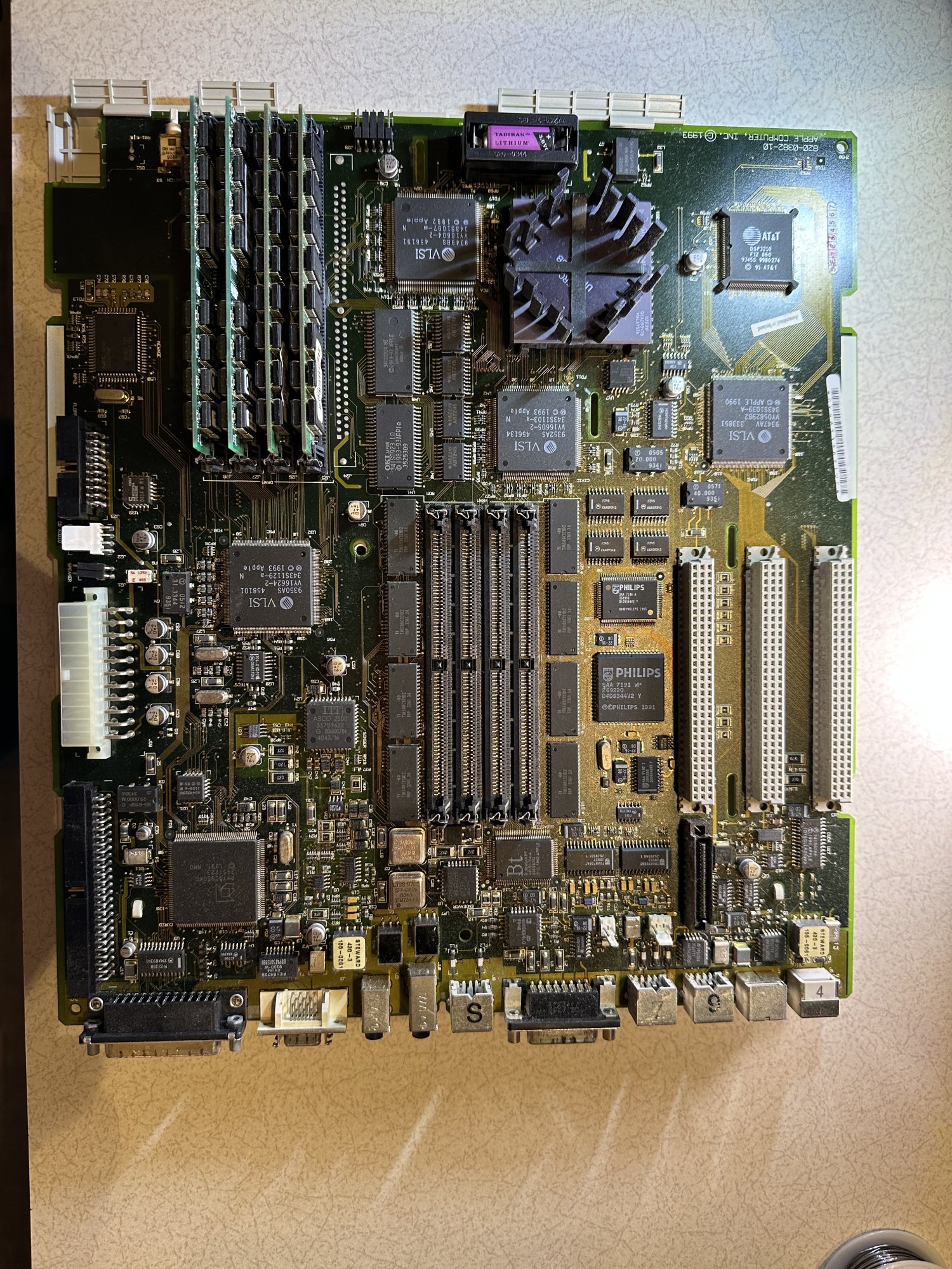

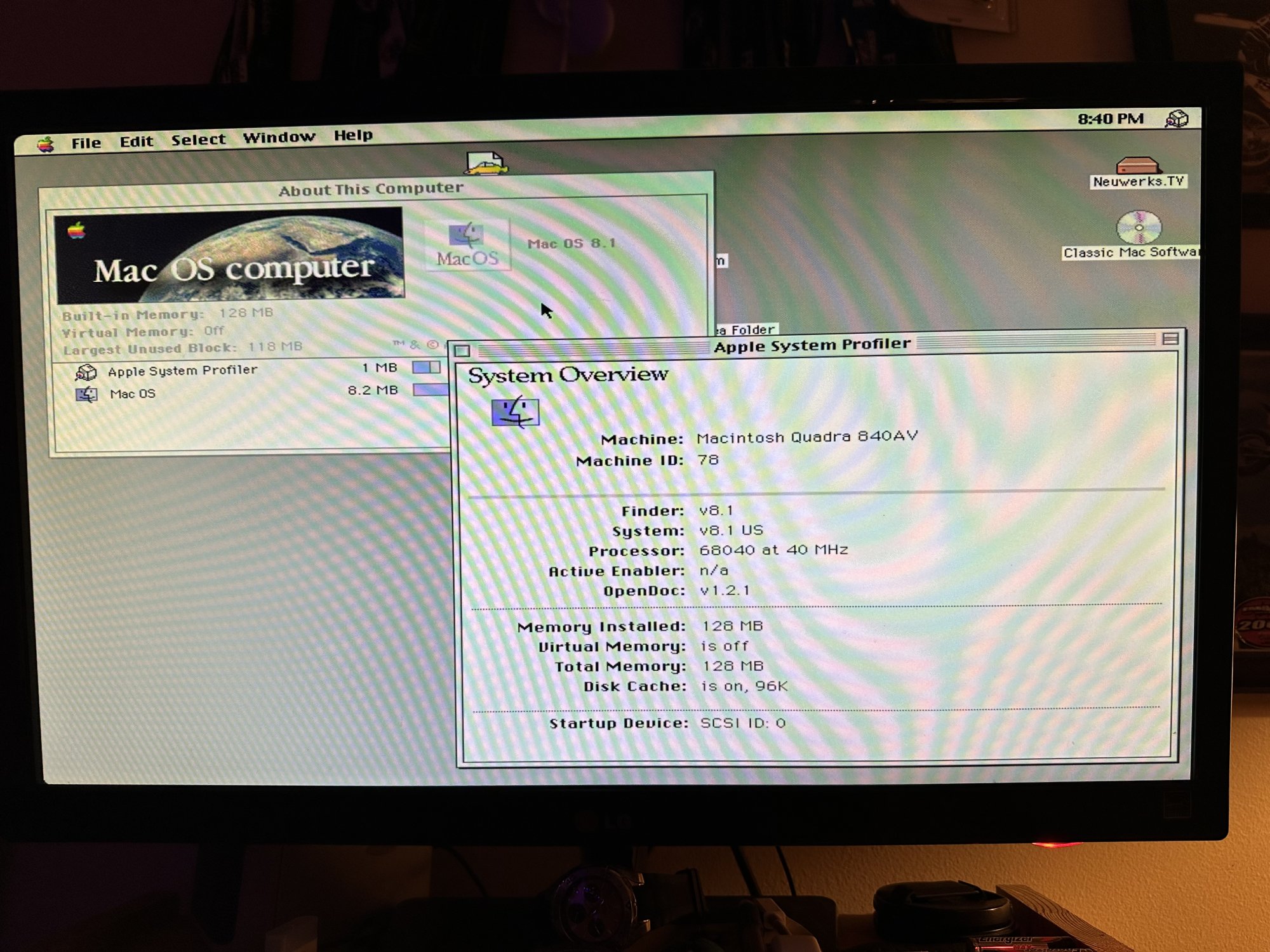

Before I booted this machine up I decided to pull the logic board that has never been recapped since I purchased it in the mid 90s. Visual inspection looked good, so I put everything back and booted it up.
After an initial chime, I saw no progress, but letting it sit for a minute or 2 revealed that my primary SCSI drive had failed, the system switched to my 2nd drive with a base install of OS 8.0. Man it was nice to see that desktop and see this machine up again!

- I have put in an order for replacement capacitors for this system

Took a couple hours, but replaced all the capacitors on my 840av. A couple of REALLY tight spaces where I was worried I wouldn't be able to fit the larger Tantalum capacitors, but had to slow myself down and work some unique angles to make it work.
Biggest oops of the entire project was melting the plastic cradle that supports the logic board inside the case. I got a bit too close with the rework heat gun.
Super fortunate that it went well, and device booted first time!
