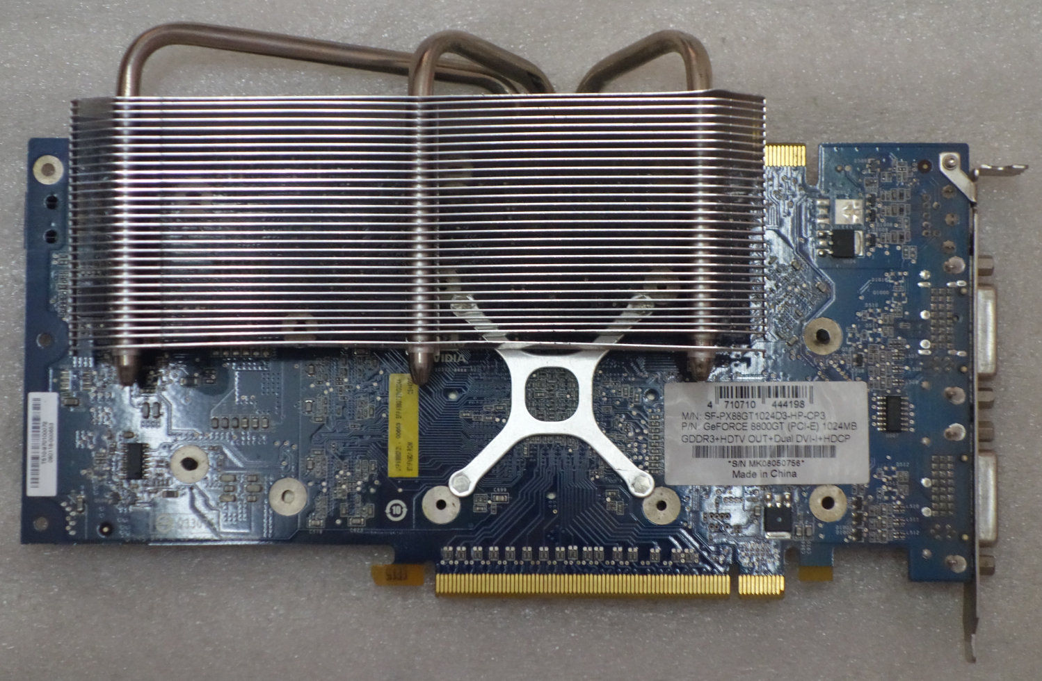

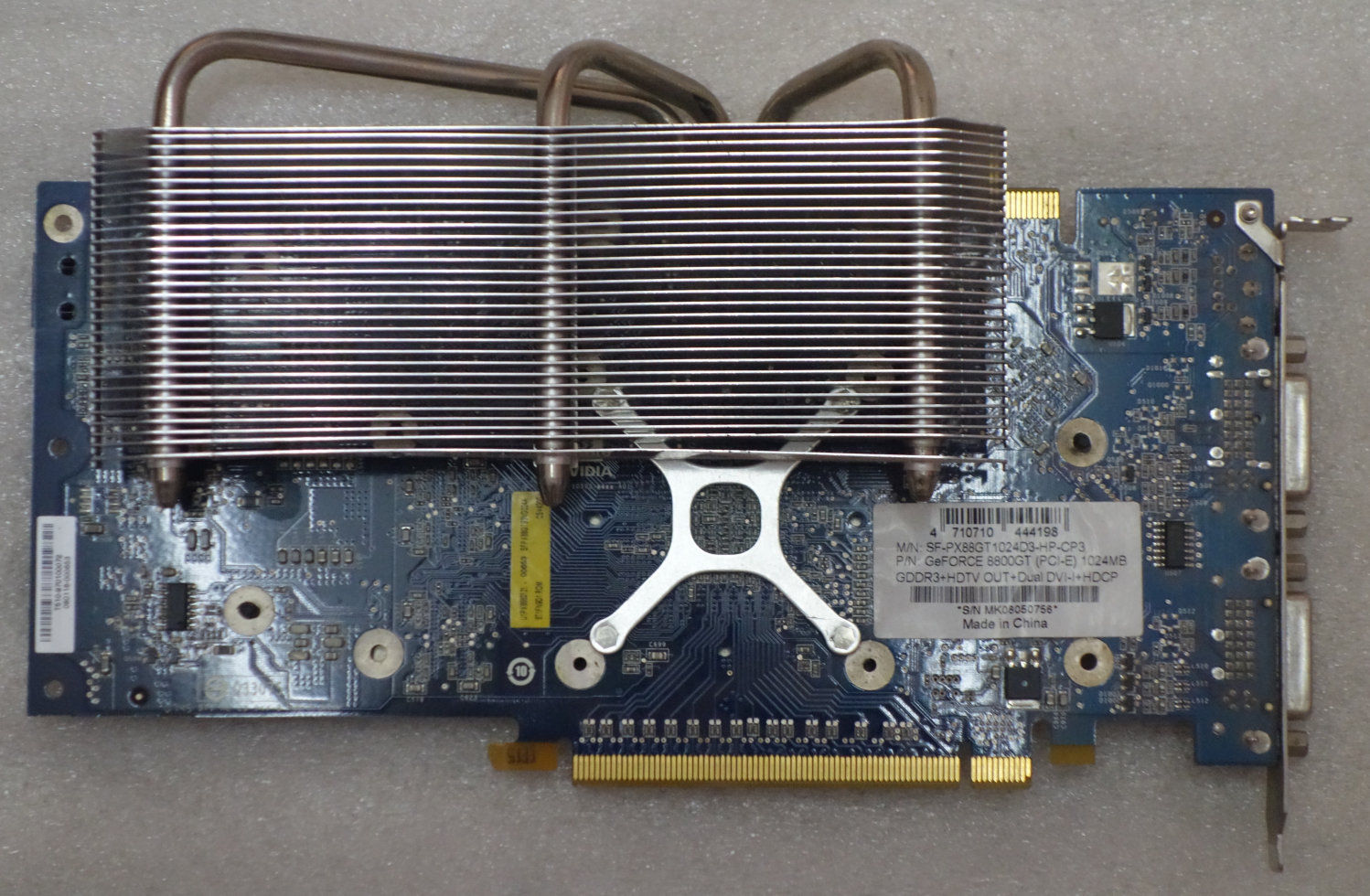

I've yet to recieve the card yet, should arrive tomorrow. In the meantime, I checked the eBay auction and the only type of model number I can see from the photos is this one (attached photo). On which cards can I flash the 32efi on?
Sparkle was more of a European brand, didn't see too many in US.
But vast majority of ones I saw had 64K chips. Only EVGA brand with Blue/white/black coolers (sometimes orange) used 128K chips reliably.
I wouldn't count on a 128K chip, but you might get lucky.

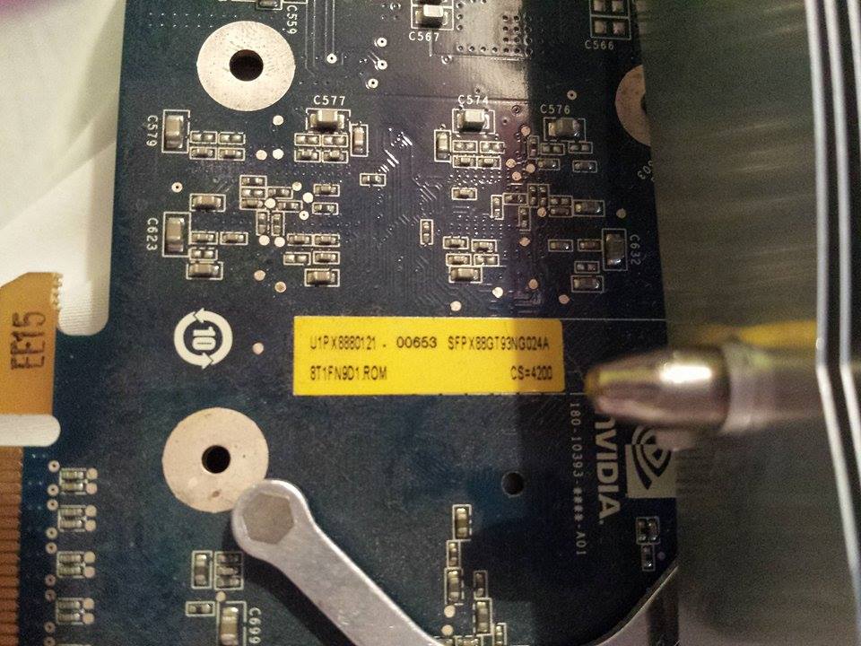

okay, I have reccieveed the card today. I cannot find anything you mention, can't see chip size etc but that might be because I can't understand this label. This is the other label on the card - I assume this is where it says the rom chip size but I dont understand it. (attached)
You'll find the ROM size by looking into the data sheet of the SPI flash on the card. You'll find the exact name of the SPI flash either by searching for it on the card (it's not on the photo) or by using nvflash.
I cant find that either. MacVidCards, how much do you charge for 8800gt 1gb to be flashed to efi32? thanks
You'll just have to fire up nvflash and do e.g. a bios dump, it'll show the name of the spi flash.
I don't think sending your ancient 8800 to California for flashing isn't cost effective, you'll pay multiples of what the card is worth.
