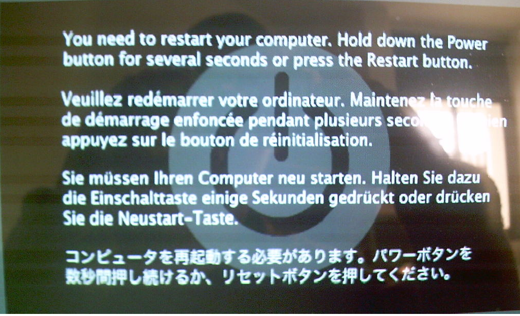

After using my Mac Pro 3,1 this morning I start to get random black squares appearing on screen the I get system crash. Ok, I try to reboot but now it won't get anywhere past the Apple logo boot screen - the whirly circle stops spinning and then stops. Numerous tries later and the same thing happens.
I can't get it to boot from the CD, I just get a 'you must restart' message.
I've tried all the keyboard combos to get it to boot but it's not having it. I've also reset the PRAM and NVRAM/SMC.

Does anyone know if a dead graphics card will prevent OS X from getting to the log in screen?
^^^Yes, it could. Did you try safe mode? (Start with Shift pressed).
Bake the 8800 as MVC said. BTW, if it were HDD issue it shouldn't prevent from booting from Install disc.
Safe mode doesn't work, booting from the CD just brings up this message......everytime.
Before I try the baking I need to get myself some thermal compound, I'll try it though.
Wow! I just baked my 8800GT, it works!!
Thanks for the advice guys, very happy.
