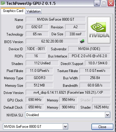

Nvidia OC ROM
Here it is,
650 GPU
1625 SHADER
900 MEMORY
so you dont have to Edit all the Time you boot up Windows and it is 100% Stable .
let´s say you buy a Card with 690 / 1625 Shader / 1900 MEMORY you can Edit it before the Flash.

I'm getting a 15% boost in frame rate at 700 MHz in Crysis. The other advantage of editing the ROM means that the overclock sticks in OSX.
