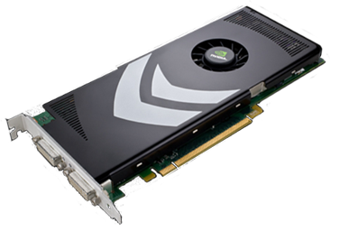

I could make my own picture but it looks just like the one on this internet pic.
Single slot, 2 x DVI, 1 x pci-e powerconnector on the rear.
