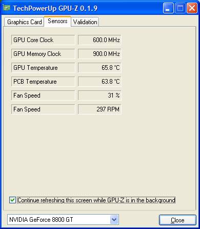

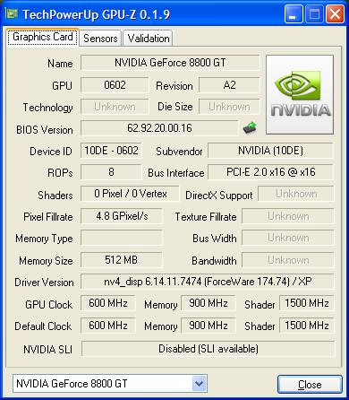

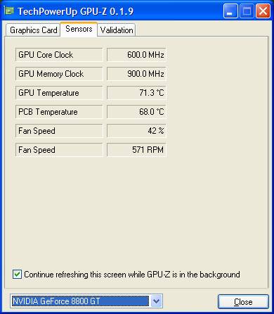

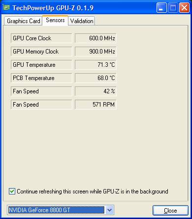

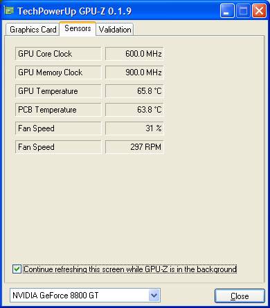

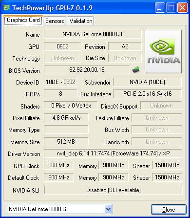

Hi tobyg,
I just ran 8800GTS without RivaTuner running 8800GT32.rom (reference 8800GT speed).
Auto Fan control works fine for 8800GTS with Apple 8800GT32.rom.
I ran Unigine Sanctuary Benchmark for 30 mins to bring up Core temp to 71.3. Fan speed scaled nicely from 30% (base fan speed under 8800GT) upto 42% at 71.3 celsius. According to the Apple 8800GT32.rom setting, the fan speed is 30% upto 68 celsius then scale up 100% fan speed at 108 celsius 😱
Obviously Apple wants to run 8800GT hot in order to keep the fan speed / noise down.
Maybe something is wrong with your card. Try reflashing your 8800GTS card with Apple 8800GT32.rom and try it again. Or you can reflash with original EVGA 8800GTS firmware and test it under Windows to see if fan will regulate. If it doesn't auto regulate with original EVGA 8800GTS firmware under windows, you can RMA for replacement from EVGA under warranty. Good news is that they are very good with warranty replacement.
