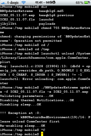

EDIT: I ran it on my phone and I got an error saying that CommCenter wasnt unloaded. Here's a picture.
Did you reboot and try again? Or do you already have blacksn0w installed?
I rebooted and tried again. Always the same thing.
Blacksn0w was installed by the previous owner. I just recently restored to custom 3.1.2, but I'm still having the same problems. (because the jb didnt touch the bb)
Nobody else had problems with this?
I tried changing permisions on the CommCenter to 755, but still nothing.
