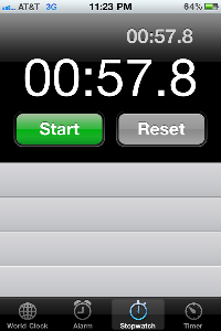

I have the same macbook model (late 2009), I thought that 4gb is enough but after installing vmfusion it made it clear to me that it isn't. 4Gb is Apple's recommended maximum memory on this specific macbook. How long have you had it? Any problems you encountered since replacing your memory? My current macbook boots in more or less a minute which I loathe. How fast is yours? THANKS!
My macbook is freakin slow.
This is how much time my macbook needs to completely boot the system before its completely functional. Will upgrading from 4GB to 8GB reduce that time. Also, I'll swapping my stock HD to WD scorpio black (750gb 7200rpm) as my new HD hoping that it will kick my system a little faster.
THANKS! in advance for all the help.
