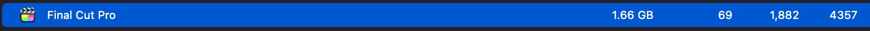

Just for fun, on my Mac with 128 GB of RAM that 138GB video file takes up 1.66 GB of RAM. Not maxing out my RAM even though the video is 138GB.

Then you don't require 128GB of RAM. Regardless this comment is irrelevant as this same file with the same application would utilize 1.66GB of RAM on an x64 system as well.
