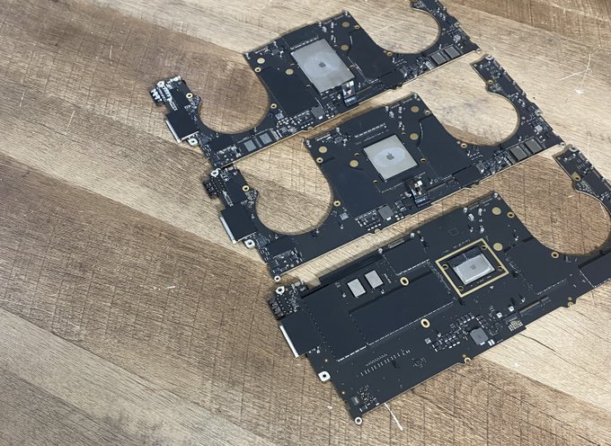

M3 Max
1TB = 1× 1TB (TLC)
2TB = 2× 1TB (TLC)
4TB = 2× 2TB (QLC)
8TB = 4× 2TB (QLC)
The ifixit teardown shows that Apple simply leaves some NAND spots on the logic board empty. This doesn’t change the fact that the cells in the NAND chips with the highest capacity wear out the fastest. The effect is only partially mitigated by a larger number of cells.

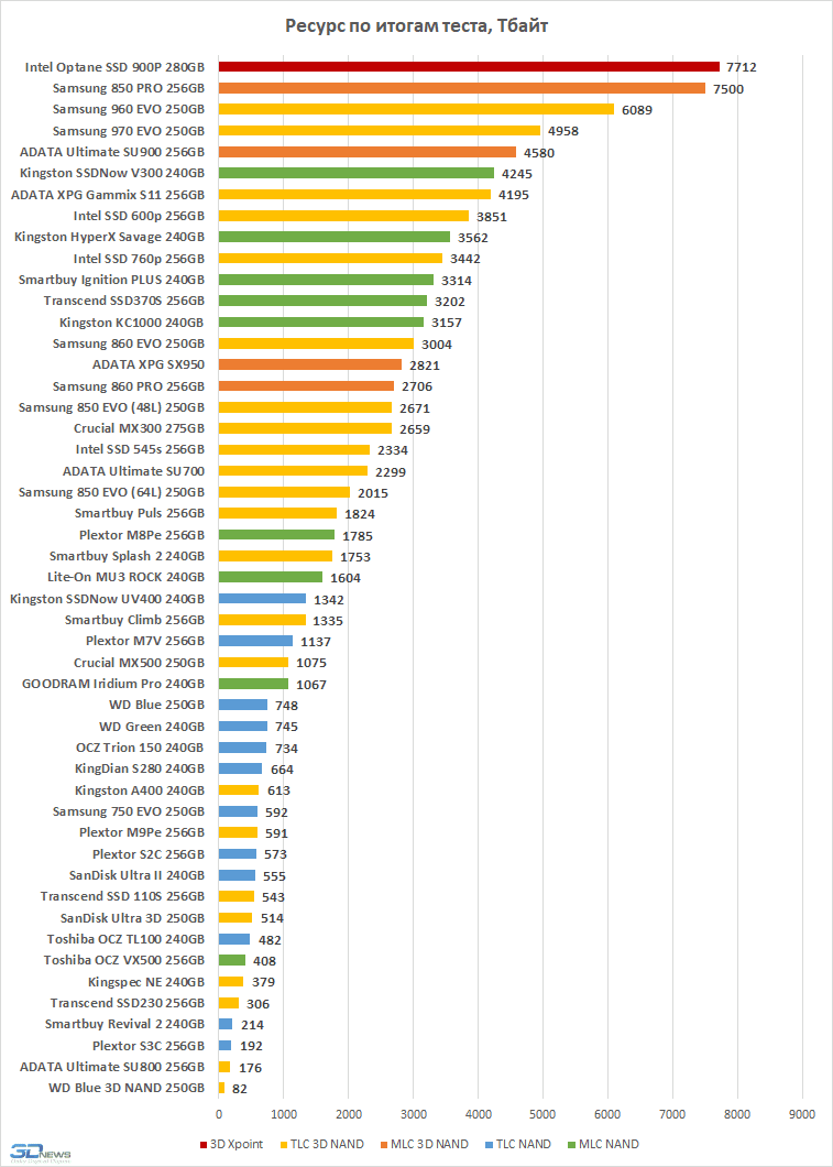

not making anything up , sure 150TBW is high end of spectrum but I hope apples using quality ssd. simple google search and 5. mins research and you can find info on ssd lifespans by their size.
150 TBW is the absolute guaranteed minimum for a cheap 250 GB SSD.
5 Petabyte or 5000 TBW is a high-end 250 GB SSD.
