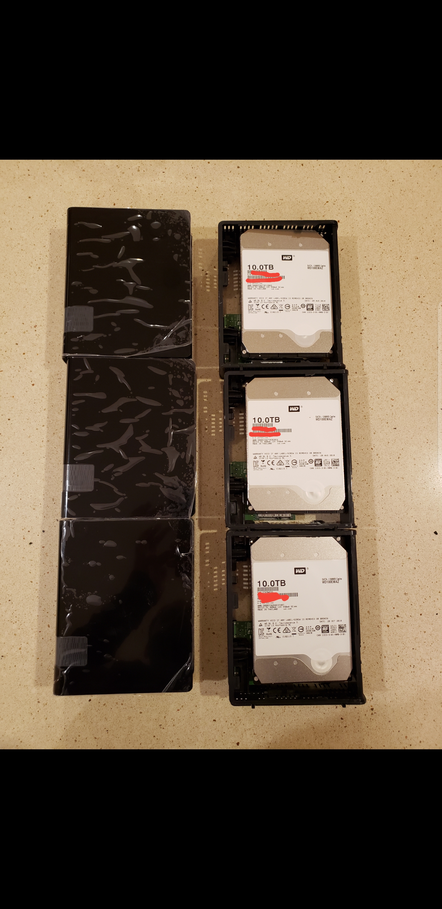

I used to plastic purple spudger to squeeze enough room between the gaps on both wide sides of the enclosure on the top to slide in those plastic sheets. This effectively unhooks the plastic hooks and keeps them from snapping. Next was unhooking the bottom and pushing the whole thing upwards so that the HDD slides out. I used the plastic spudger because that plastic is softer than the enclosure's; no damage whatsoever, not even a small scuff. If it's necessary, although perhaps a bit unethical, I will put the HDD back and send it off for warranty. No one can see that the disk has been out 🙂

What is really nice is that they are actually HGST enterprise helium filled drives. (Which you’ve noticed). I shucked 2 of them last year some time for use in my NAS.
WD80EZAZ (White label with metal strips) = US7SAL080 = Ultrastar He10-8 SATA

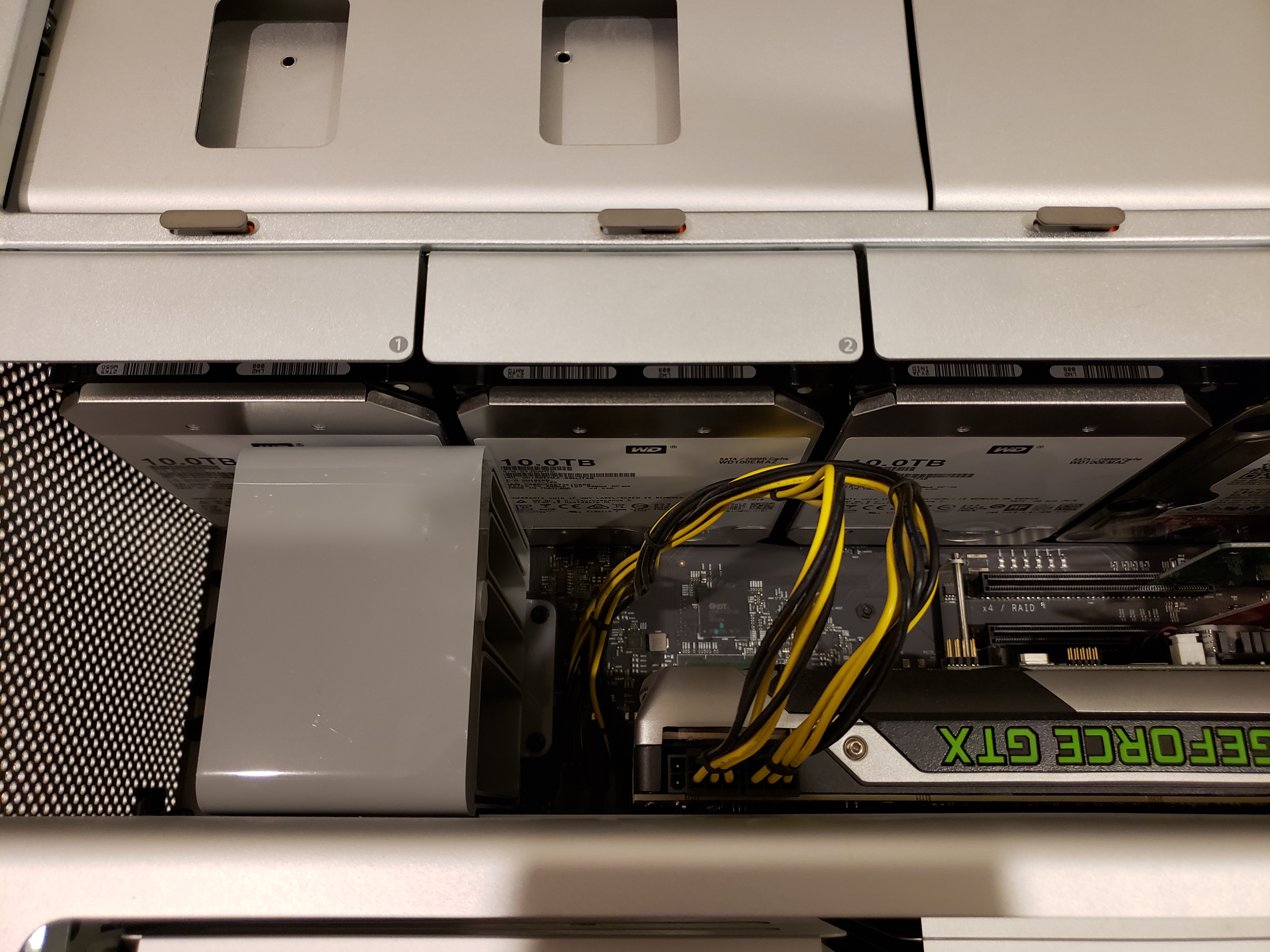

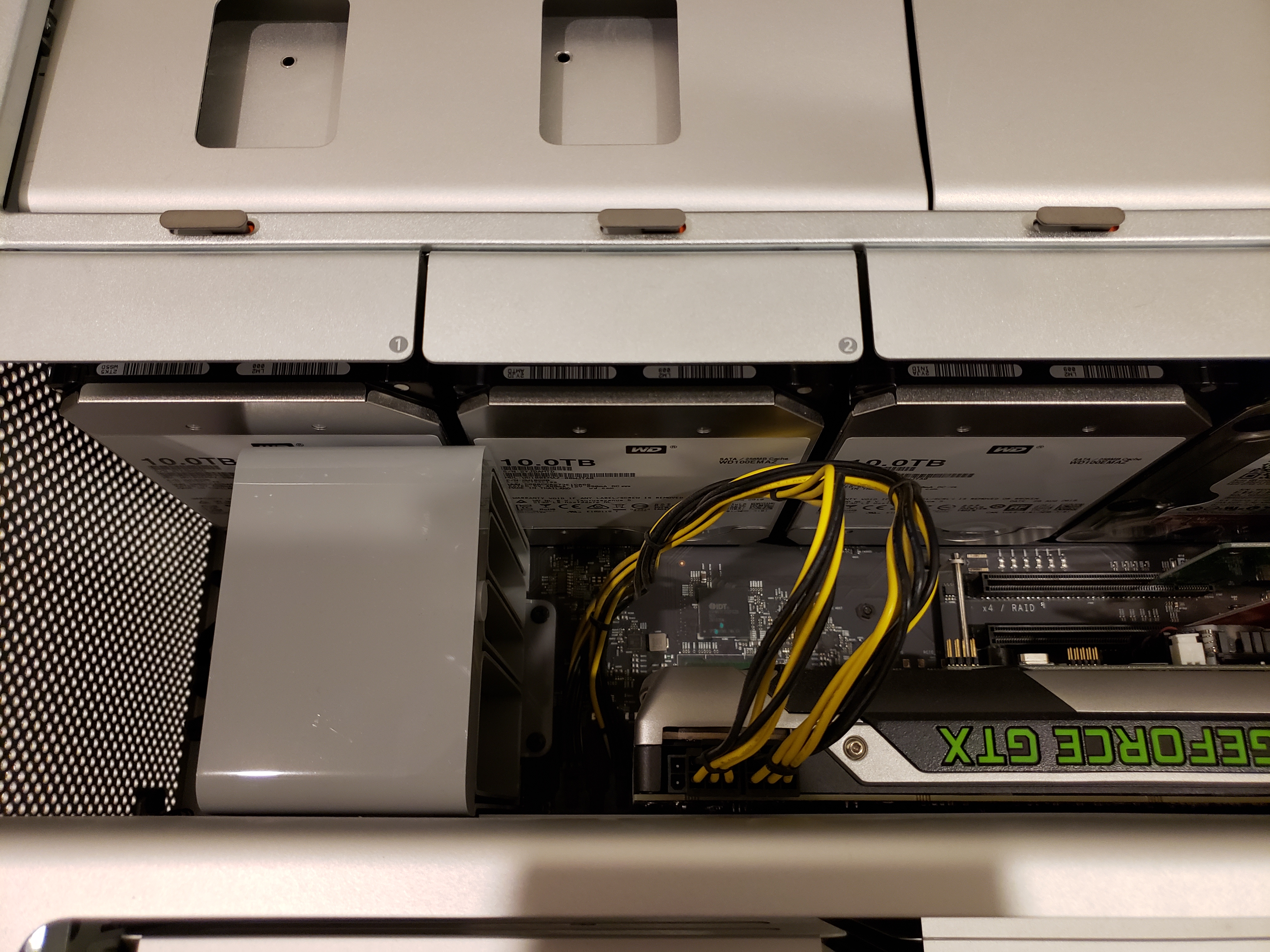

Drive 1 and 2 sit on the fan housing. For the third drive I rigged a piece of foam core to support it. I'll take a pic tomorrow
I see. I did that before, the only difference is I put a little piece of soft material between the HDD and the PCIe fan case as damper. And it should absorb some of the fan vibration. No sure if that help anything, but just feeling that let a HDD in touch with a constantly vibrating fan isn't a good idea.
Fan vibrations can cause HDDs to go unresponsive / take considerably longer to respond, in the enterprise storage business this would be called “drive stalls”

yeah, I too have seen this one. we noted certain RPMs from the 4U chassis would induce stalls in drives.
