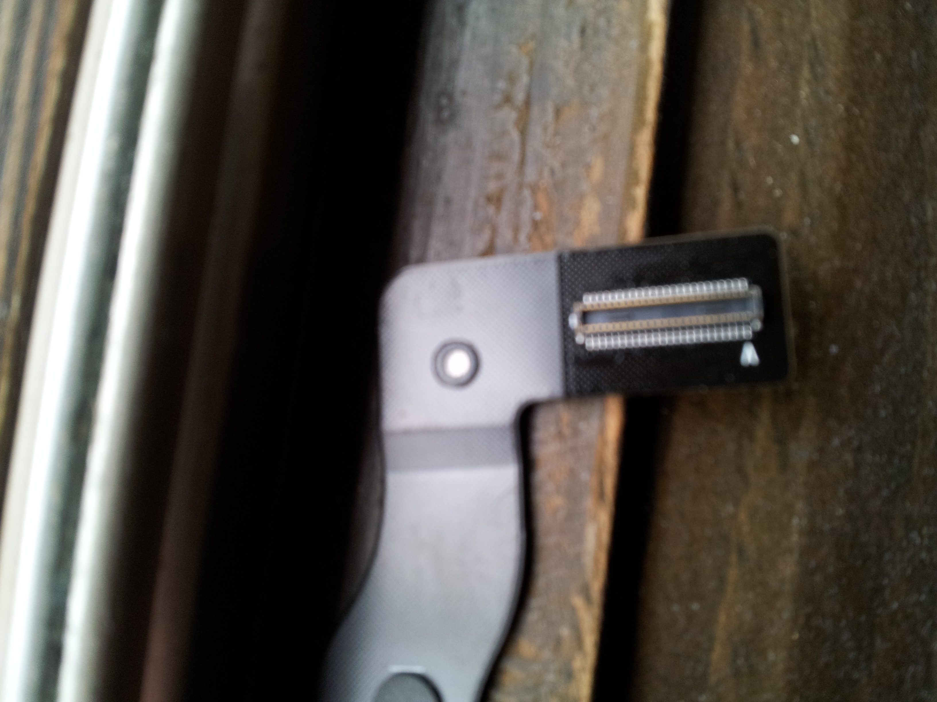

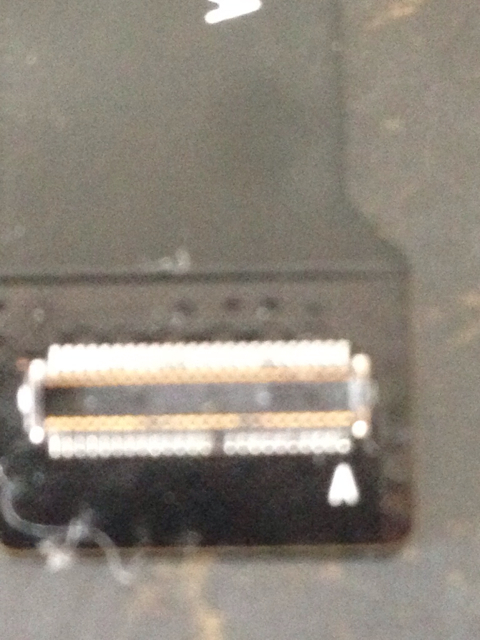

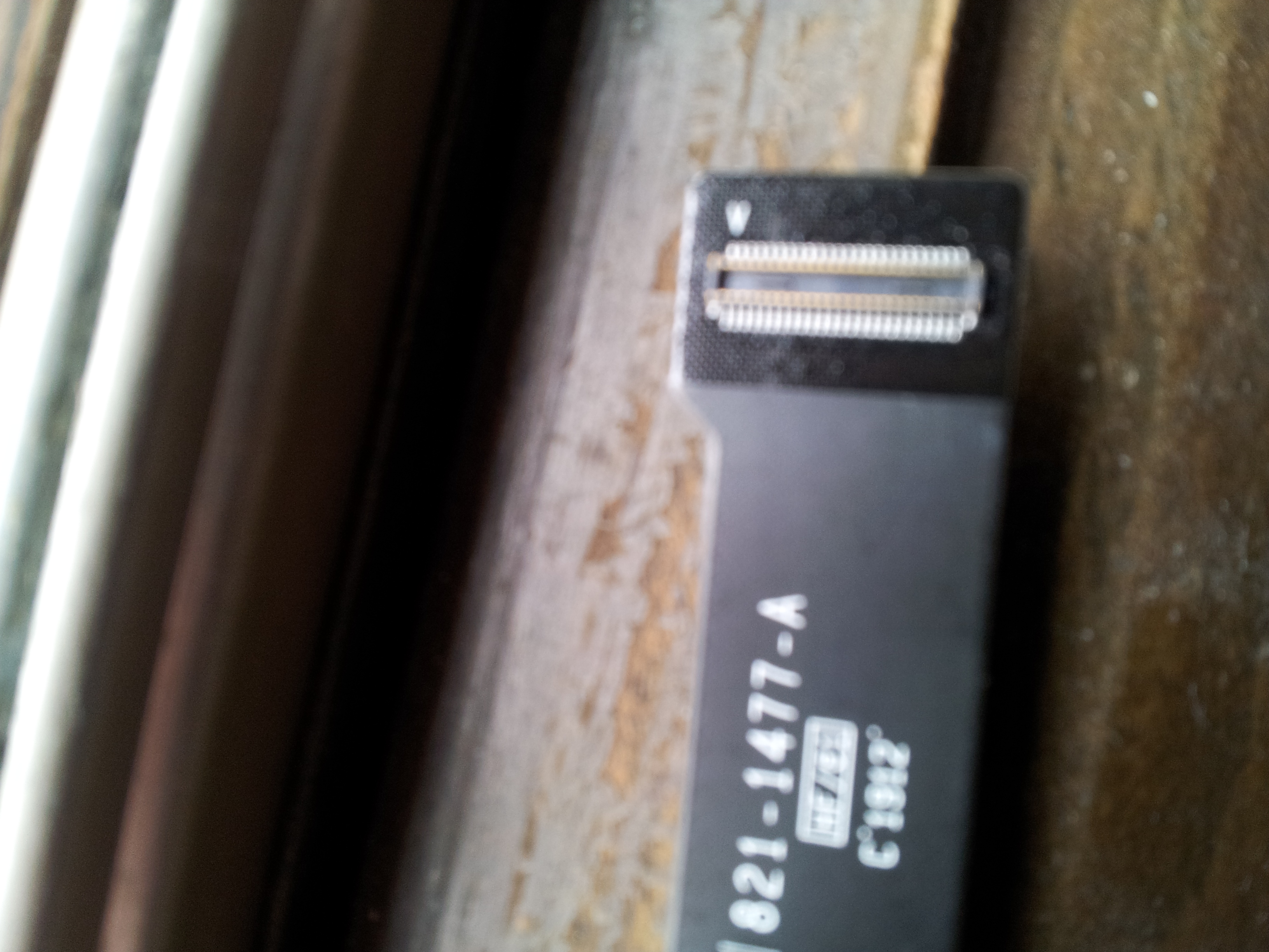

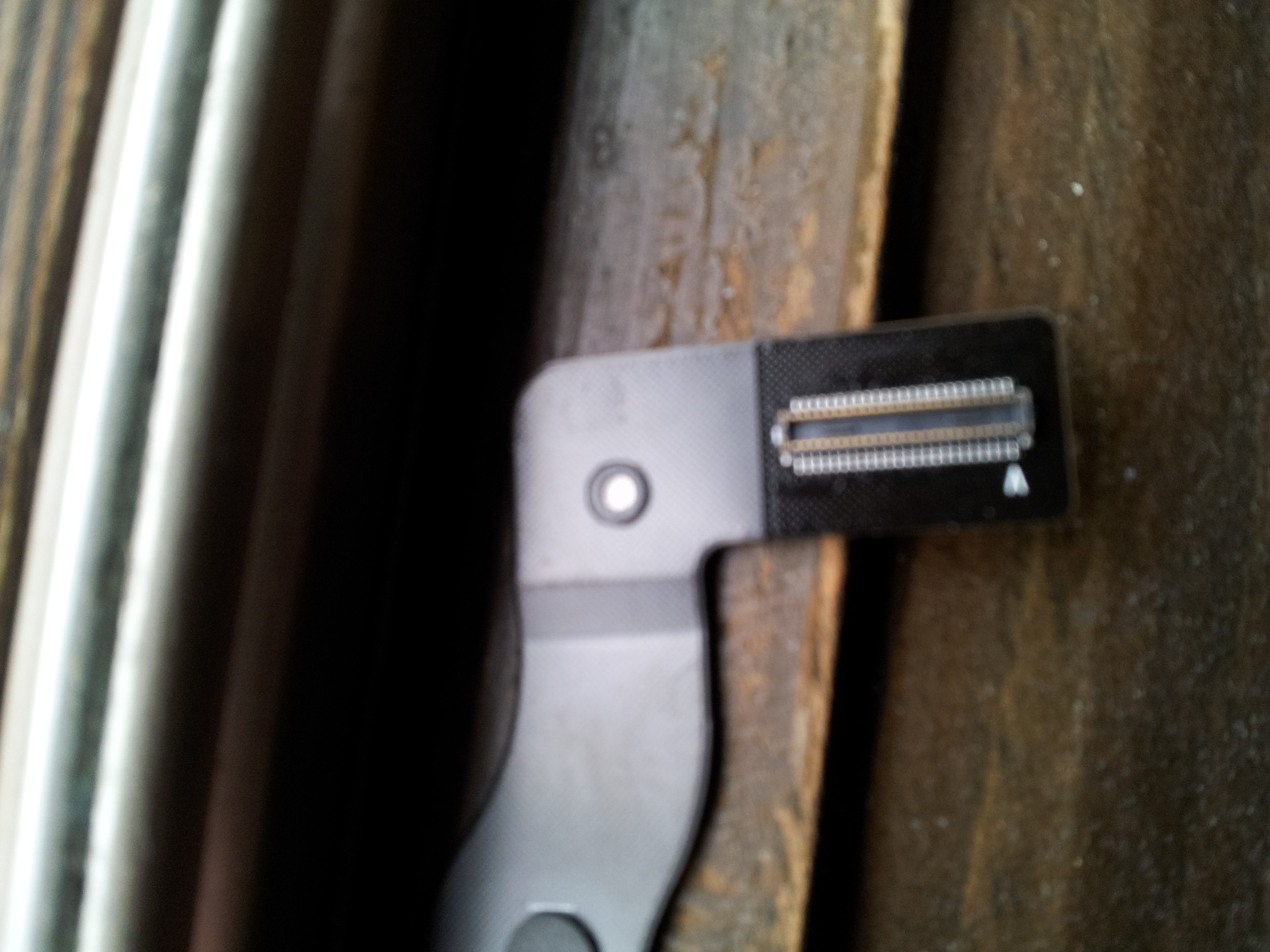

Hi I have checked all the cables from and two the magsafe board.
The main flat cable that runs from the magsafe Board to the logic board looks like it has a pin missing which might be the reason why it doesn't charge or it switches off when I connect power from the mains adaptor
If anyone can look at this picture and compare a working MacBook Air 2012 I would be very grateful
Many thanks
Ian

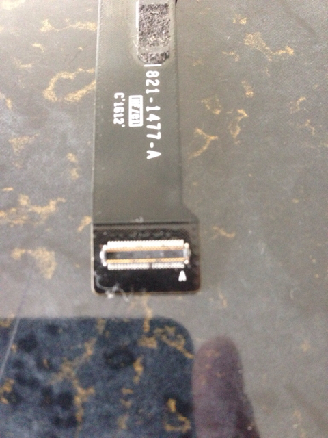

I have several Mid 2012 Magsafe i/o boards and cables.
None of them have a missing pin like yours pictured.
If the moisture sensor on the underside of the flat cable still white or is it now red?
Sorry about the poor pictures, low light and cell phone camera
To be on the safe side it may be best to purchase both the cable and board.
Many times on ebay that is the most cost effective way, then you are covered.
If it turns out you don't need the board, you will always be able to sell it.

Hi cyber16
Thanks for all the help and advice, mine doesn't seem to have either a white or red circle it's just black all over
I have pm Lucas to see if he can get me a cable or I will have to purchase one from the states.
