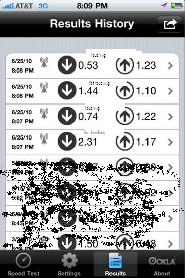

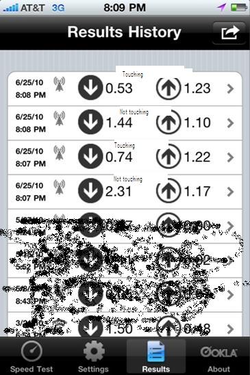

If you truly don't think you have the problem, please do me a favor. Download the "Speed Test" app and sit somewhere stationary to take a baseline reading.
Then, hold your finger across the strip like a described for about 10 seconds, then run the test again without moving your finger.
Now, remove your finger for 10 seconds and test again. Put the finger back on for 10 secs and test again.
Now you have 2 readings of each and can see if there is something going on.
Take a screenshot of your results and post it up here for all to see.

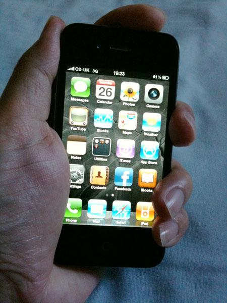

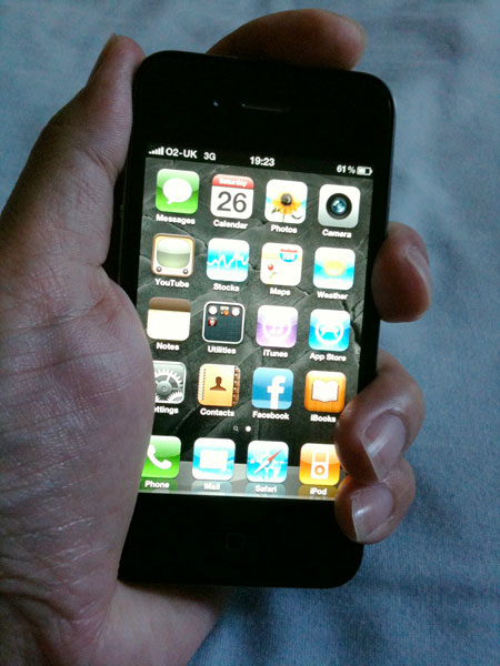

I went into the Apple store today and thought I may as well try out this signal problem on 3 of the 6 phones (people were using the others) and one on O2 dropped it's signal down to 1 bar, the other on 3 stayed on full bars and the other O2 phone dropped down to 3/4. :/

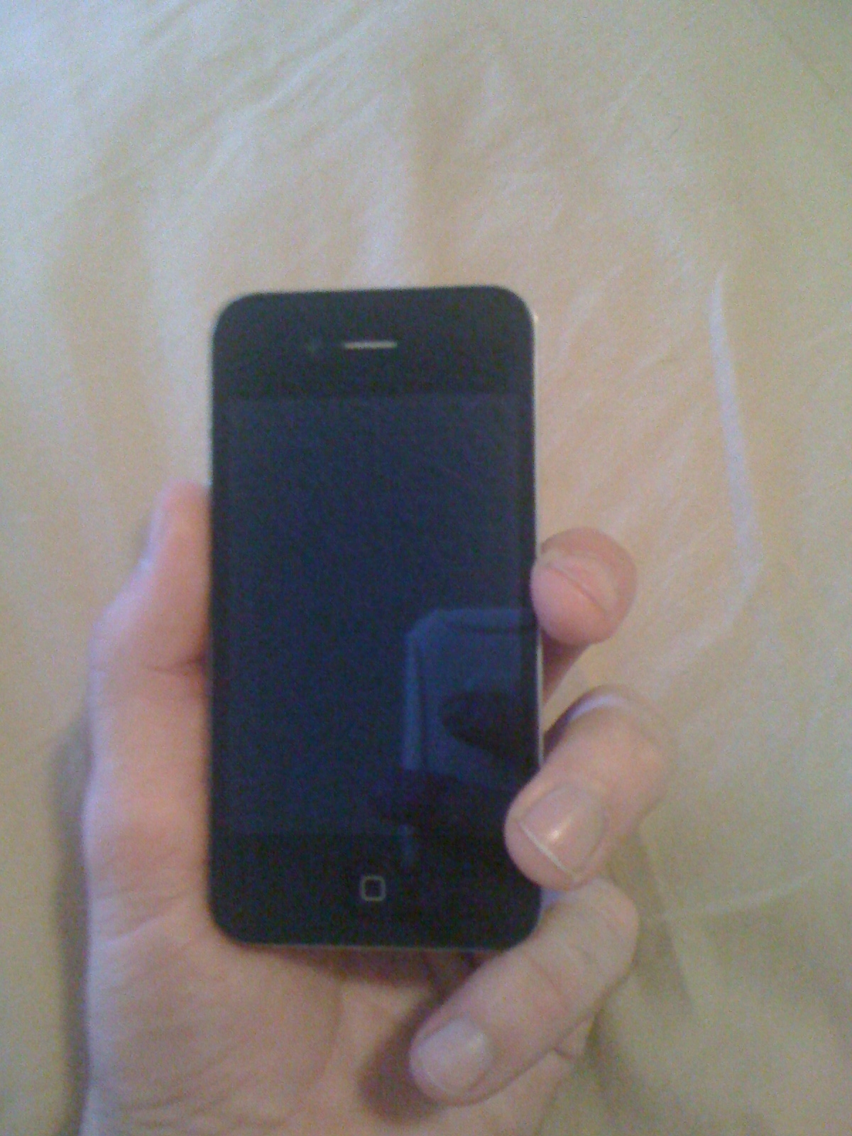

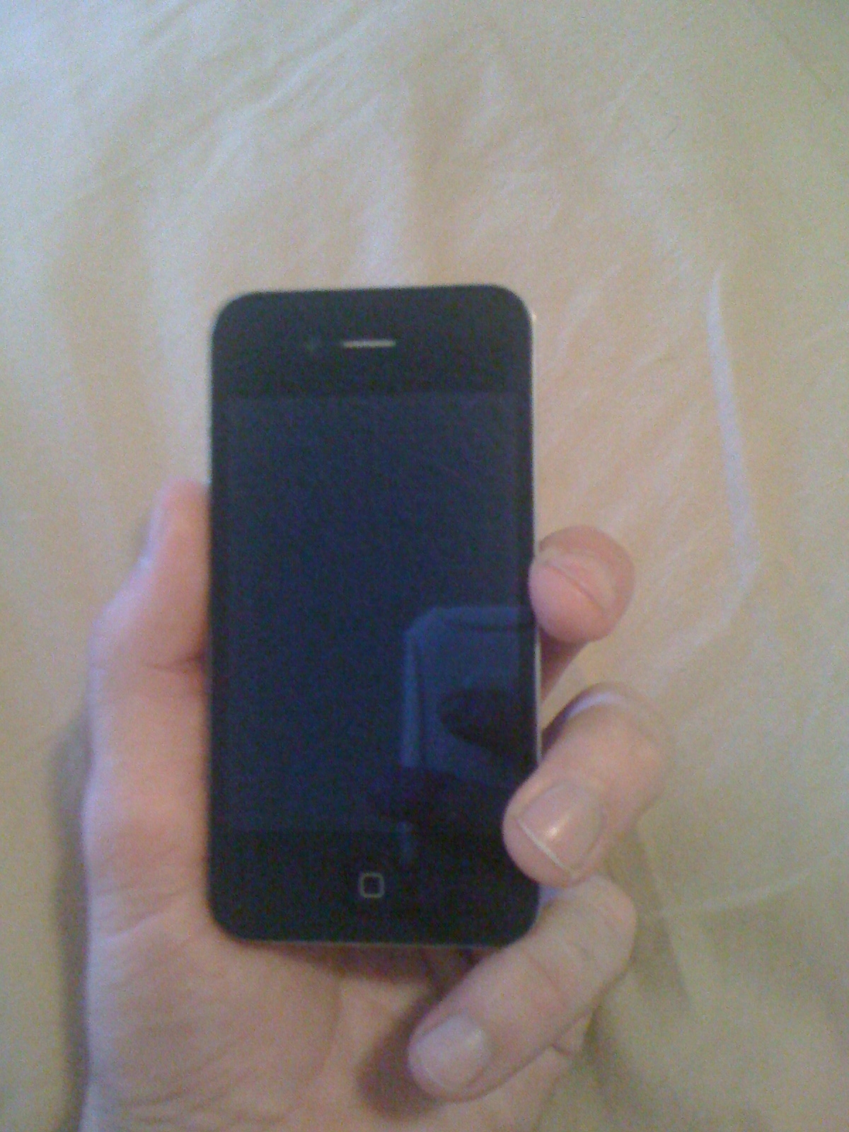

I hold my phone similar to how Peter does, but not as tight. Also, my palm does not go as far up the left side of the phone as his. I put my pinky on the bottom of the phone to the right of the dock to support the weight of the phone. The tip of my index fingers supports behind the screen just below the camera.
At one spot in town, I have full bars. When I hold the phone and contact across the strip, I still have full bars. But the Speed Test app shows that my download speed is cut in half.
WHEN I DID THIS TEST, I ALWAYS SHOWED FULL BARS, so you can see that the phone apparently does not require a very strong signal to display full bars.
The WEIRDNESS?? My upload was HIGHER when I touched the antennas.
Anyway, this pic is proof that you can show full bars and still be losing your signal.

It has nothing to do with iOS. The problem is a design oversight; the way some people naturally hold the phone causes their skin to bridge the two antennas. Apple should have put some kind of coating over the antennas or not butted them together right where people tend to grab the phone.
I just played around with it, and after holding the phone in completely-unnatural-to-me positions (in either hand), I can reproduce the problem.
But I don't hold my phone that way, anyway. Problem solved :D
