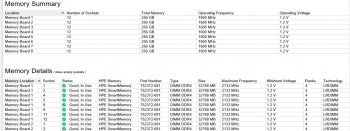

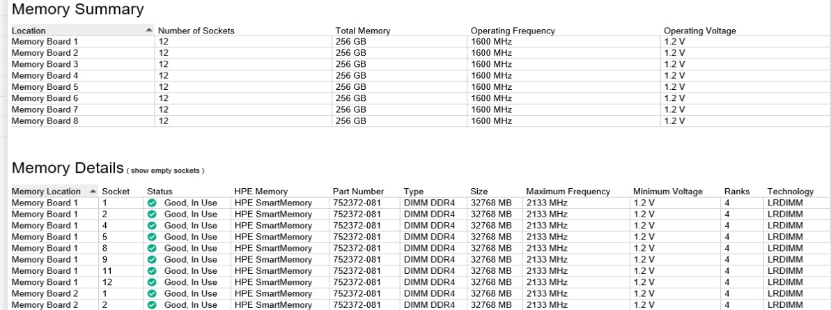

One of my servers with 2133 MHz memory DIMMs is running them downclocked to 1600 MHz because of the number of DIMMs installed. No way that I would cripple the system by removing DIMMs to get the clock speed up.
(Yes, 2 TiB of RAM.)
