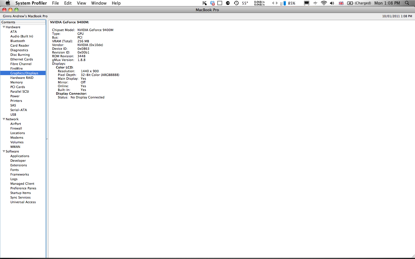

Hey first post 🙂. My macbook pro 15" wouldn't turn on a couple of days ago but yesterday i turned it on and everything seemed to work. Then i realised that the iSight and bluetooth weren't working. Apart from that it was fine. I then decided i wanted to use windows through bootcamp but when i tried to start it up it just black screened and didn't boot up. I then realised that it might be my graphics card so i went into system profiler and found this. I then tried both the PRAM reset and a SMC reset it didn't fix it. Is there anything else i can do? Or should i just take it to apple?

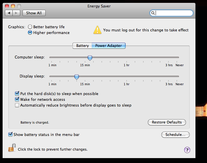

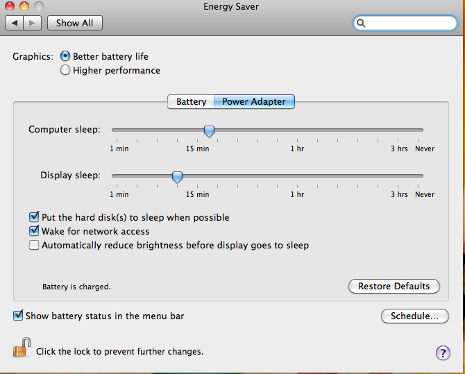

Hey thanks for the quick reply. Here are screenshots. The second one is after i choose high performance and log out.

Ok with "High Performance" selected (log out when prompted to do so), go back into System Profiler and see what it lists and post a screen shot.
It hasn't changed it keeps saying i need to log out for the changes to take affect.
