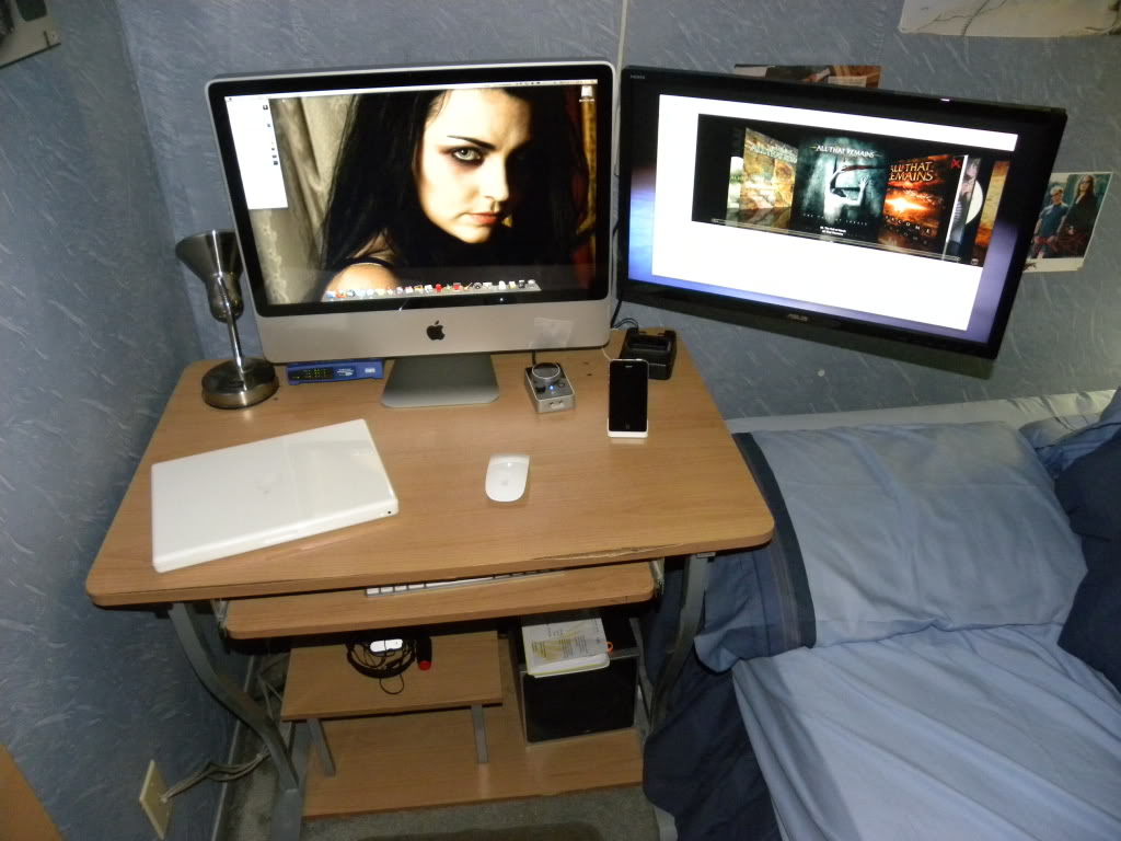

Thanks. I just finished setting it up...
Haha, thanks. I like it a lot. I just wish Apple sold low end budget monitors this way they could match. I just went with a cheap Asus 24" monitor (although, it does look smaller than my iMac, but I think the Asus is wider).
well its a mighty fine set up you have and the asus looks great
