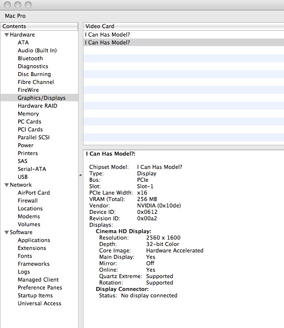

It came up fine but isn't id'd quite right.
It seems that a G70 based card is needed to make the magic happen....curious.

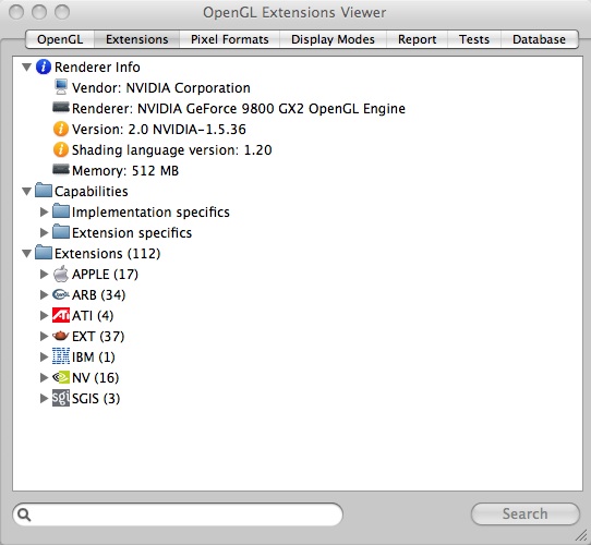

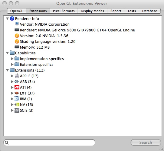

In any case, the 9800GTX was id'd correctly by OpenGl Viewer if not by system profiler. Running the Test function gave scores better than a 8800GT but lower than a 9800GT I have running at 700/1100.

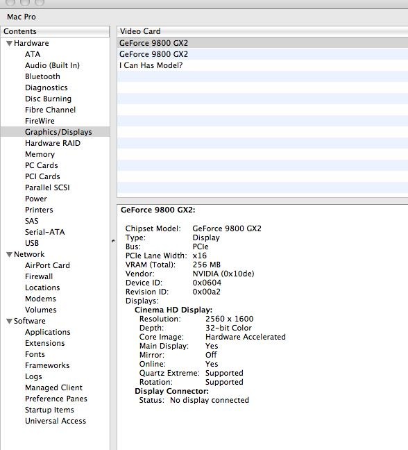

The GX2 was exciting but it is seen as two cards, not one. It's internal SLi via a bridge chip must not be functioning. Also, in WIndows it glows blue when it detects a monitor and it isn't doing that.
Again the OpenGl scores were a little better than a 8800GT but nothing tremendous.
