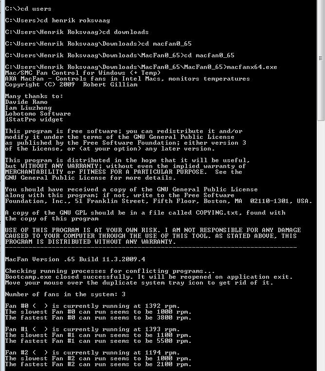

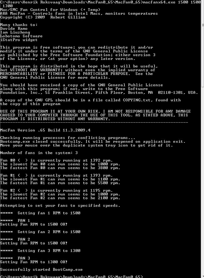

Macfan is CMD, so the files you downloaded wont do anything. You have to start cmd as admin, then navigate to the macfan folder using cd and cd.. commands.
When you are in the macfan folder, just type Macfanx64.exe and see the fans you have, and what they are running at, and what their minimum and maximum rpm is then change accordingly. To change the rpm, just type macfanx64.exe 2000 2000 1500. That sets fan 1 & 2 to 2000 rpm, and fan 3 to 1500rpm. See the pictures for better explanation
Great work with the games you tested, its really a big difference playing games with stock clock and OC clock. Nice to see crysis running great. And yes, im very picky about fps aswell, and i really do notice the 15+ fps boost it gives to starcraft 2 in large battles etc. its just great.
i think 750 / 1075 is the sweet spot. I think 800 / 1100 is easily achievable aswell. But then the fan needs to run higher and the imac becomes a bit noisy.
However we got to remember that this cards is made for laptops, and the imac has so much better cooling then a cramp laptop. So its much safer to overclock
Btw, anyone remember the name of the GPU stress testing tool, i can only remember prime, but thats for cpu.
