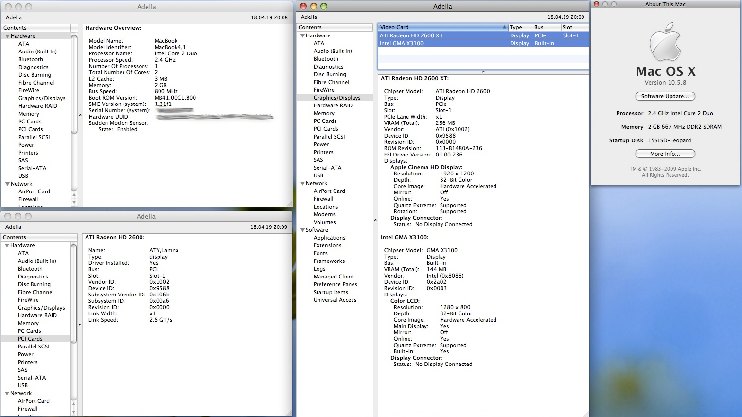

My copy of ATY_Init.kext [dated 2009-05-26] doesn't load in Tiger.
http://netkas.org/?p=56 has a working link to a Natit.kext dated 2008-02-23 so I gave that a try. The kernel messages are slightly different:
Code:
Alkor: Setting ATY,MemVendorID=<data not shown>
Alkor: Setting device_type=ATY,LamnaParent
Alkor: Setting AAPL,backlight-control=<data not shown>
Alkor: Setting ATY,MCLK=<data not shown>
Alkor: Setting @0,AAPL,boot-display=<data not shown>
Alkor: Setting @0,compatible=ATY,Lamna
Alkor: Setting @0,ATY,EFIDisplay=TMDSA
Alkor: Setting @1,display-type=NONE
Alkor: Setting AAPL00,blackscreen-preferences=<data not shown>
Alkor: Setting @0,display-connect-flags=<data not shown>
Alkor: Setting @0,display-type=LCD
Alkor: Setting ATY,PCIConfigSpace=<data not shown>
Alkor: Setting model=ATI Radeon HD 2600
Alkor: Setting ATY,MRT=
Alkor: Setting ATY,EFIDriverType=<data not shown>
Alkor: Setting AAPL,aux-power-connected=<data not shown>
Alkor: Setting ATY,HWGPIO=<data not shown>
Alkor: Setting ATY,EFIVersionBios=113-B14801-023
found bios dump, setting ATY,bin_image
Alkor: Setting ATY,DeviceID=0x9588
ATY,Lamna: Not usable
but the result and System Profiler output is the same.
I then extracted the iMac Software Update 1.2.1 and manually replaced the following files in /System/Library/Extensions with the newer ones [dated 2007-11-05] contained in the update.
  • AppleVADriver.bundle
  • ATINDRV.kext
  • ATIRadeonX2000.kext
  • ATIRadeonX2000GA.plugin
  • ATIRadeonX2000GLDriver.bundle
  • ATIRadeonX2000VADriver.bundle
(The reason I didn't just install it is that would have replaced files in other folders as well which were already there and newer as the update predates 10.4.11, so I'd probably have had to reapply the 10.4.11 combo updater afterwards.)
The result is still the same in System Profiler; nothing on either output. I'll try a DVI-to-VGA adapter with a VGA display next.

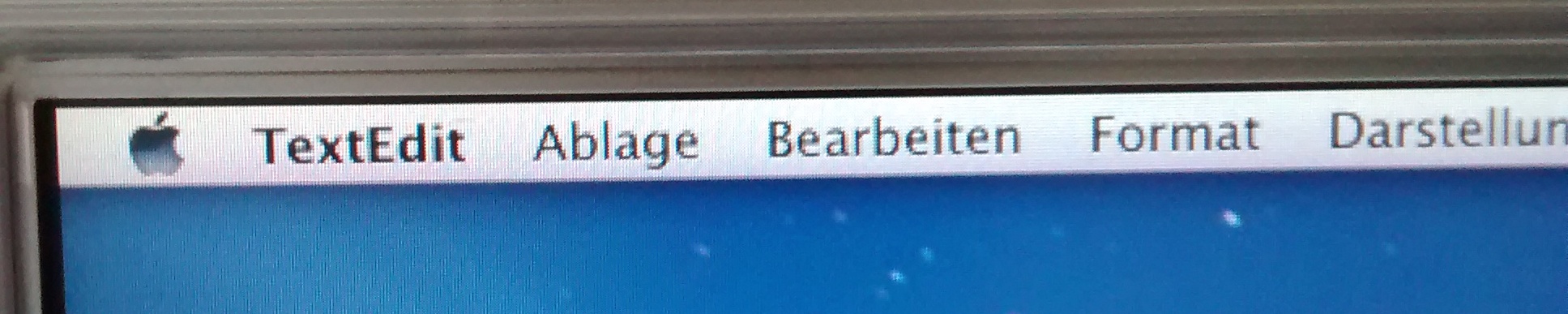

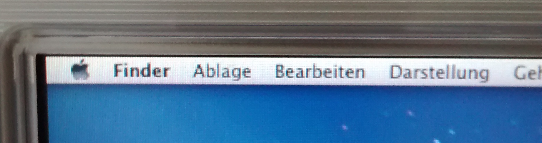

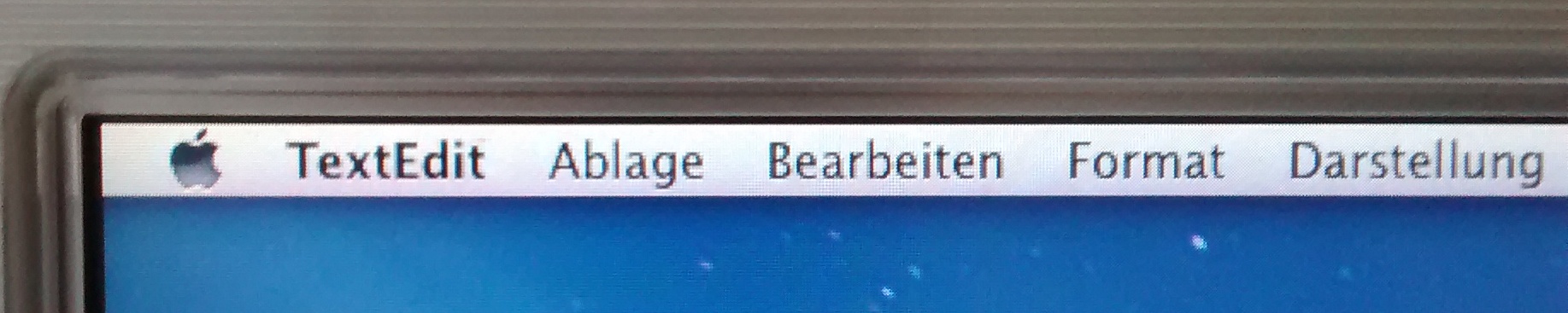

[doublepost=1556195485][/doublepost]Took a couple of close-up pictures in an attempt to illustrate the subtle difference between "normal" 1920×1200 and HiDPI 1920×1200 on the ACD.
Normal:
HiDPI:
On a funny note, it is also possible to use higher-than-native "normal" resolutions which are scaled down to 1920×1200. At 2560×1600, larger fonts are still somewhat readable yet visibly blurry but smaller fonts become almost unreadable so it's not really feasible. 🙂
Close-up at 2560×1600:

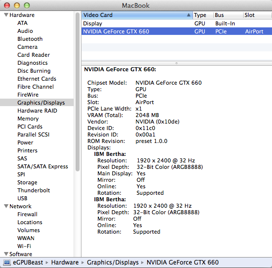

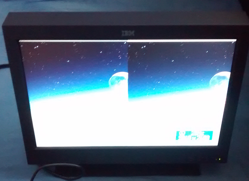

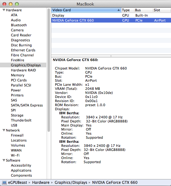

Finally got my hands on the legendary IBM "[Big] Bertha" T221. 😀
22.2 inches, 3840 × 2400 = 9,216,000 pixels, 204 ppi, 48 Hz using 4× single-link DVI, produced from 2001 (including earlier revisions) to 2005.

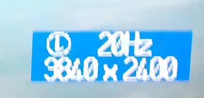

First test using one DVI link - 17 Hz is the maximum attainable at 165 MHz pixel clock.
The nice thing about running Bertha like that is that Mavericks automatically offers HiDPI modes larger than the "optimum" 1920×1200, and her being a 16:10 panel means I get proper 2048×1280, 2304×1440, 2560×1600, 2880×1800, 3008×1880 and 3200×2000 😀

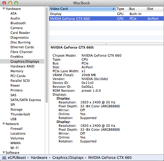

Adding a second DVI enables 20 Hz by default; 32.6 Hz is the maximum attainable given pixel clock constraints so I'll have a go at squeezing a little more out of the setup shortly.
When using two links, Bertha obviously appears as two separate 1920×2400 tiles, with the only HiDPI mode exposed being 960×1200 per tile.

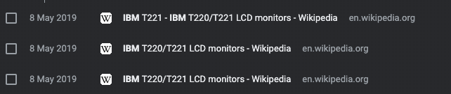

and also what are the chances of that as I was just reading up on that LCD monitor the other day! and I was wondering what could be done with one with todays tech
which version did you get? supposedly there where a few revisions + a Box that let you feed in a dual link DVI signal or 2 rather then having to be stuck with single link DVI signals 🙂
Reactions: Amethyst1
thats awesome 🙂
Cool coincidence! 🙂 I've wanted one of those for many years, pretty much since having heard about them for the first time.

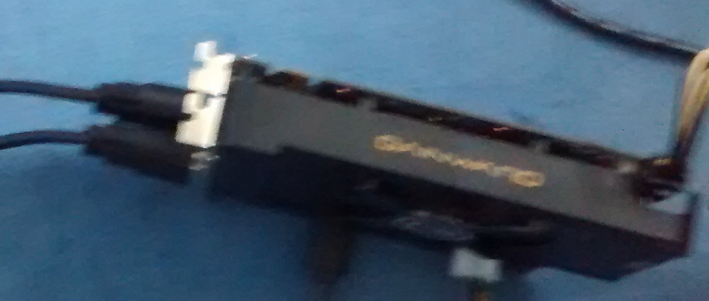

Alternatives I've been thinking about are using a Matrox DualHead2Go which takes one DP as input and splits it across 2× SL-DVI but the question is would it be able to handle that resolution (3840×1200 is the highest supported); another way that would not work for Mac OS X (and is thus irrelevant to me) is a DP 1.2 MST hub/splitter.
Reactions: LightBulbFun
32 Hz using two DVIs 🙂
While this works fine in Mavericks, Yosemite doesn't play along well with the 2× 1920×2400@20/32Hz or 3840×2400@13/17Hz settings (it's the same with or without HiDPI) - the UI is extremely slow with constant BBODs; bringing up the desktop's context menu takes several seconds and launching System Preferences takes longer than a minute. Dropping down to 1920×1200@48Hz makes things return to normal - as a test, I ran the left tile at 1920×1200@48Hz and the right tile at 1920×2400@32Hz: the UI was normal on the left and slow as **** on the right.

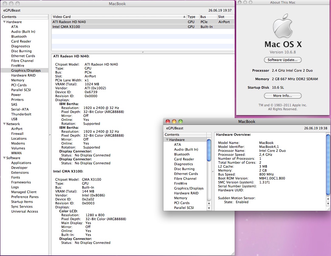

Finally got round to playing with it 😀
As to the name: Lion, Mavericks and Yosemite display "AMD Radeon HD 6xxx" instead.
The card has two DVIs, one DisplayPort and one HDMI - as it supports two non-DP streams, only three of these can be used simultaneously. Attempting to drive three streams at 1280×2400 (two via DVI, one via an active DP-to-DVI converter because the third must be native DP) results in distortion. It should be noted that I used my older T221 DG3 for the test as my newer DGP - which is more flexible in terms of what signal/input configurations it accepts, so might play ball with 3× 1280×2400 - is tied up for another experiment right now.
I then tried running three 960×2400 streams off the 6850 and the fourth off the X3100 but that failed as the X3100 didn't even recognise something was plugged into it. 😛
Interestingly, this issue is not present with the 6850; Yosemite's UI is fine.
