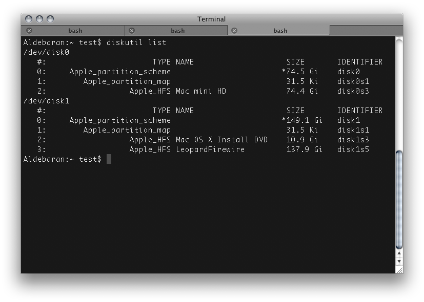

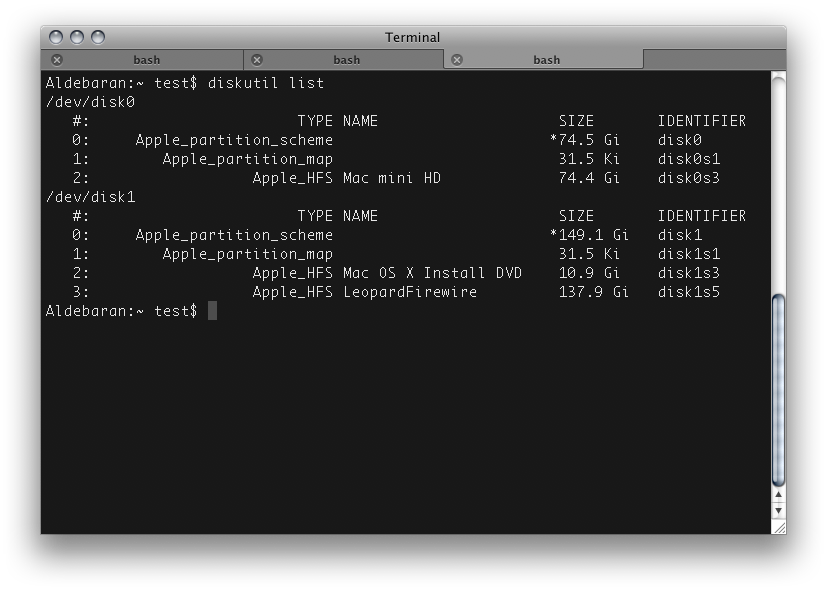

I can try if you provide more information but it's not going to be easy. Search for Terminal in Spotlight. Launch it and paste or type the following line into the Terminal window with your two drives connected to your Mac and press enter :
Code:
diskutil list
The command should return some output like in the example attached tumbnail. Make a screenshot of the Terminal window and attach it to your reply. Provide more information as to which volume you would like to mount or unmount. Also attach your Automator app to your reply but save it first as a workflow.

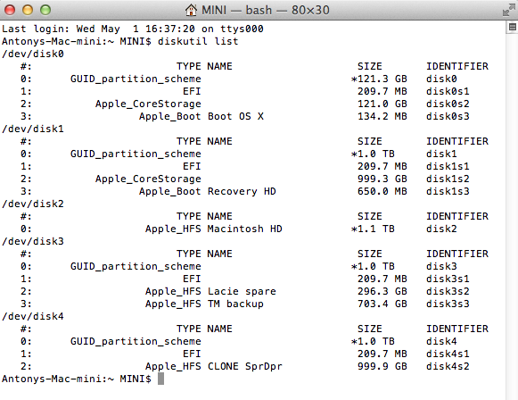

Kryten, much appreciated. There's a screenshot below of the Terminal window as instructed.
The volume I want to mount and to eject is "CLONE SprDpr".

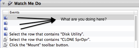

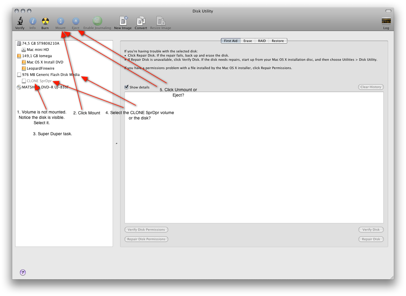

Did you run the script? Does it do what your Calendar event does? Did you look at the screenrecordings? Trust me it will not blow up your Mac it will only try to mount/unmount your "CLONE SprDpr" volume. If it`s ejecting that you want the script can be modified. Post a screenshot of Disk Utility with a numbered sequence of arrows.
  1. Select the "CLONE SprDpr" volume
  2. Click mount
  3. Do my Super Duper thing
  4. Select my "CLONE SprDpr" volume or the disk it resides on
  5. Click Unmount or Eject. There is a difference in result.
  2. Click mount

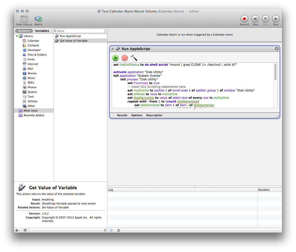

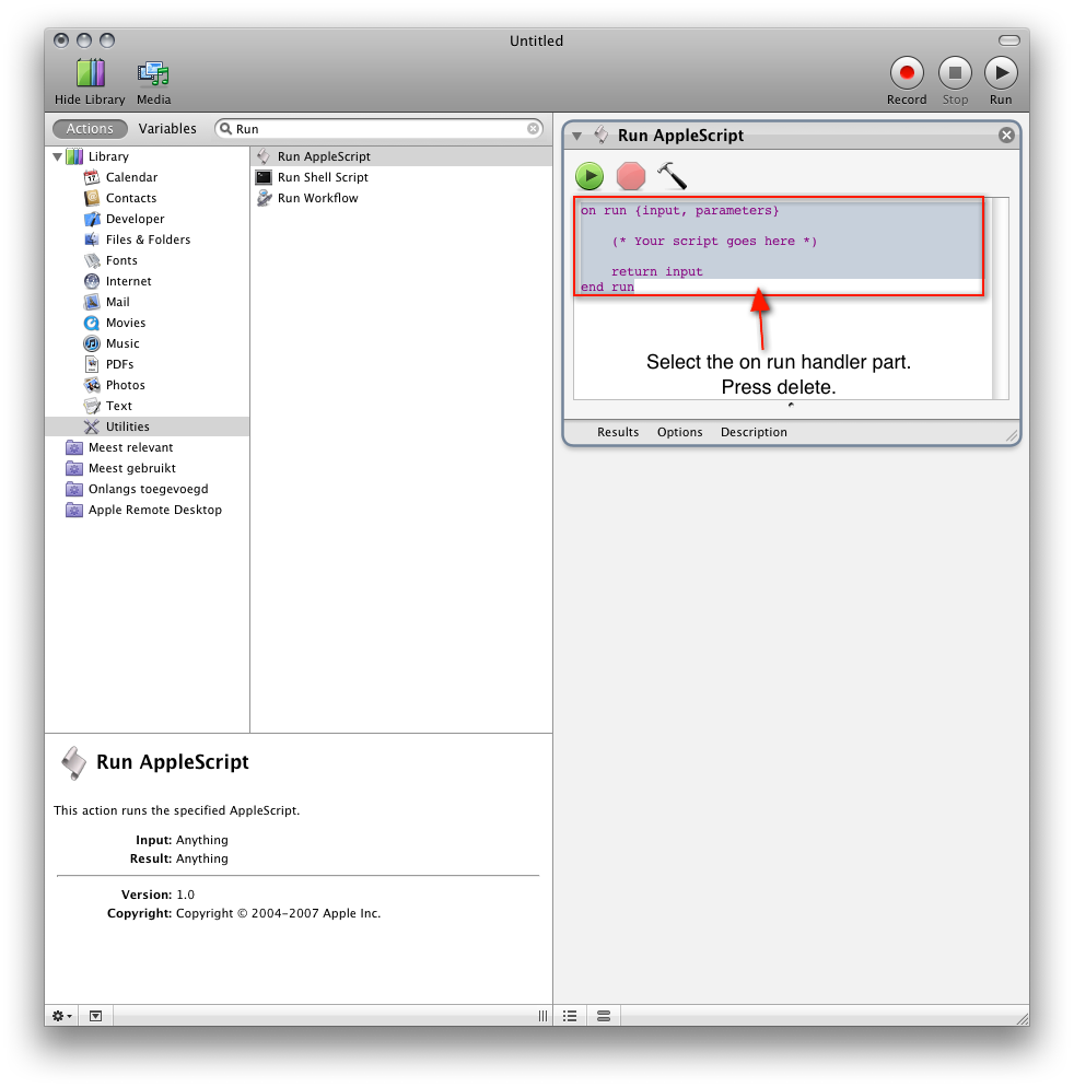

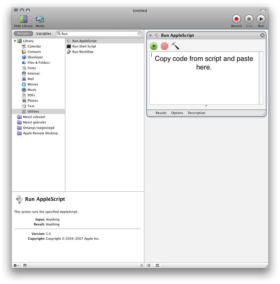

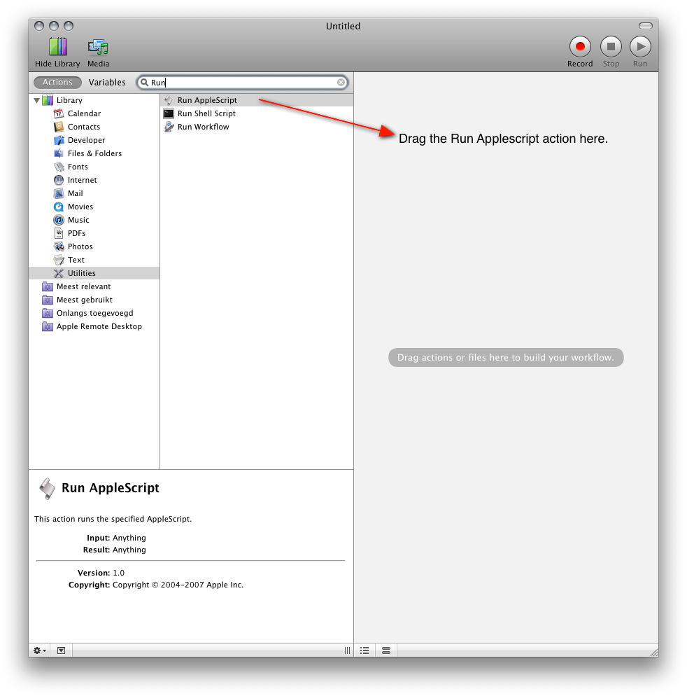

Edit : In Automator make a new Calendar Alarm with a Run Applescript action. Remove the on run handler part and copy the code from the script into the Run Applescript action. See attached tumbnail.

Thanks Kryten. I've run the script again and it does indeed eject as well. Perfect.
I'm not quite with you on creating the Run Applescript action. Not sure what you mean by "remove the on run handler part".

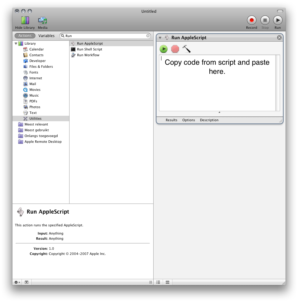

Example :
