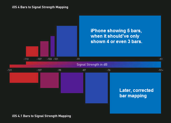

Yes, in 2010 AT&T was overloaded. Especially since they had wasted so much time bolstering their 2G network to help speed up the original 2G iPhone in 2007, instead of investing in their 3G network... the one that every other smartphone used.
And yes, there was a major flaw in the initial cellular code for the 3GS, that caused iPhones to ramp up their power output (for no reason) until the cell tower would drop all other phones outside that power level. This caused lots of dropped calls until AT&T figured it out.
However, neither was a conspiracy.
--> Now, here's what almost certainly happened to you:
In 2010, while investigating the "you're holding it wrong" iPhone 4 antenna problem, Apple noticed that their signal level calculating code was incorrect. Not just by a little bit, but by a lot. As Apple themselves put it:
"Upon investigation, we were stunned to find that the formula we use to calculate how many bars of signal strength to display is totally wrong. Our formula, in many instances, mistakenly displays 2 more bars than it should for a given signal strength. " - Apple
So in mid-2010, Apple put out an OS update that displayed bars more like how other phones did. And that's why your bar count suddenly dropped. You're right, it was the result of an update. However, it did not cause signal problems. Instead it finally showed a more realistic signal level.

Wow, good graphic. That was way off. Another one in the plus column for numeric readout I guess. I just prefer them anyway. I know a -112 is at least marginally usable where -120 and below I'd think twice about even trying.

Signal strength bars aren't shown at standardized intervals.
Often true, but most phones (unless they're cheap ones trying to fool the user) do implement similar ranges. Especially if by the same maker, or if tested and sold within the same carrier network.
In fact, Apple chose to follow AT&T's standard:
"To fix this, we are adopting AT&T’s recently recommended formula for calculating how many bars to display for a given signal strength. The real signal strength remains the same, but the iPhone’s bars will report it far more accurately, providing users a much better indication of the reception they will get in a given area." - Apple, July 2010
