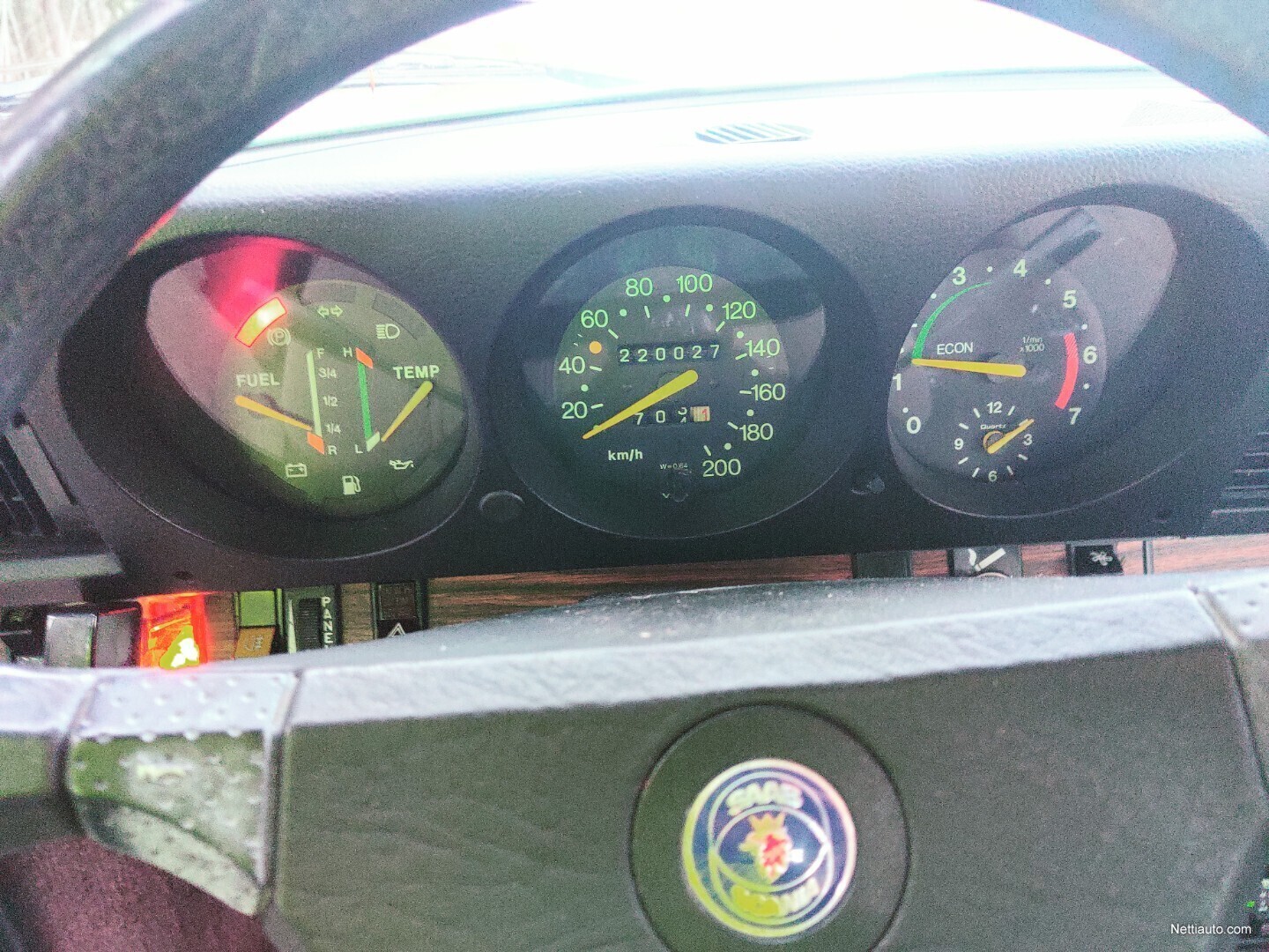

The auto industry, for awhile, took that cue from the AF and used red displays on their dashboards for awhile. Saab (who also tinkered with military jets) did not, and used white lettering on black backgrounds, very easy on the eyes (I'd been a Saaboholic since 1985).
Well, as a Saaboholic you should know that they have always used green backlight in their cars...
(1985 SAAB 90)
...contrary to their planes 🙂
