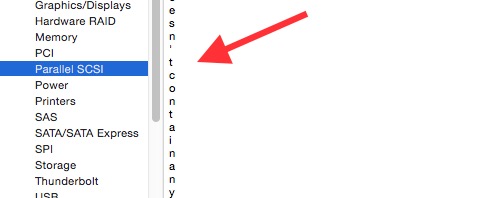

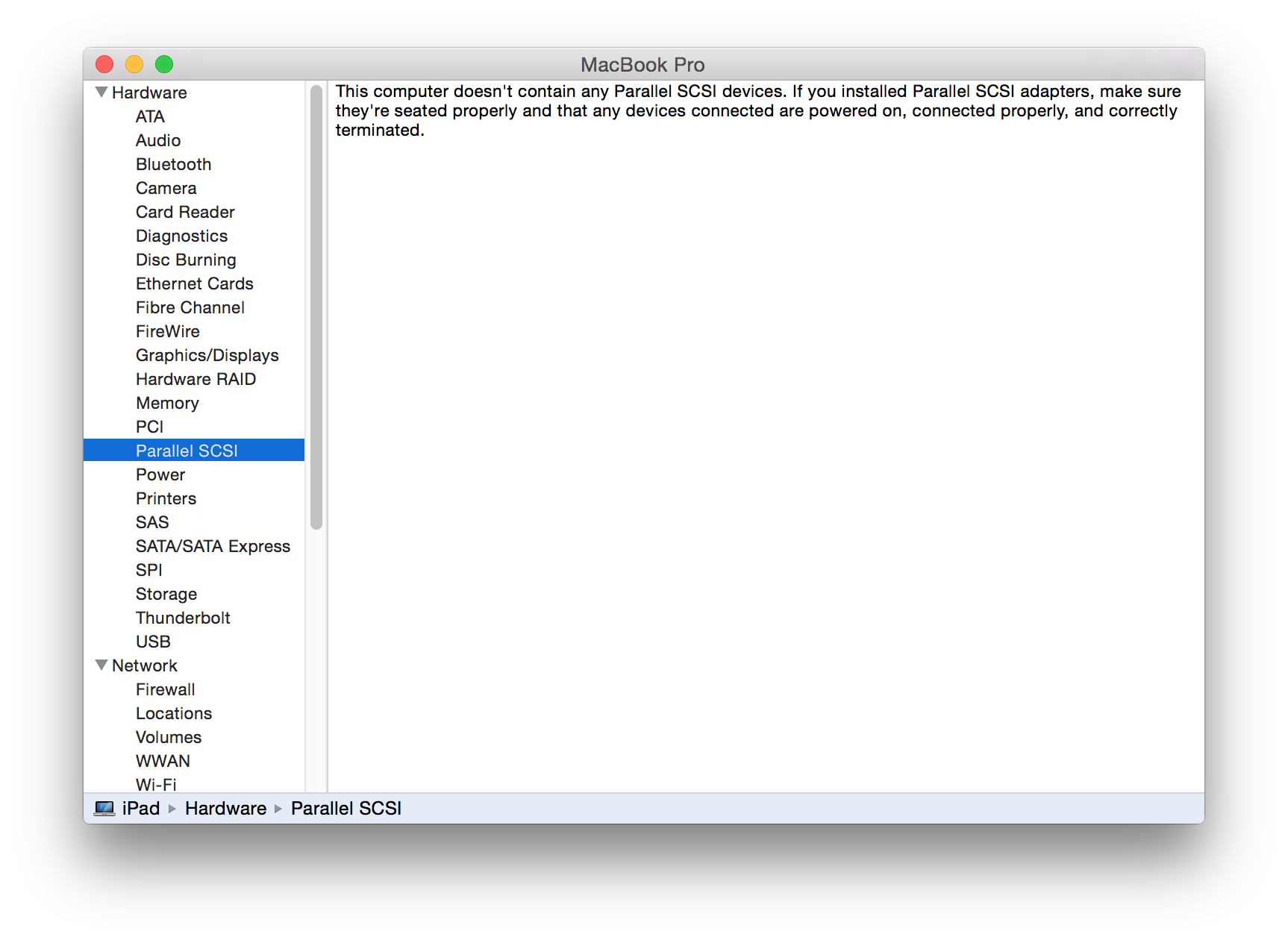

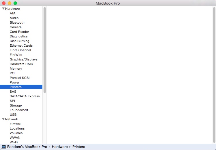

And a new one for me... System Information in Utilities (Not in About this Mac / System Report) ... Most of the right hand pane information is missing / blank... And when a specific is hit such as RAID, which my machine does not have... I get text which is downwards scrolled....??? Anyone else?

Bumping this to the top... The System Report issue seems odd to say the least... And no replies? Can a few of you try yours to see if you have the same?
My MBP15 is fine, but the MBP17 2009 5.2 does it...? This is the third clean install on the unit as well (due to a few stoopid mistakes I made).

Oddly it works if I go in via About this Mac...

Hi, for anyone that is interested or suffering the same issue... this is a bug and not a borked installation. I have found the conflict and surprisingly it is in System Preferences.
It is to do with the scroll bars.
If you have it set to Always on, as I do... It affects System Information pane and thus, renders it blank.
If you have scroll bars set to Automatically based.... System Information renders correctly. Displaying the system specifics.
Bug report and steps to reproduce filed with Apple. So if you have the same issue... It's quite easy to overcome, until a fix is issued in a future update.
