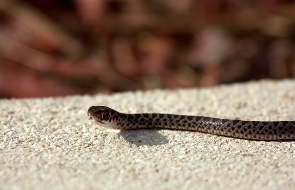

I like your pictures but have one comment:
Your picture of the snake has me a little worried that your copy of the lens might be front-focusing. You are obviously shooting it with a very small depth of field (likely f/5.6 at 400mm if I guess) and the snake's head was likely the target but his head is out of focus. Is this a new lens? I know you have a T2i so you can't do micro-lens adjustments. You might benefit to try to photograph a ruler and see if your lens is front-focusing. If so it will need to be sent to canon for adjustment. Sorry, just want to help you out as I have a very similar setup (XSi + 100-400L) and love the combo for my bird photos.

Will have to wait for an answer, but it's possible the the OP was using all the focus points instead of just one. For example, one can use one focus point to focus on the snake's head. Otherwise the lens will focus on the area that has the greatest contrast.

True, that may have been the case, and the picture is a good example of why you don't want to do that in this situation if that is the case.

I am not sure and now you have me worried. I am leaving Thursday for a trip to Yellowstone. I hope its ok 🙁 I am a camera noob really. This is my first and only real nice lens, and I have only had it for a week. It was shot at 5.6 I believe. Could it be I was just aiming wrong? I have it set on AI Focus I know that much.

It seems to be OK. The snake's head seems a little out of focus, but that could be because the lens focused on the area that offered the most contrast, which is normal. In other words, the center focus point was slightly below the snake's head, or that the snake moved it's head rapidly for a fraction of a second when the photo was being taken. The simple fact that all the other photos are in focus should tell you that your lens is fine. Look at the band that is in focus just by the snake's body (half-way down the snake's body). Also look at the part of the snake's body between this mid-point to the head, and notice how this area of the snake's body is farther back from the area in focus. The area that is in focus is the mid-body point of the snake, not its head.
