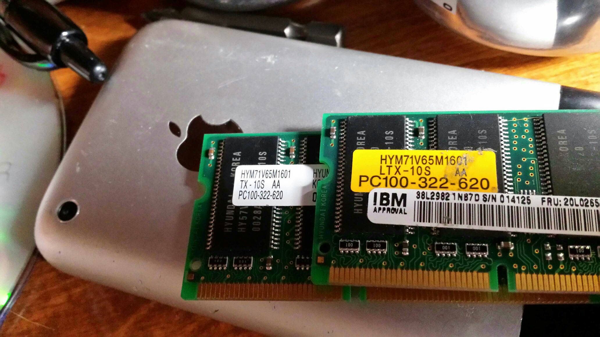

A few days ago I ordered(Should come tomorrow ) an iBook G3, which I am going to use a OS 9 laptop.
The iBook comes with its stock ram(128mb) so I was wondering if these sticks could be used.

Are those 144 pin SO-DIMMS? If they are, that RAM should work in an iBook G3, as all call for either PC-100 or PC66(using a higher speed is not a problem). With that said, you really should hunt down some 512mb sticks(PC100 or PC133 will be fine). I have it stuck in my head(from sorting obscene amounts of RAM) that PC100-322-620 is 128mb, although I may be wrong on this. You only have one slot to play with, so cram as much into that one slot as you can!

It'll be a bit before I can grab a 512mb stick.
And like you said, the sticks are 128mb.

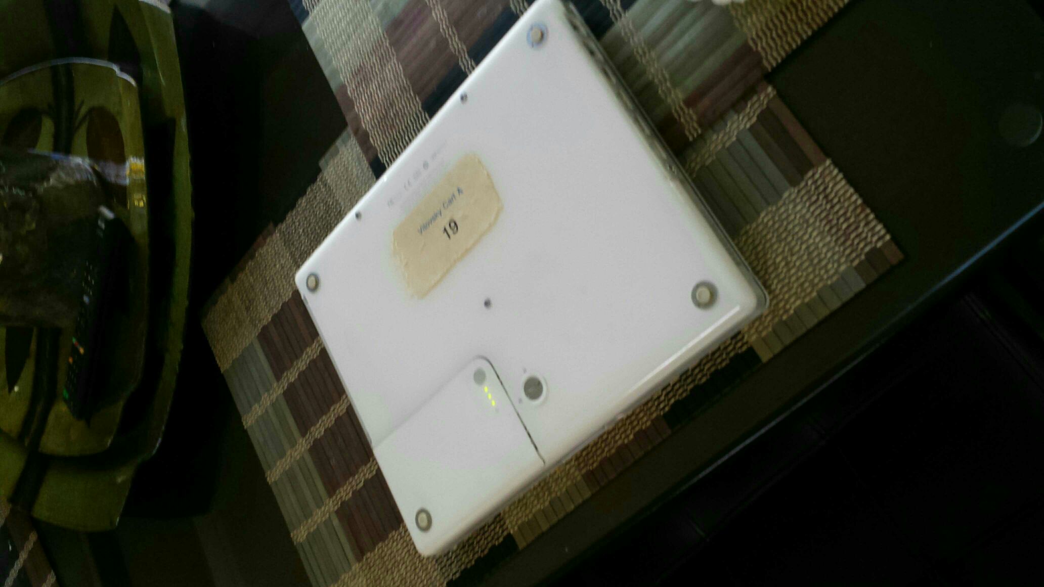

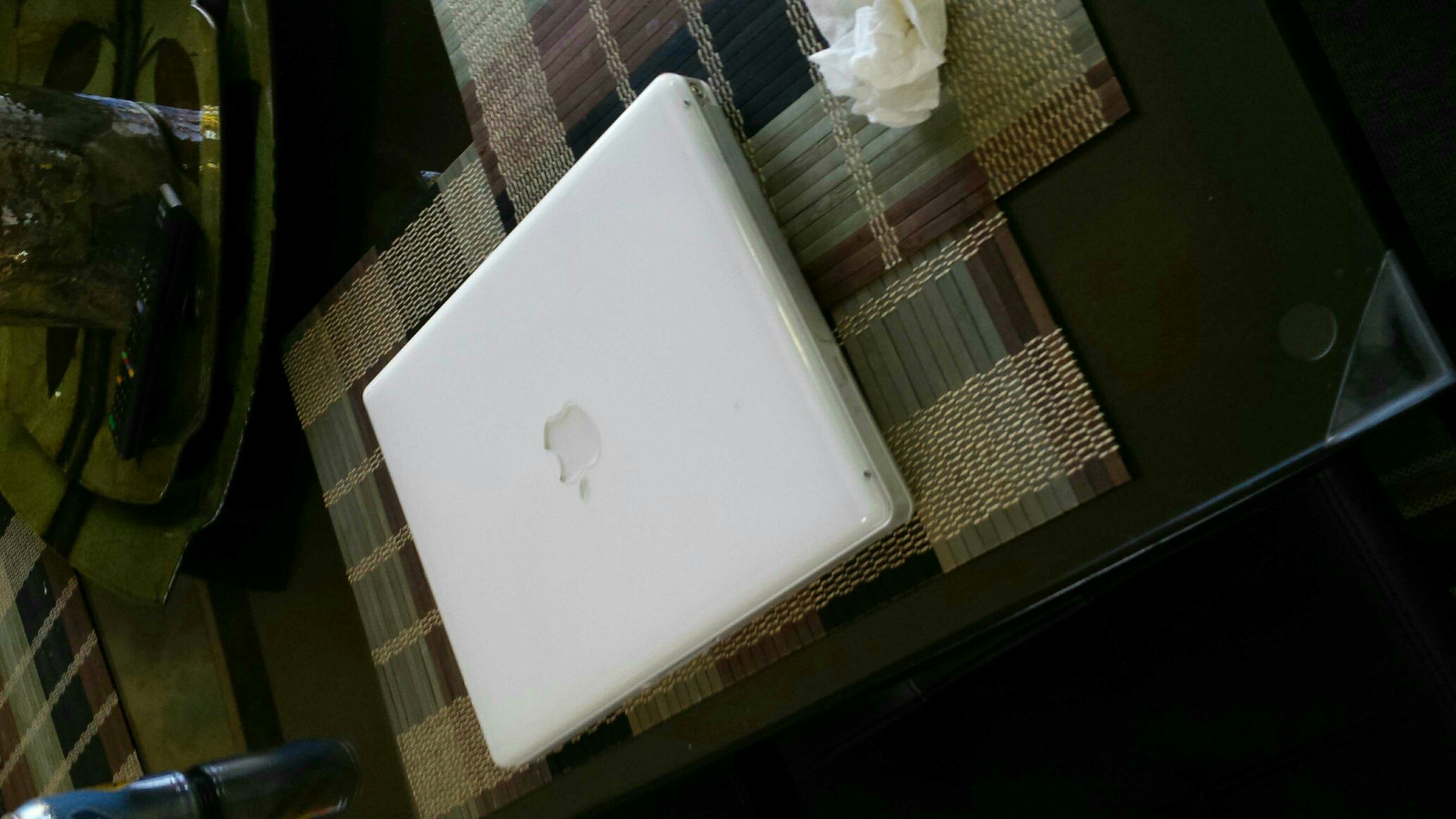

It's here! It's in great condition, this used to belong to a school and it turns out this has maxed ram (576mb). It also says 500mhz PowerPC G3(a bit misleading on the eBay page but I'll live with it.
Anyway here's some pics
I can't seem to get rid of that nasty sticker sadly.

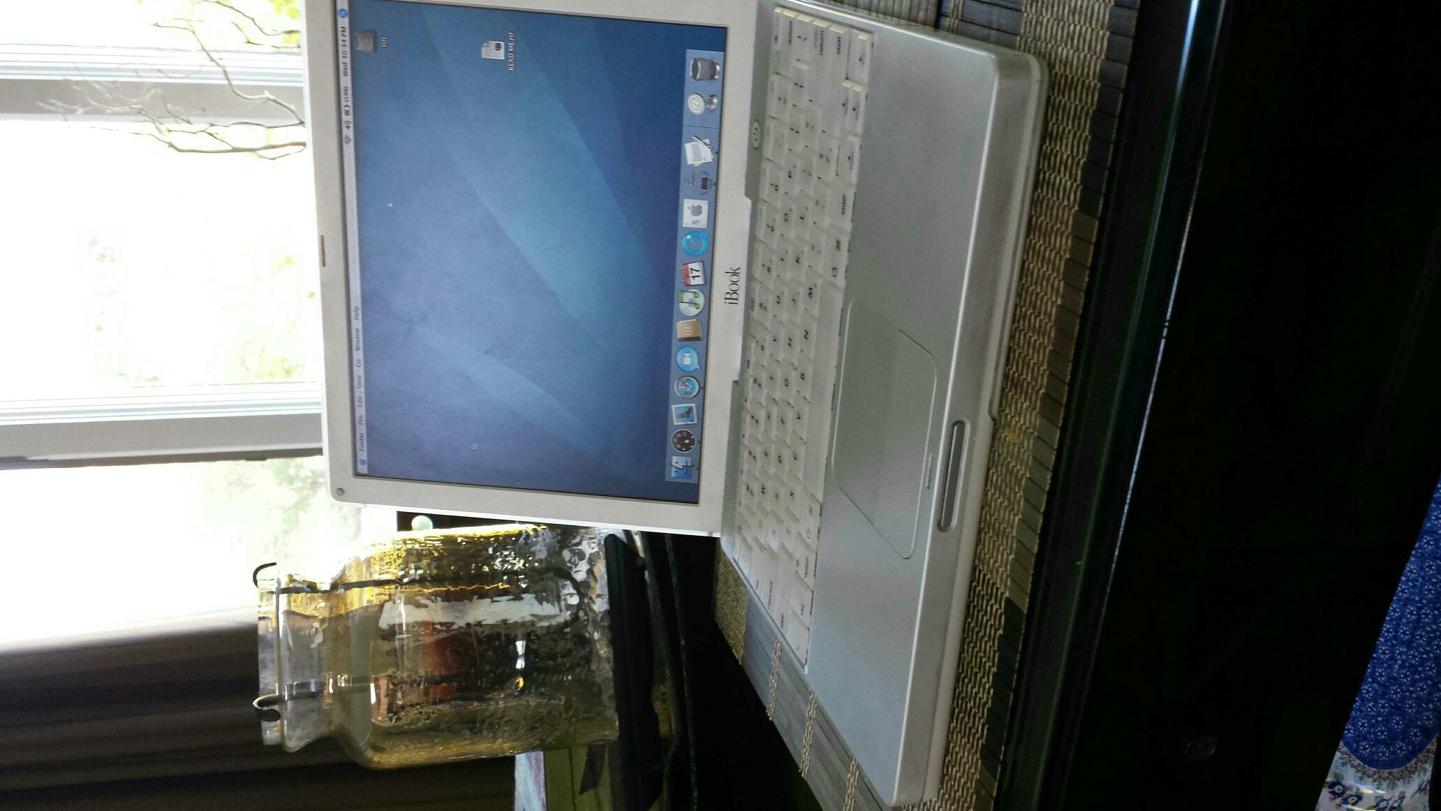

Time to throw OS 9 on it!
I wouldn't ditch Tiger in a hurry-this should run Tiger fairly well.
Before installing OS 9, make sure the HDD has OS 9 drivers installed(it's listed in System Profiler somewhere). Attempting to boot into OS 9 without having the drivers installed can sort of brick the system-sometimes holding X while booting will get it back to OS X, but at other times you have to boot off an OS X install disk and use the "startup disk" utility to get back to booting into OS X.
Also, before you do an OS 9 install, check for an OS 9 system folder on the hard drive. It's often there for Classic support. It will just be labeled "System Folder"(OS X is just labeled "System"). Assuming this is there and the OS 9 drivers are installed, you can boot off of it. Just select it in Startup Disk under System Preferences.
Try 90% isopropyl alcohol or denatured alcohol on the sticker. Saturate the sticker, and you should be able to gradually peel/flake it off.

While Tiger runs well , the main purpose of the iBook G3 was to run OS 9.
The install took less than 5 minutes and now I am happily running OS 9.
As @bunnspecial said, 90% isopropyl (rubbing alcohol) will take it right off. Stickers can be a bit bothersome, but once they are soaked in liquid they come off fairly easy
Recently had to remove 20 or so stickers that were stuck onto a MBP. Alcohol, a razor blade, and a steady hand helps, but patience is really what gets them off.
Anyway that's a beautiful OS 9 machine, I'm a big fan of the transparent keyboard iBooks!
That is a beautiful machine iMod! Pretty jealous 😉. Lots of luck!

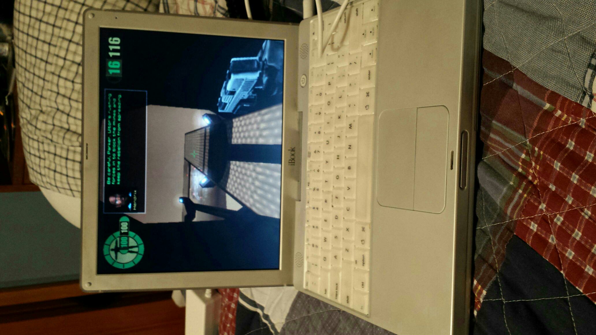

Didn't think a 500mhz with 8mb graphics could game but wow
What game? Also, what's with you and getting computers from people who have been in the professional field, lol. Therapists, teachers... Lol
Red Faction, I'm gonna download Star Wars Dark Forces in a few. For some odd reason, Classila glitches out when trying to download files..."Time:unknown 134235533"

Dark Forces! At first I didn't like DF due to the PSP ruining the experience with awful lag.But running it smoothly at high res. is fun!
Also got the game Abuse which runs well too, Marathon was a PAIN. There was no lag in marathon but there was no escape/pause menu to fix controls so I was forced to restart.
