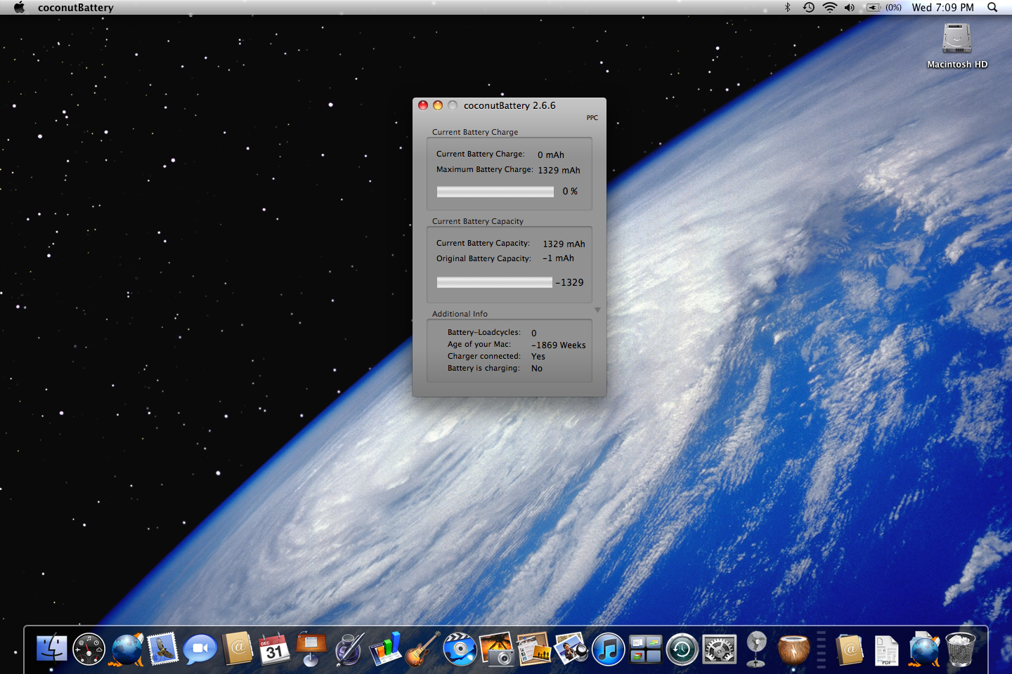

I buy all my PPC macs off ebay broken and then fix them. The battery has been like this since I got it. But to use it, I have to leave it plugged in. Also thats not what my sound board looks like, it looks like this: http://www.ebay.com/itm/Powerbook-1...402?pt=LH_DefaultDomain_0&hash=item4ad8cc86c2 (mods not my auction)
And a while back I downloaded this app to check how the battery is doing and it looks like this:

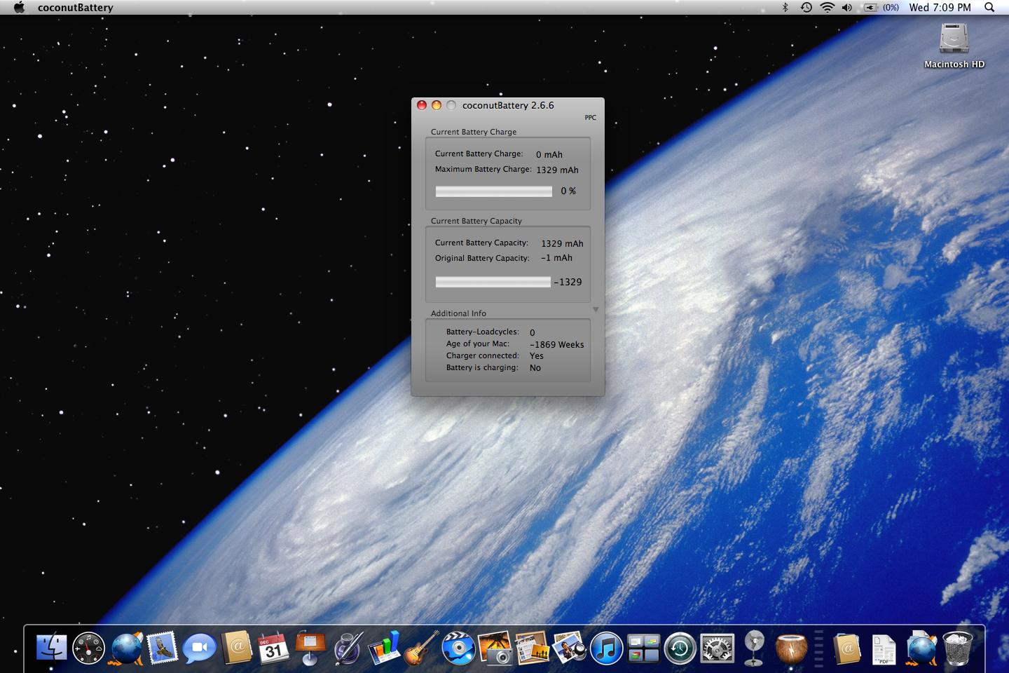

What is the app with the icon of the pedestal fan next to the coconutBattery icon?

Yeah, I had that issue with my old A1139. Replacing DC-In boards did not solve it, so I have to assume that the battery cable (the one from the battery to the logicboard) was bad.
It looks as if your soundboard is also the DC-In board as well. So if replacing that does not set things right it could be the battery cable.
Probably not the battery because even old dead batterys were charging on my A1013 at the time, but the A1139 wouldn't charge them.

G4 FanControl you can control the fans so your PB runs cooler. It's really useful
