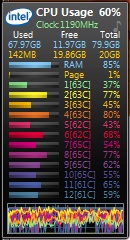

This is the first thing that I would upgrade - your perception of acceptable CPU temps. These chips are designed to run at higher temperatures than 40°.
The attachment shows normal load on my Dell T3610 with the E5-1650v2 CPU (same as the 6-core nMP).
Any temp in or below the mid 60s is "cool". Doesn't even boost the RPMs of the fans.
Upper 60s, pay attention. Upper 70s, do something.
