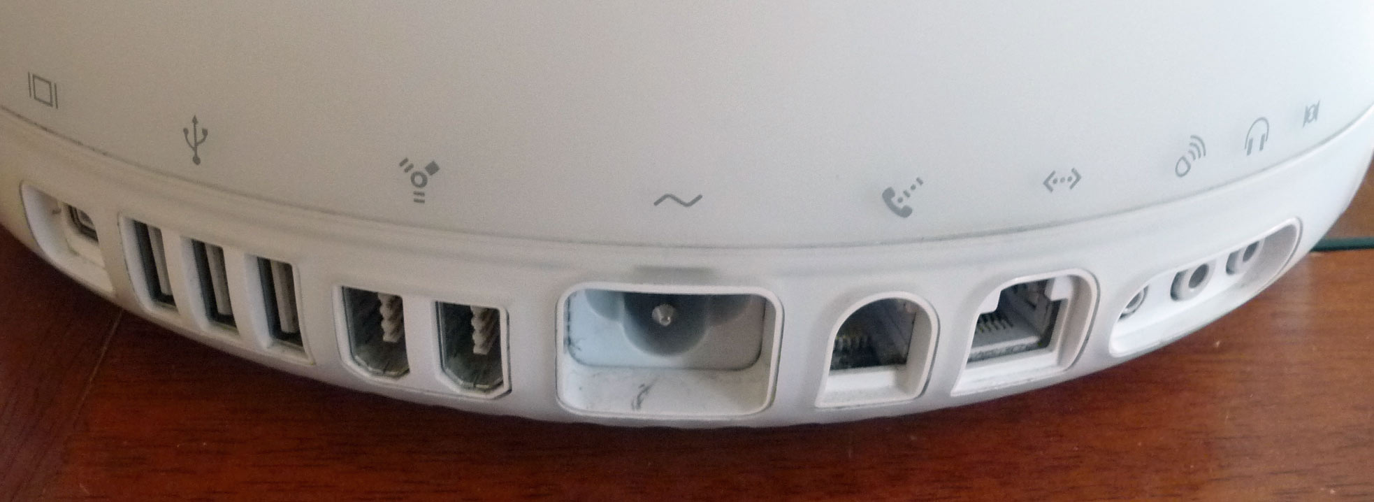

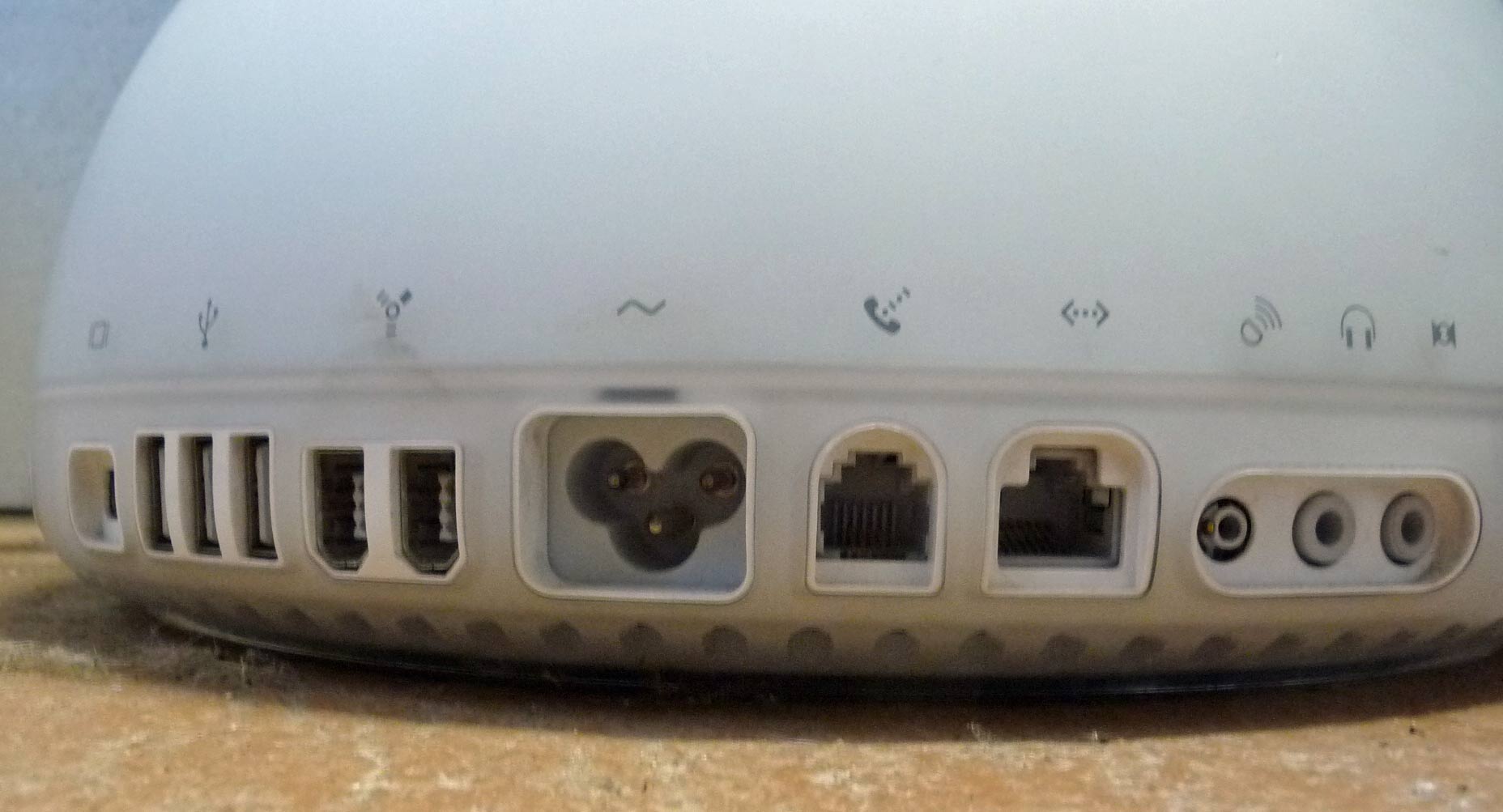

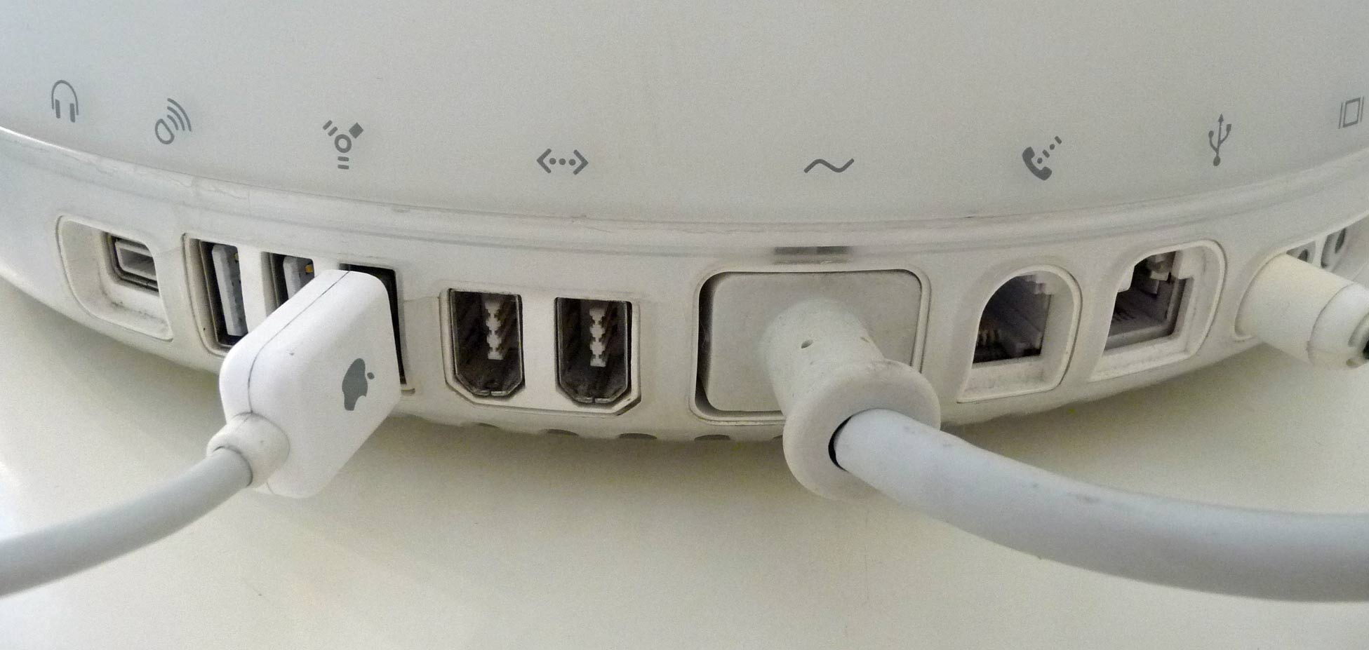

It's always advisable to install parts made for a specific model in order to avoid heart-ache and frustration later down the line. However fwiw, there is some FrankenMac options available on the G4 Imac. Some time back I picked up a (fully serviceable) 20" model to serve as spares for my regular 20". It was only some time later that I noticed that the dome and base didn't match up in terms of connection identification.
Here is a photo of a correct 20" iMac.
And here's a photo of the 20" 'FrankenMac'. Note how the firewire 400 ports are indicated with the ethernet logo, and the USB ports with the firewire logo etc. (The dome appears to be that of a 17" USB2 iMac). I've checked the serial number online, and this iMac was in fact originally shipped as a 20".
For comparison purposes the following photo shows a correct 17" USB 2 iMac (PowerMac6.1)
I can only presume that a previous owner of the 'FrankenMac' damaged the original dome significantly, and needed a replacement, finding a 17" USB2 model.
