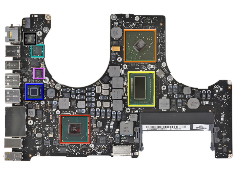

Here's what it looks like in the current generation:
QWKKPpAh4AHJm1bf.large
Larger version: http://guide-images.ifixit.net/igi/QWKKPpAh4AHJm1bf.huge
The orange outline is the GPU. Basically it would be almost impossible to do without damaging other components, and then you'd have to have a replacement GPU (chip only) that had the exact same pin configuration and had no other incompatibilities logic board.
Realistically it's impossible.
