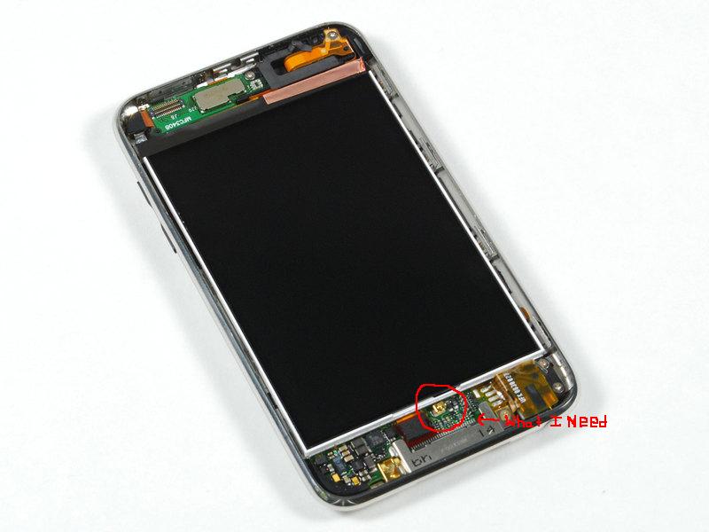

I have an Ipod 2G and I replaced the battery but as I was putting the screen/digitizer back on a Golden "Piece" fell off from under where the Home Button is and then I lost it. I have three questions: 1.Does anyone know the proper name of the "piece"? 2.Does anyone know where I can get/buy a new one? 3. When/if I get one how do I put it back on?

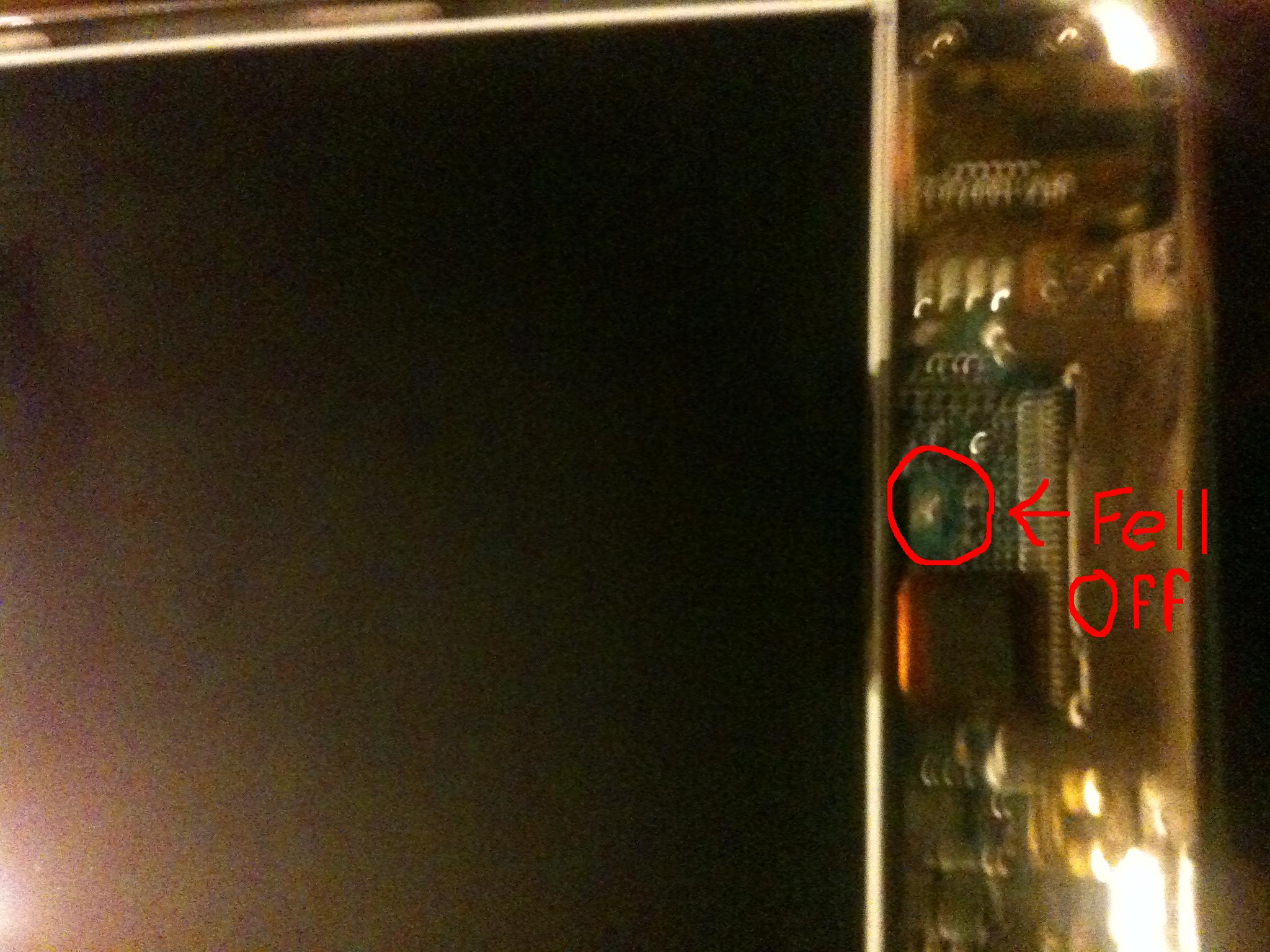

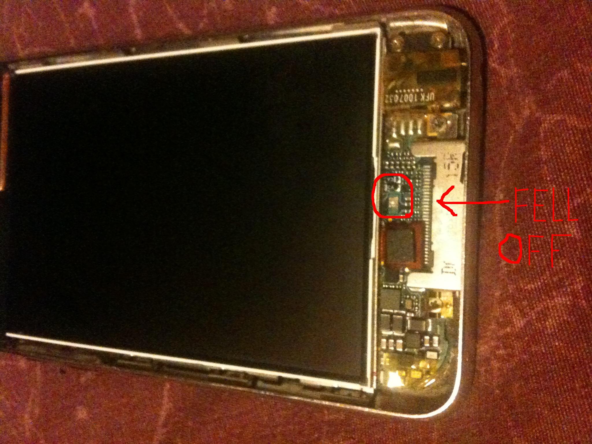

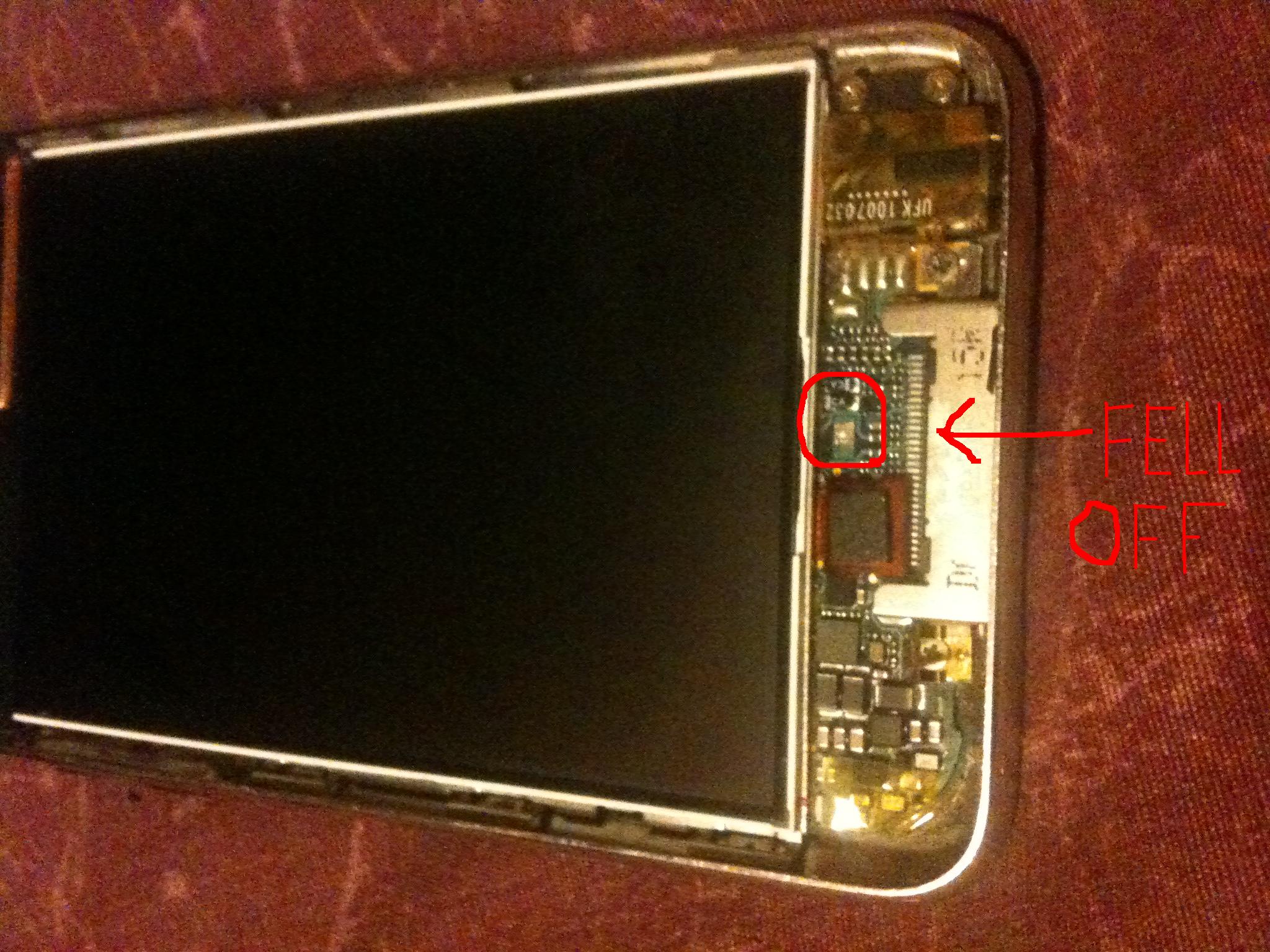

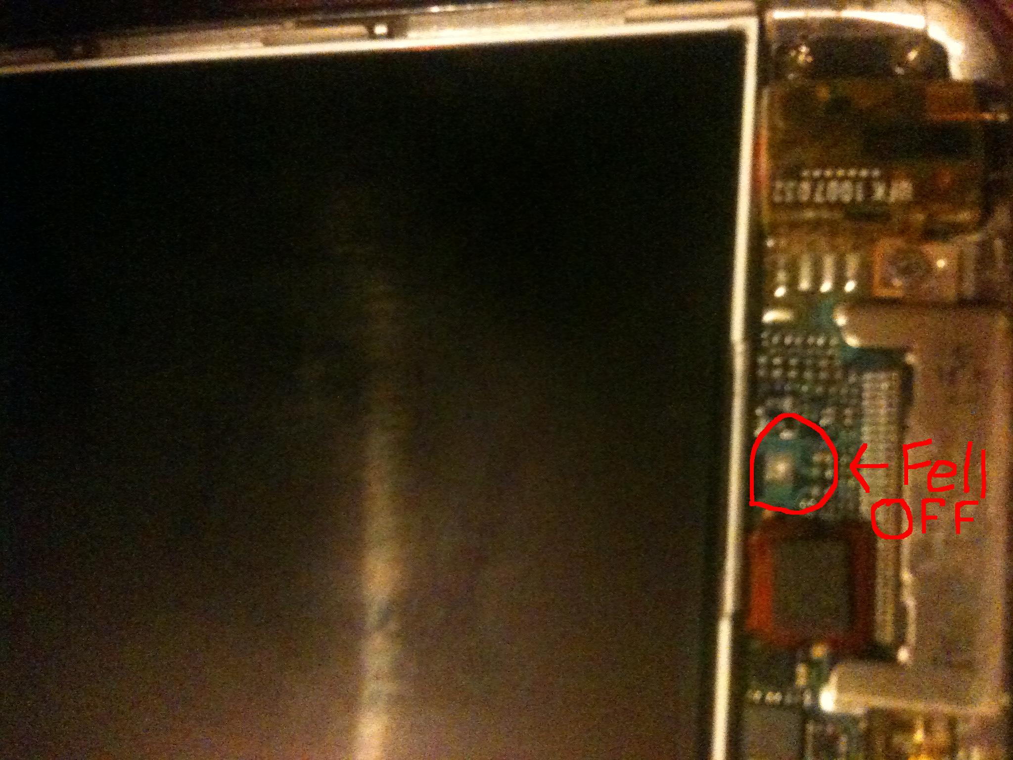

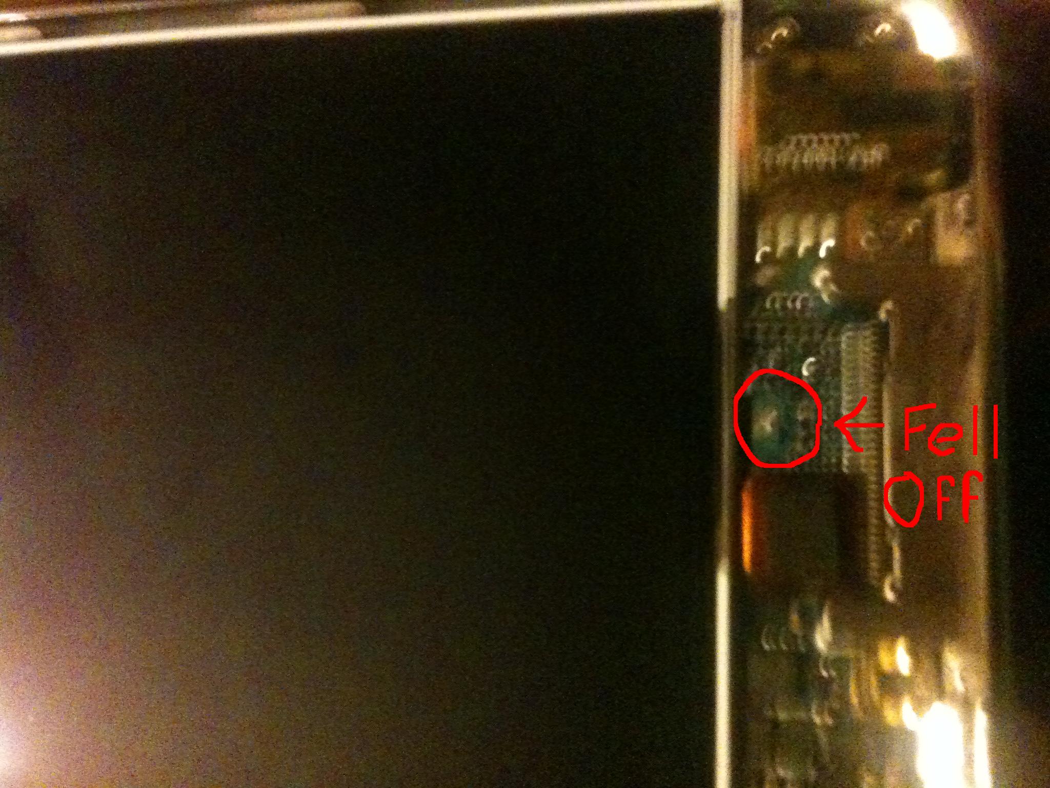

Here are some pictures of where the piece fell off from:

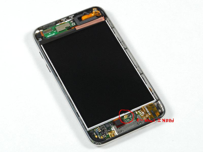

It's a springed contact that connects one terminal of your home button to the logic board. The other terminal is the other gold clip to the left of the dock connector.
I don't know if it has a proper name, I don't think you can easily buy one.
If you get one, you'd have to solder it back on.
When I lost it on one device, I ended up taking some wire and soldering from that pad to the gold pad on the home button assembly in order to fix the iPod Touch.
If you have soldering skills and happen to have a piece of springy metal, you might be able to cut and bend a replacement yourself. I would have but I just didn't have the right kind of metal. So wire it was.
This is what I NEED. Click on the picture for a bigger size.

That looks like the home button contactor. Without it, no home button. The chances of making something to work the same way is so close to zero, I'd not advice you even try.

Soldering isn't something that I can teach you over the net. I learned how to use a soldering iron probably 24 years ago. And for the first 3 years of that, I probably would have botched this repair job. Friends who have learned to solder and done it for about a year would have had a hard time. (I know because I was helping them build stuff earlier this year and I finished at a rate 6 times them and with better production quality too.)
There is no glue involved. For what I did, you'd need a nice soldering iron. A small amount of thin rosin core solder. (I used 60/40.) Steady hands like a surgeon, the skills to use the iron, and 2 inches of 30 AWG wire stripped 1mm from each end. The tools and wire are easy, there's just no chance you'd be able learn the skill without practice.
