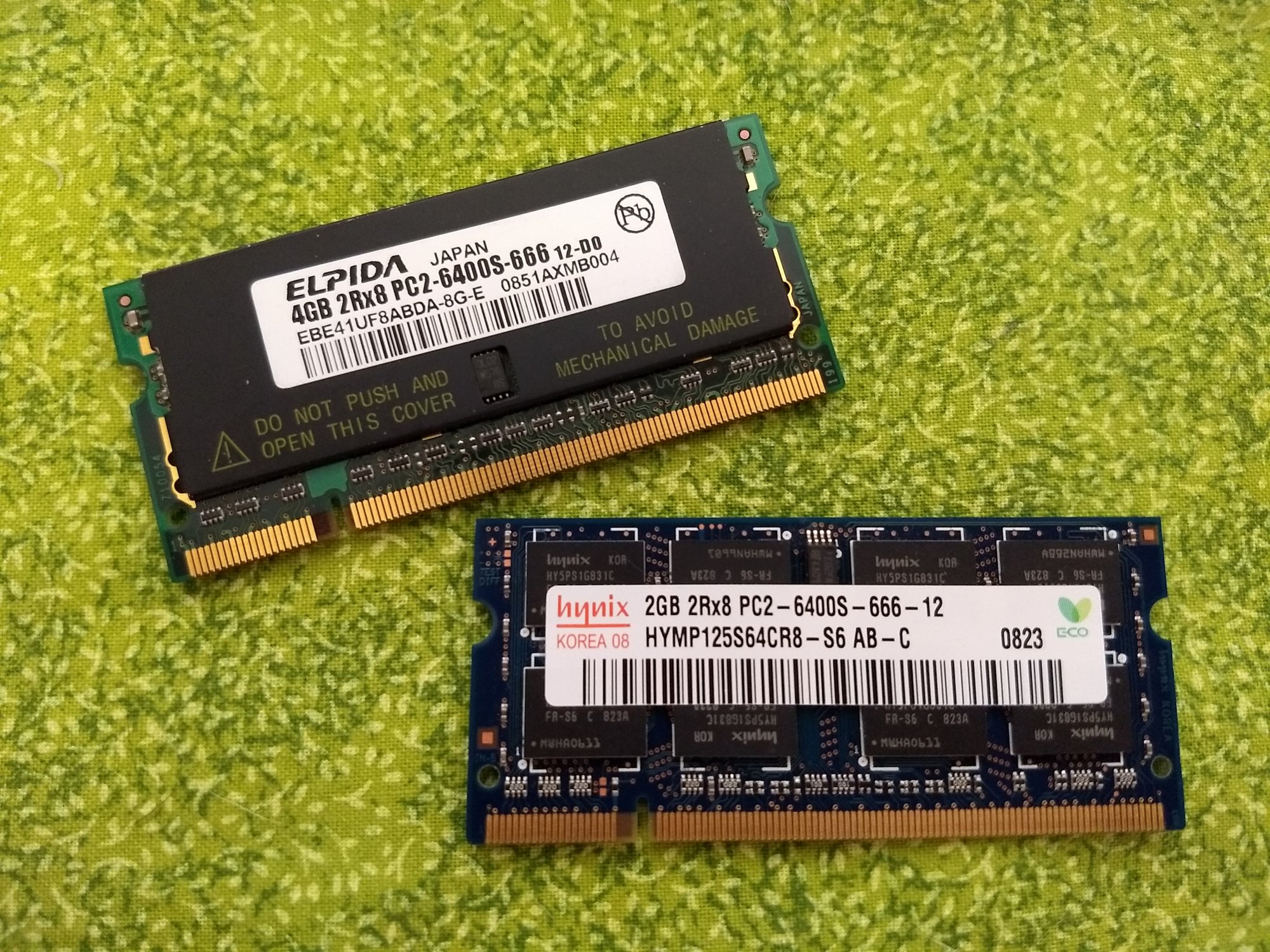

Behold, the culprits:
These two DDR2 modules once functioned perfectly in my 2007 A1226 MBP, but alas, no more. The "why" of it is something I can't understand.
It's not the RAM itself. I pulled the modules from a working Dell Inspiron 1545 which I had upgraded to serve a particular purpose (some standardized professional testing). That purpose having been served, and said Inspiron having developed certain faults which were not worth fixing, I retired it to recycling. But the memory was never a problem.
And that was also the case - I emphasize was - in my 2007 MBP, from which I originally pulled these modules for service in the Inspiron. Back in 2018 when I purchased that MBP, one of the first things I did was bump the RAM up to the max 6 GB. It ran like a top with nary a problem. But upon retiring the Inspiron and returning these modules to the MBP, the MBP wouldn't even POST. Just gave the flashing lights on startup, no bong, no fan spin, no nothing.
OK, I thought, something happened to the modules when I pulled them from the Inspiron. So I tested them in my 2008 iMac 8,1. All 6 GB registered, and everything worked fine. Alright then, maybe I didn't get them seated properly in the MBP, so I tried that again. Nope, just flashing lights again. OK, maybe I somehow damaged the MBP when I pulled its 4 GB of RAM out, and put the 6 GB back in...uh, nope. Booted right up with the 4 GB.
OK, says I, scratching my head...maybe I'm just remembering things wrong. Maybe this wasn't the 6 GB I had in there before. After all, the A1226 MBP takes PC2-5300, and these modules were PC2-6400...in my experience this should work, but who knows, computers can be picky. So, I take a good look around for a PC2-5300 4 GB module. I can't find one. Anyone who's shelled out the bucks for one of these knows they're not cheap, and knowing myself I can't see having something like that laying around when I had a beloved old Mac that could take advantage of it! And I sure don't remember buying one, and I usually do remember that stuff. The only 4 GB RAM module I had, besides the one in regular use in my iMac, was the one pictured above - and I just know I had that working in my MBP!
Or maybe I didn't....more head scratching...perhaps I'm losing my mind?? But then, I found proof that I did, in fact, have 6 GB of RAM working in that MBP. And that requires a 4 GB module. And the only one of those I possess (besides the one in the iMac) is the one you see pictured above.

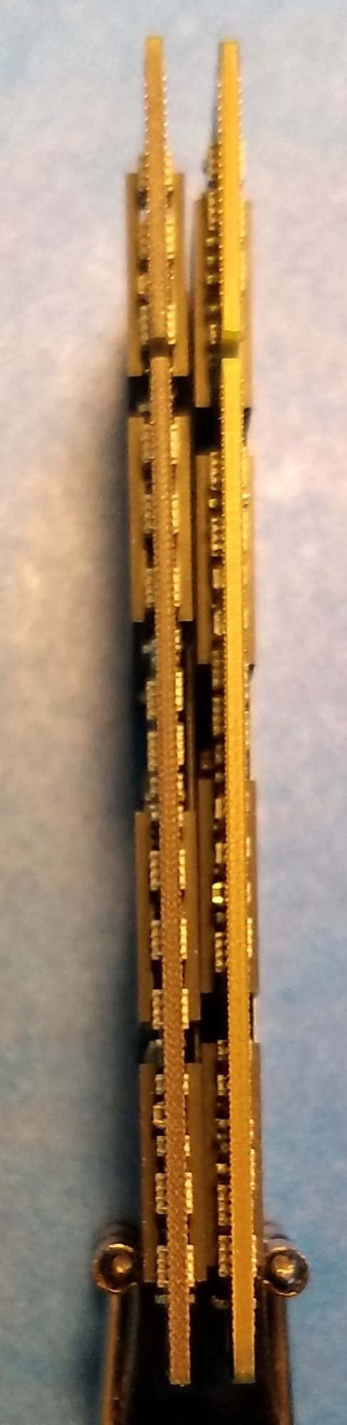

This reminds me of a similar thread I read a few days ago with a different system. Probably unlikely, but is the thickness of the non-working modules thinner than the ones that are working? Maybe they're just not making good contact with the pins in the slots anymore?

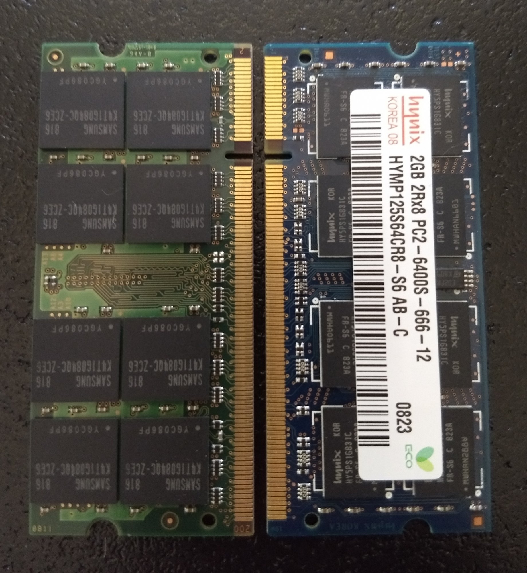

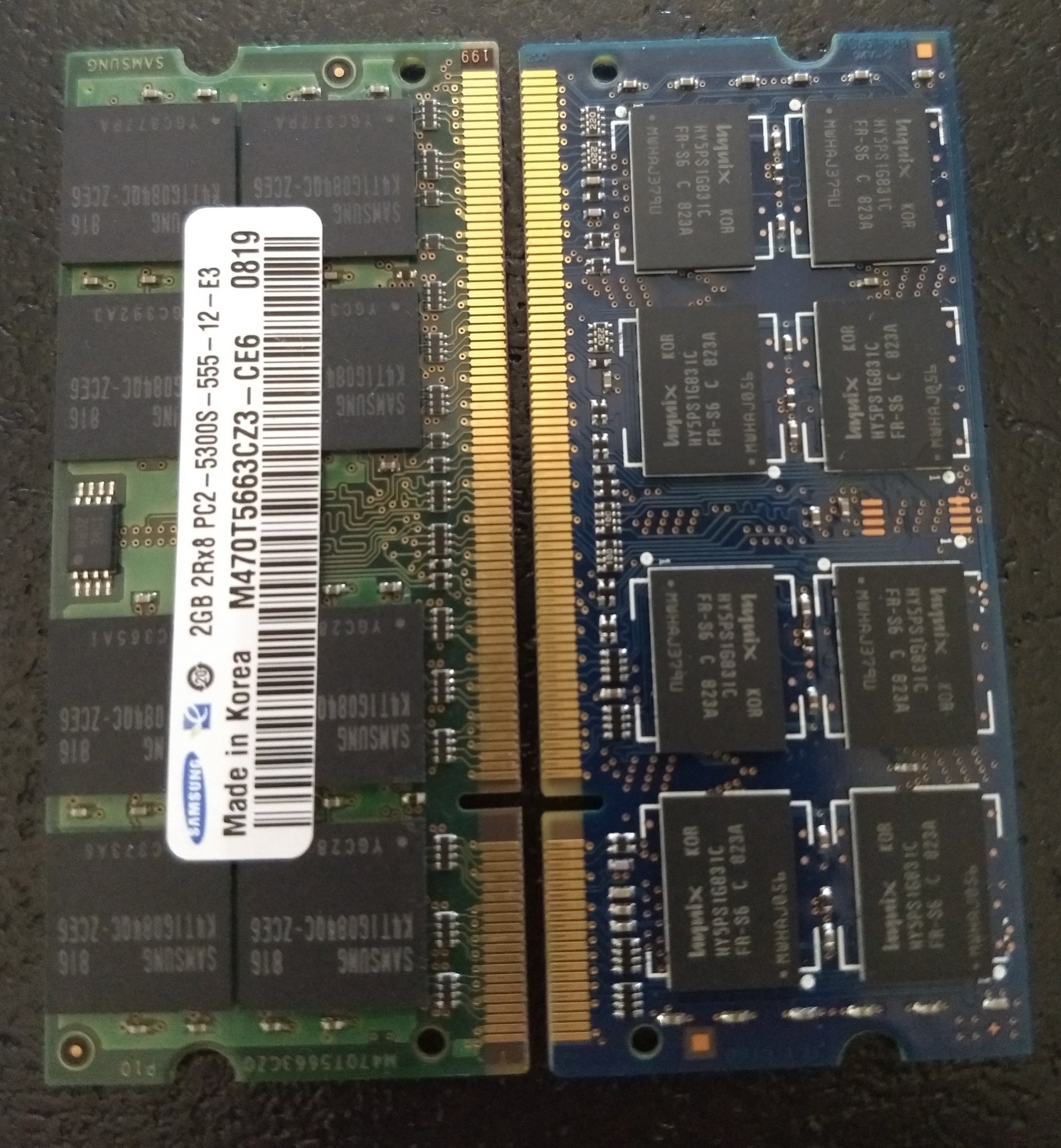

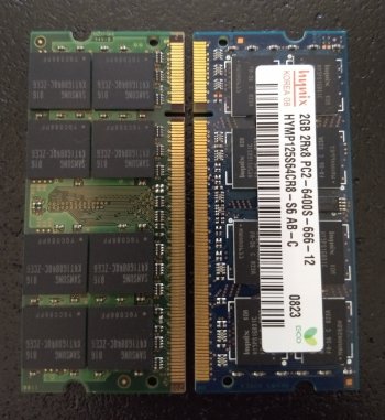

Well, you tell me. On the left in the pics below is a Samsung PC2-5300 2 GB module that works in the MBP, and on the right is a Hynix PC2-6400 module that doesn't work in the MBP (but works fine otherwise). To my eye, the contacts and thickness look identical, but see what you think:
IMG_20220430_133755932.jpg IMG_20220430_133839831.jpg IMG_20220430_134453667.jpg
The thing at the bottom of the last pic is just a binder clip I used to hold the modules together for the shot.
So there you go. Note: the differing color of the PCBs is not the problem, because I have some Kingston PC2-6400 that is the same color PCB as the Samsung, and doesn't work in the MBP. It's also not the configuration or physical size of the individual memory chips, because the Kingston uses a different setup in that regard than both the Hynix and the Samsung. This is all DDR2, and none of that stuff should matter anyway!
