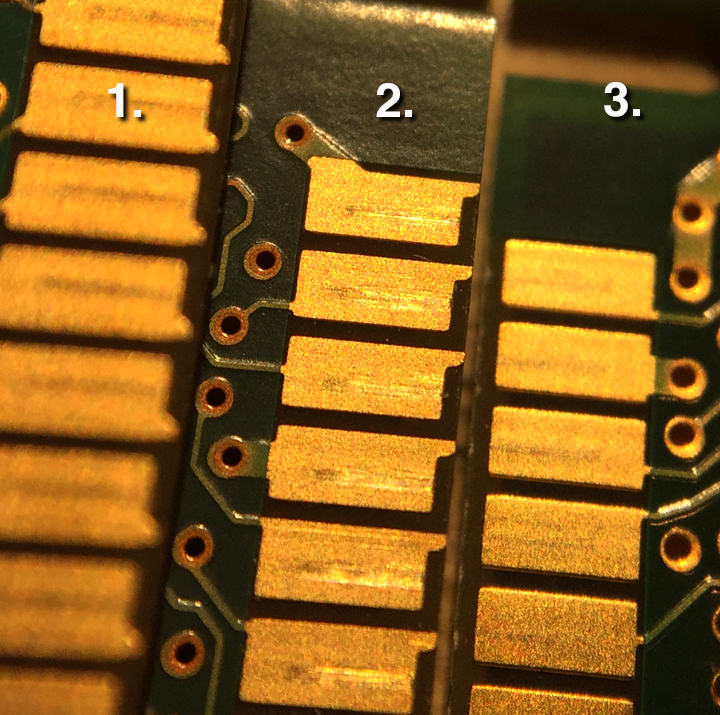

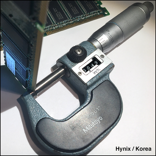

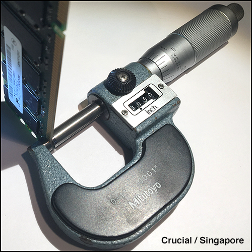

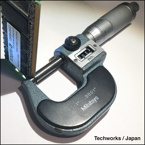

Close-up, contact “wear” comparison between two older sticks and the third (newer) is revealing? RAM does get swapped around quite a bit here and between different machines. *Some “wear” does occur. AND perhaps in the RAM slots too.😉

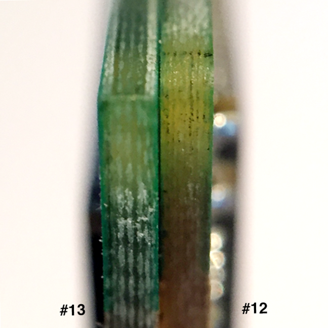

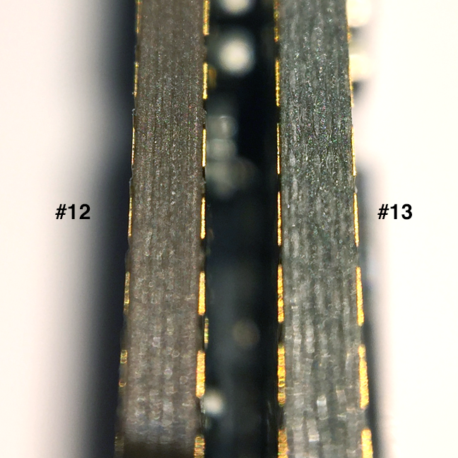

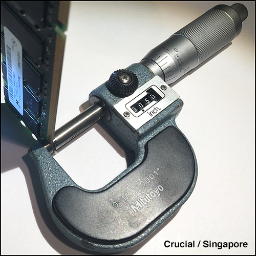

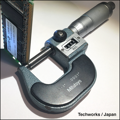

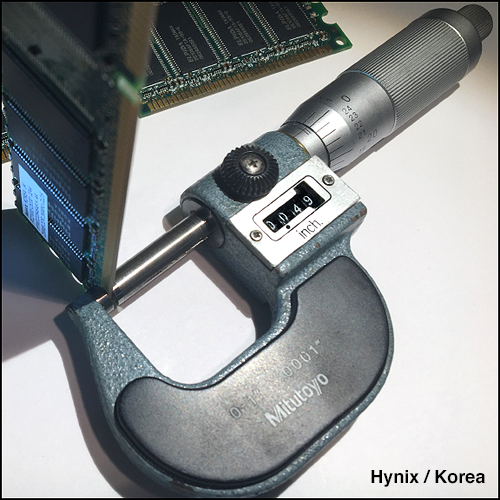

And side-by-side thickness comparison / looks like #13 is thicker. (Where is my micrometer?) Thicker one is a TECHWORKS 512 MB stick.
