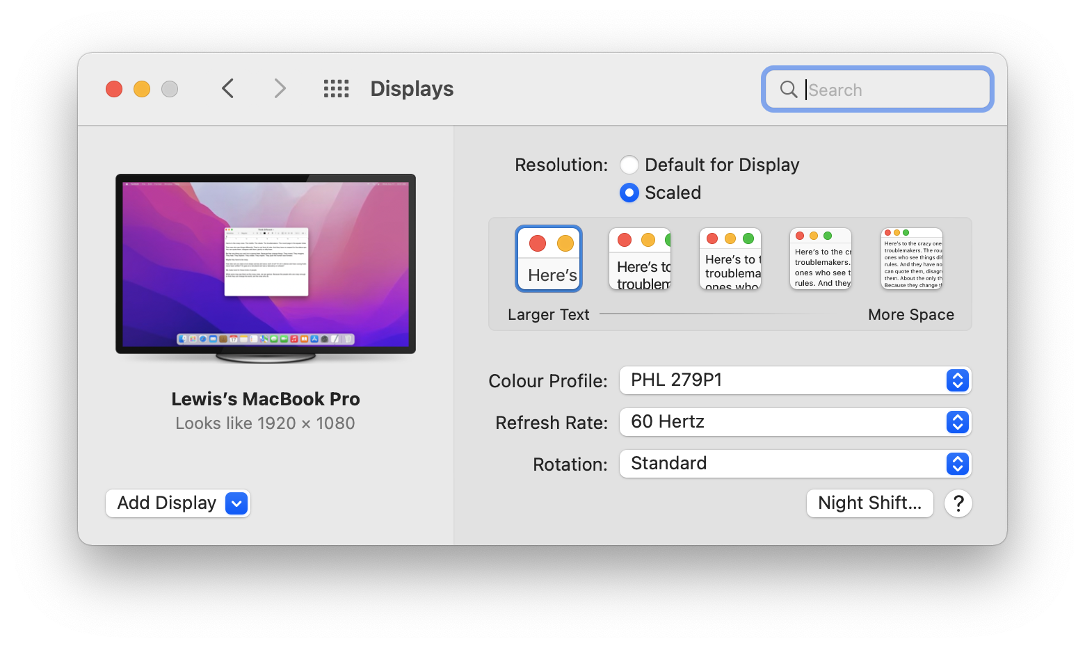

I’m using a Philips 279P monitor for coding on my M1 MBP. It is 4K resolution, but set up as 1080p “Retina”, so no jaggy edges.
It doesn't specifically say "Retina", just looks like 1920 x 1080. But it is 2:1 pixels.
