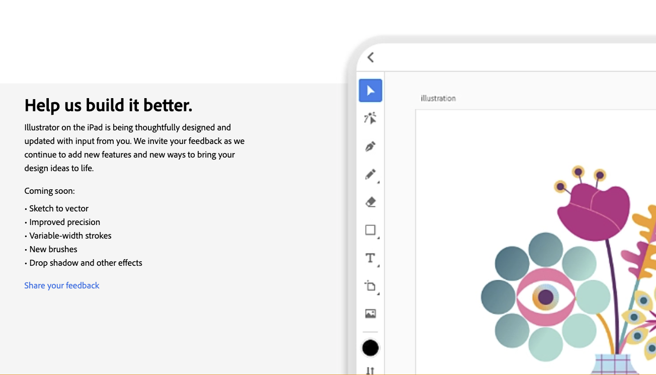

So Apple announced that Apple Silicon Mac will have an unified platform that they can use both iOS and iPadOS apps on AS Mac without any modification. This is a great news but there are few things that we have to concern because Apple is not clearly clariying.
1. iOS/iPadOS apps to Mac, but what about the opposite?
This has not been proved at all and I really don't think most x86 based software ported to AS Mac wont gonna work on iOS and iPadOS devices. Which means dont expect both Final Cut Pro and Logic Pro on iPad. Even both Photoshop and Illustrator have totally different UI and design compared to x86 and I dont think that's the main purpose of platform unification.
2. RAM size for iOS and iPadOS
This is one of the reason why Mac software wont gonna work properly on iPad or iPhone. 6GB is seriously isn't enough and the graphic itself also consumes RAM storage since Apple Silicons are using the unifiied memory so you will have less than 6GB if you start using Photoshop or Illustrator. Btw, Illustrator's minimum RAM size is 8GB. If you were thinking to work with pro apps from Mac with iPad, then Apple need to increase the amount of RAM or otherwise, the unifieid platform wont gonna work.
3. You still need to make an app or software separately just for Mac.
Because of different spec requirements and UI, I really dont think most software like Adobe wont gonna work with the platform unification. For gaming, it's still possible to play PC or console games on iPhone or iPad because you can use a console controller despite the graphic quality. Nintendo Switch is an ARM based console and it has 4GB of RAM so it's still possible but not for pro softwares. But if one app, all platforms dont work, then what's the benefit for Mac users?
Well, just a personal research but so far, these are my concerns. Any thoughts?

Adobe's case will be interesting. They ported (badly) some of their apps to iPadOS with a very limited UI, so they now have an incomplete iOS version (which must be somewhat modern or it wouldn't run on iOS) along with a dinosaur app on macOS full of legacy design choices but still much more capable than the iOS version.
I think the smart move would be building a fully-functional iPadOS for both iPadOS and macOS but I don't think they will.
I’d bet money that the iOS version of their apps run quite a bit of that “dinosaur app” code, with things like plugin support/etc ifdef’d out. When compatibility matters, budgets can push you to reuse existing legacy code, rather than attempting to start fresh. Validating that your new stuff behaves the same as the old stuff is expensive.
I quote some info below that Office is sharing their Mac/iOS code base from 6 years ago. More recent information from the same engineer says that Win, Android, iOS and Mac are now all being built from the same code base. I’d just have to track down that other link again from one of my other posts.
So I’d be surprised if Adobe, who is in a very similar situation, would have gone the rewrite route.
