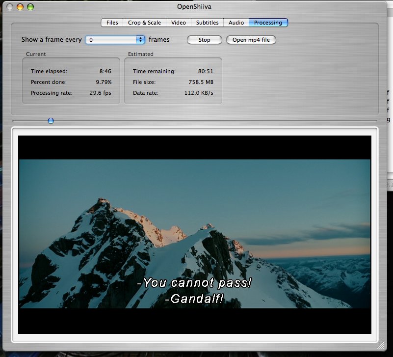

OK. Perhaps I'm not being as clear. I am not using a DVD disc at all. I extract the contents to my hard drive, then use a conversion program to compress the contents into an MP4 file.
This is what I do for my movies:
The movie being compressed is the extracted data from The Two Towers Extended edition DVD. No disc is in the drive. The contents were extracted yesterday onto my recording drive hooked directly into the G5's lower drive bay. The boot drive with the program on it is in the upper drive bay.
What I want to do is use two SSDs in the place of the mechanical drives.
My question is this: will I see a performance increase from the use of the SSDs? I anticipate that I will.

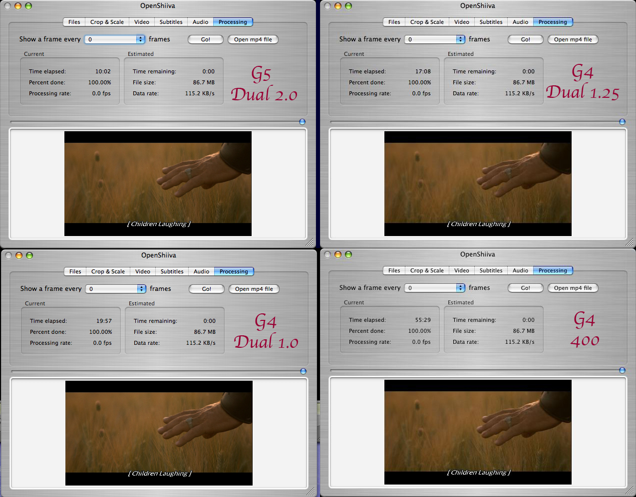

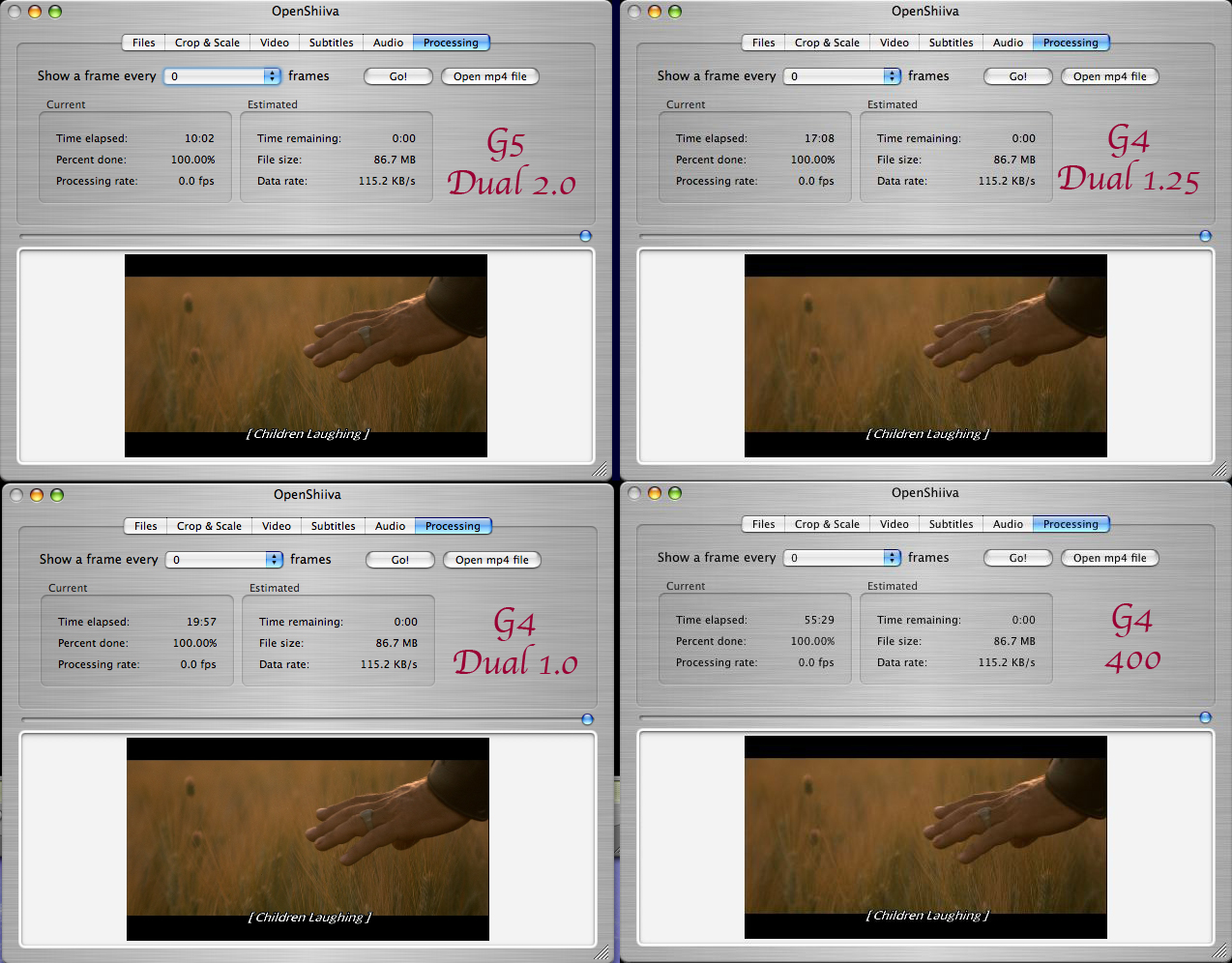

Just for the lulz, I did a test of my 4 Macs and the same clip extracted from a DVD. I did everything the same on all 4 machines and it was interesting to see all 4 Macs doing the same thing at different speeds. If only I could link them all via XGrid.
The clip is the first 12 minutes of the movie Gladiator.

Ah, this is good. I actually thought about doing the test for you with my 2,3GHz DC G5 and two SSDs on a SATA-II-PCIe-card. Now that you have done it: good, so I do not have to do it. 😀

On the SSDs: but didn't the OPs 4 tests include write and seek times? And proved that there is no advantage, because the CPU limits it?
My thought, for example, was, that acces time would increase and iMovie would have quicker access to every bit and little chunk of a file. Quickly getting it, encoding it, quickly passing itnon to the destination drive. But I saw that iMovie only uses 16MB/s on a 1,33GHz ibook G4 and 20MB/s on a 2,3GHz DC G5. Both would be capable of more, but they do not even break ATA-speeds.

I've sort of scrapped the idea for SSDs given the info in this thread, but the image i posted above regarding the time it took to make a movie was a test of all four of my Macs doing the exact same test the exact same way at the exact same time.
