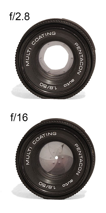

In any case, look into depth of field and its relationship to aperture, and also into getting a large aperture lens such as the 35mm f/1.8.
You can get that effect by using a wide aperture lens (f1.4-f2). Focal length also plays its part, since a longer focal length will compress the DOF more than a wide angle lens. Finally, the distance from the subject is also involved. Generally, the closer you are to the subject, the shallower the DOF.

Depth of field...
You should be searching for the terms "depth of field" which translates into the how deep does the focus on a picture go.
I was taught that to achieve this you should put the camera in it's highest aperture, the biggest focal length you can have (although 105 can be an overkill) and shoot.
Be careful as to where exactly you are pointing the focus at, sometimes you get a depth of a few millimeters that are focused, meaning that if you focus on something that is a few millimeters before or after your subject it will be unfocused.
The best to do is to try it by yourself. Start in aperture priority mode, put the aperture in the lowest number you can have and take a couple of shots with different focal lengths and see what you get. 🙂
