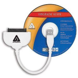

Stop. Get a SATA to usb cable. It's less than 10 bucks. A PC doesn't have a clue how to make a GUID partition scheme with 1 HFS+ partition which is what you will need. Consider this...

Bottom line: Your PC is useless for upgrading the HDD in your Mac. Even if you can find software that runs on Windows to create HFS+ partitions, do you want to trust your entire OS to such software? Get a cable even if it means waiting for it in the mail and use your Mac to upgrade your Mac. Much safer. Plus the cable gives you the ability to test booting from your new drive before you take your Mac apart to install the new drive. This peace of mind is well worth 10 bucks and a few days waiting for USPS (assuming you don't have a local Fry's or MicroCenter to pick up the cable in a matter of minutes).
BTW, restoring from a disk image is another option but it doesn't give you the ability to test the boot disk before taking your Mac apart to install it. BTW, if you buy a cable that comes with a CD, the CD makes a nice coaster. There is nothing on the CD you need on your Mac.
