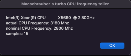

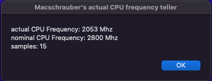

A little x-mas gift for you guys :)
As there is no real way (I have knowledge of) to monitor the actual / turbo cpu frequency of the Xeons in classic Mac Pros I made two little scripts for displaying the actual cpu and turbo cpu frequency.
(The Intel Power Gadget tool does not work on our Xeon generation.)
It's the powermetrics cli tool what gives that information, I took 15 x 100ms samples and calculated the average for the actual load. Plus maxing 1 core out with the yes cli tool for triggering full (but not infinite) load.
That was a single Mac Pro 5,1 running a X5660 on Monterey
The scripts need the admin password for privileges of Powermetrics and Terminal access. Also they needed right-click-open for the 1st start as they are not signed. The script text is readable.
Edit: added CPU type reporting to the turbo script (don't wanted to add additional load for the actual frequency script)
Edit2:
Added a script for measuring the actual CPU Frequency working on Apple Silicon. Measuring forcing a turbo load I cannot do as I have no Silicon Mac available. Everyone is welcome to add this.
  • CPU Frequency 1.1.zip
  • silicon.zip

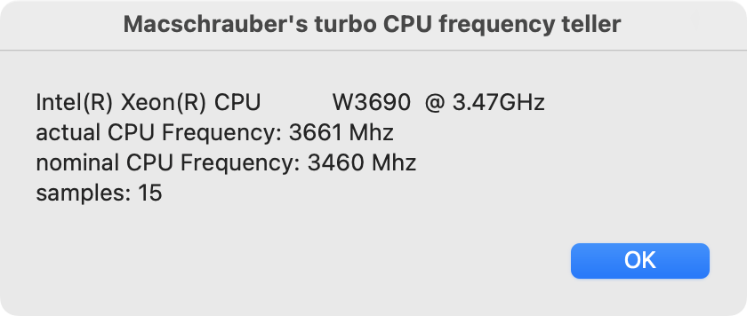

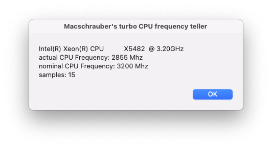

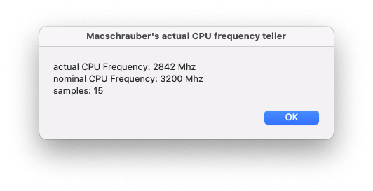

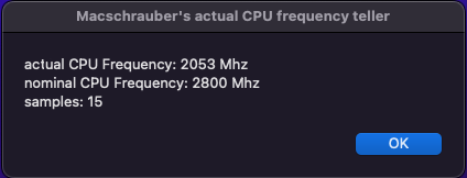

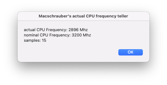

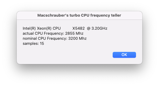

Merry Christmas, both script works beautifully.

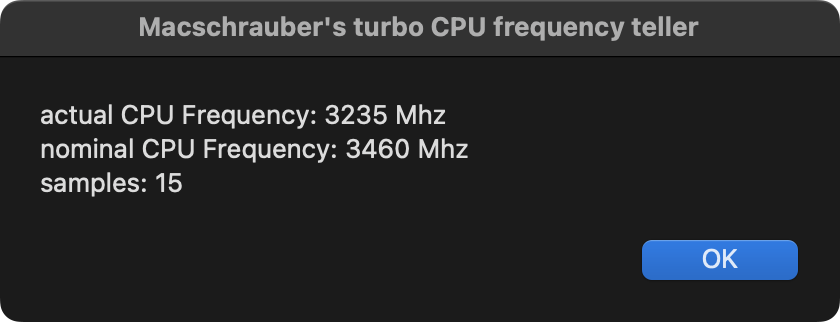

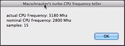

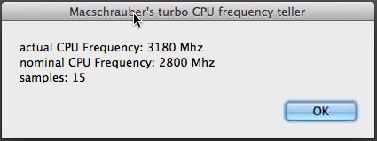

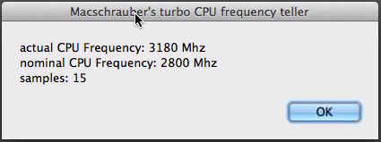

I expected a higher turbo frequency, maybe you need to run the turbo script more times (or the machine was not in idle).
tested it in a supported system (Mavericks) and the turbo speed was closer to the specs (3.2 Ghz for X5660)
You are right, the cMP was not in idle. And I agree with you that the clock speed should be higher for the Turbo check. Even all cores running, the speed should able to reach 3.6GHz. My cMP had no thermal restriction during the check, all cores were cool.
Will run it a few times properly later and report back.

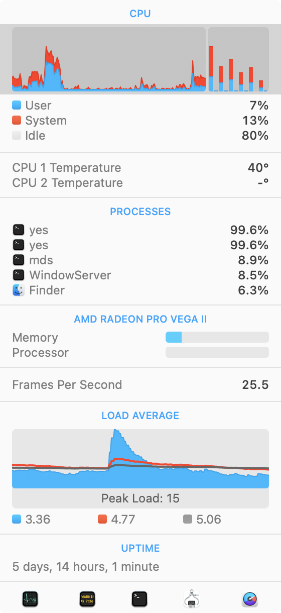

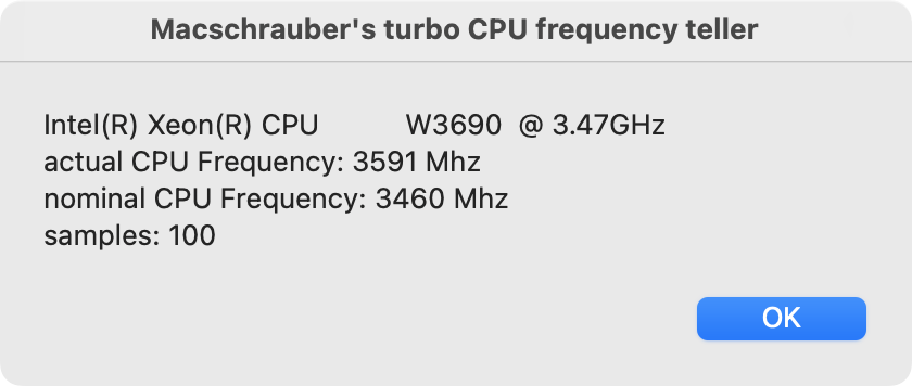

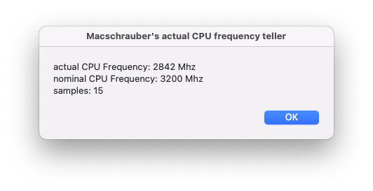

I closed all apps, and run the script when the CPU load was nearly zero. This give me a more reasonable result.
Even it should be 3.73GHz, but 3.6GHz is much easier to capture. I will run it few more times and see if I can capture anything close to 3.73GHz.
Anyway, for info, there were two Yes command captured, not one.
I believe run only one Yes command is better. My understanding is that another physical core will have piority before the 1st virtual core. Therefore, the method now will stress two physical cores, but not a single physical + virtual core.

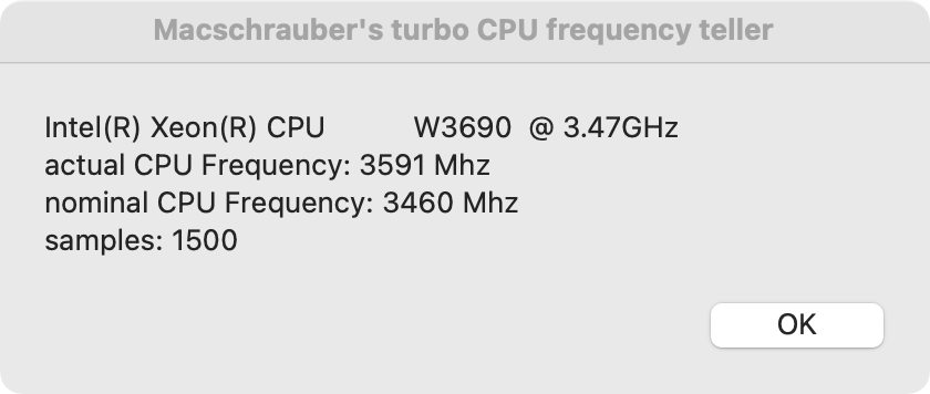

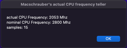

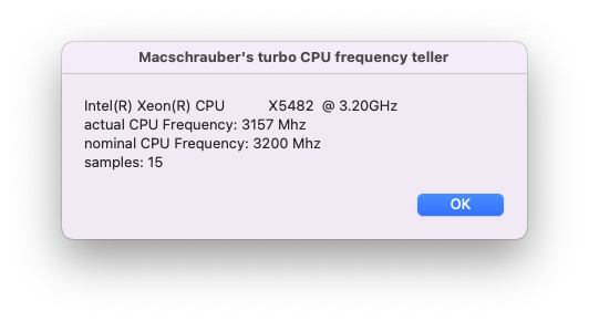

I tried 15, 100, and 1500 samples. All worked out the same clock speed. So, I believe the sampling method and the script itself is working beautifully. Able to provide accurate and consitent results.

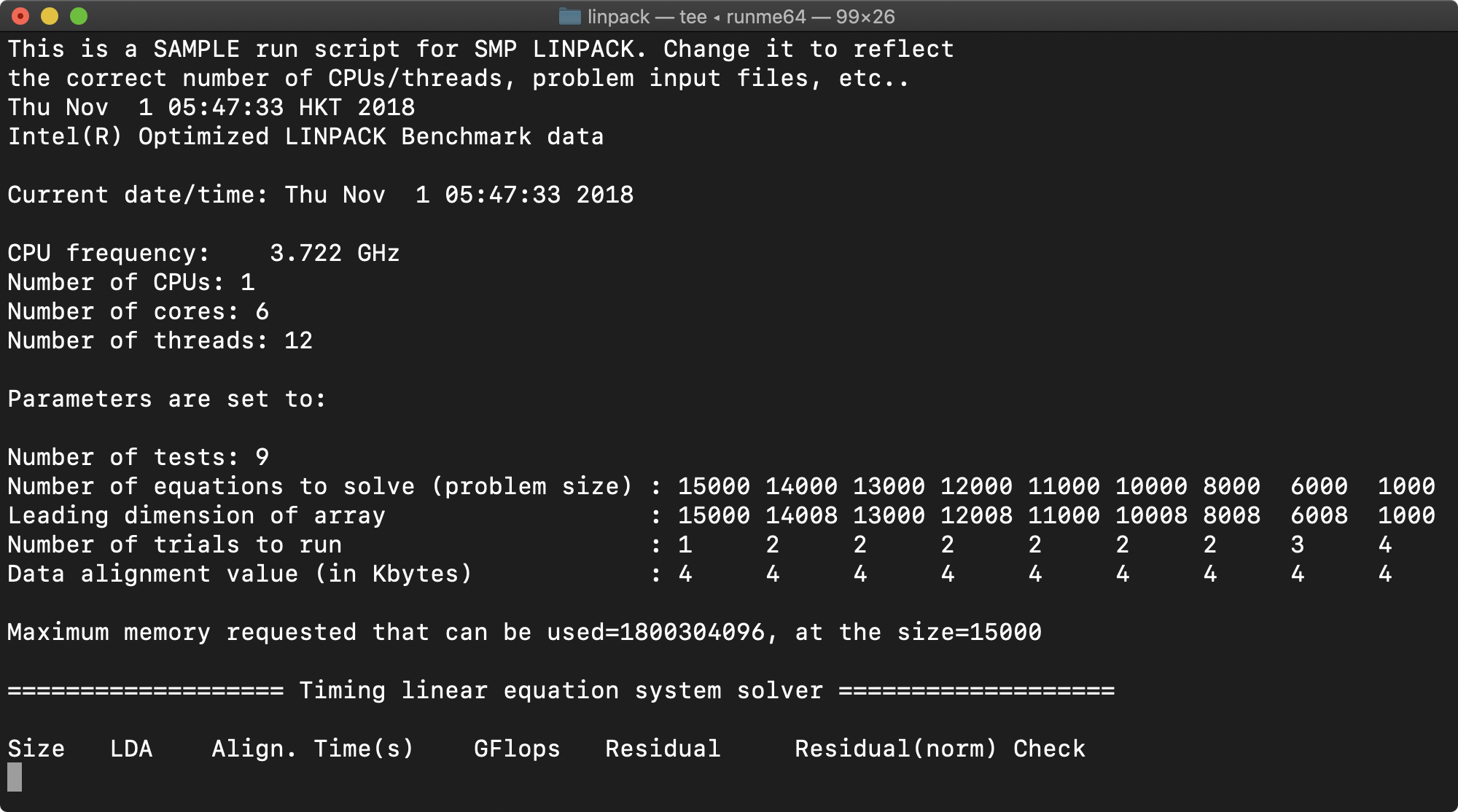

For info, in the last 10 years, the only thing (in macOS) can show me ~3.73GHz is Linpack (32bit). I believe it also use similar method to work out the CPU clock speed.
But I have to try quite a few times to capture that, 3.591GHz is the normal number that I can capture.

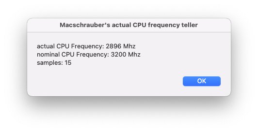

Another interesting finding. If I test run the script in the Script Editor, the clock speed will be slightly higher. Also, the result will vary a bit, but not always 3591GHz.
(I reduced the sample number to two in order to save some time. For peak clock speed capturing, this should be good enough anyway).

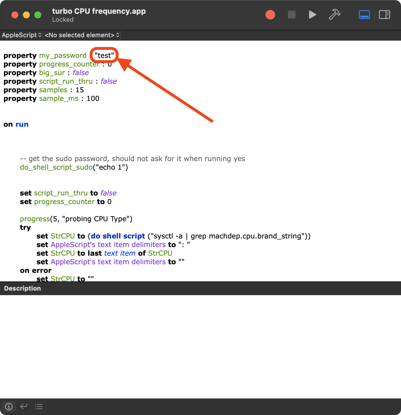

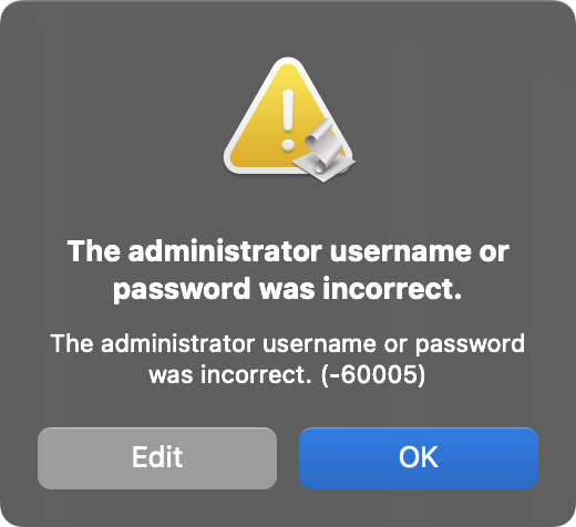

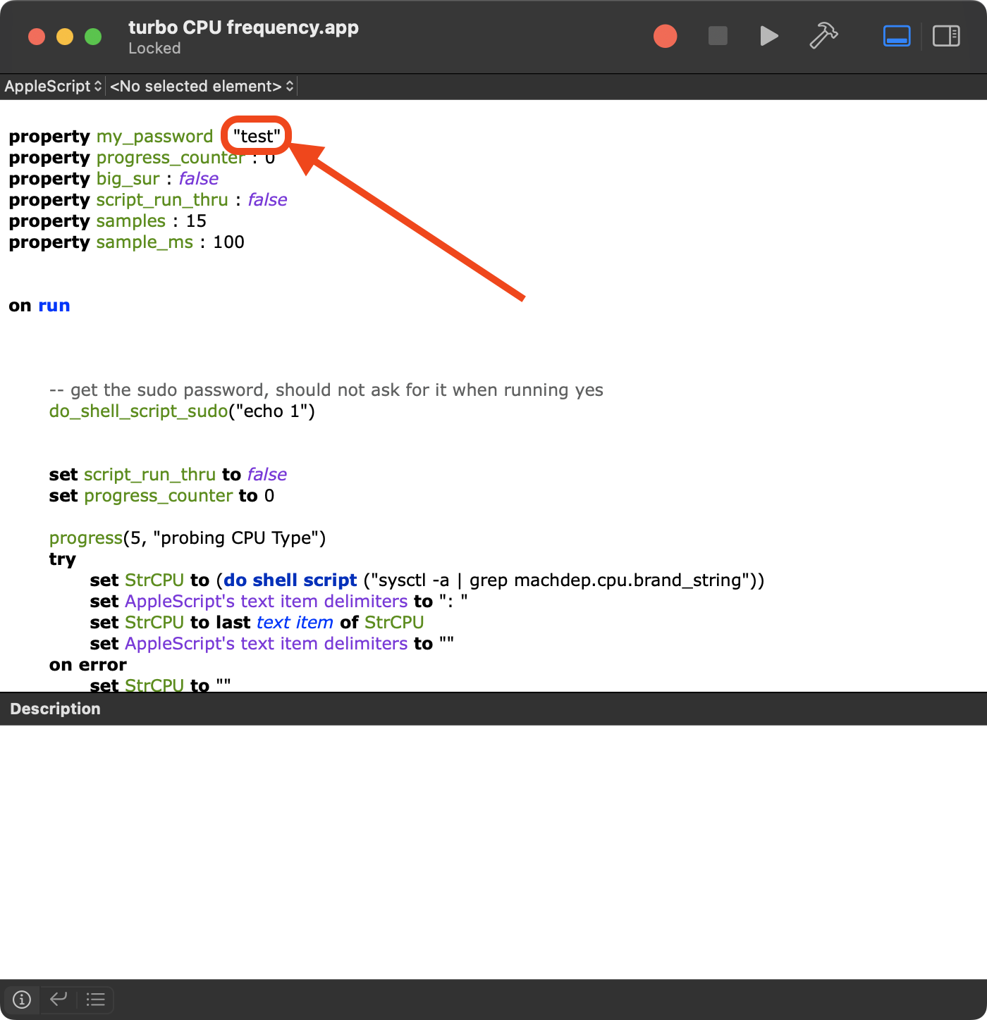

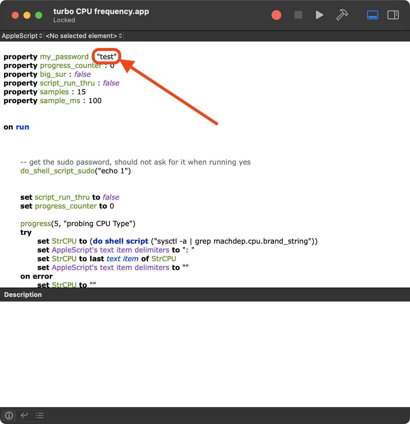

I believe you accidentally leave the word "test" here. I think it should be just ""?
Otherwise, error occur (in Monterey 12.6.2)
It don't matters, if it is wrong its asking for the admin password.
Edit: But not for Big Sur and later, that was fixed
That's btw the AppleScript do shell script bug since Big Sur, if the stored password in a variable is wrong it won't ask for the correct one.
I know noone should store a password in a script as it is readable for everyone - but for test sake it is much more comfortable to do it temporarily.

Yeah, Ver 1.1 seems works better. In the previous version. I always get 3.591 if using the apps (in Monterey). And must run the script in the script editor in order to get this kind of real time calculated number. But now, the apps can show me this number.

Yes, that was that nasty behaviour of Powermetrics.
But just in new systems, older like Mojave or El Capitan read correct, self running and in Script Editor. At least for my test boxes.
