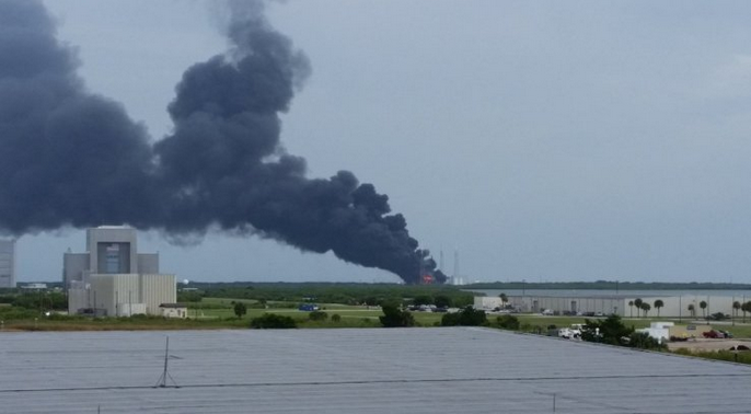

https://techcrunch.com/2016/09/01/a-spacex-falcon-9-rocket-just-exploded-at-cape-canaveral/
According to numerous eyewitness reports, a SpaceX Falcon 9 rocket just exploded while resting on a launch pad at Cape Canaveral. This rocket was set to launch on Saturday…
The Associated Press is now stating that the rocket exploded during a test.
That not good to see. It will be interesting to learn what went wrong.
Wording seems to indicate a glitch with the pad may have caused the explosion vs something wrong with the rocket. What isn't clear is did it explode during the static fire test or before? The statement again indicates it was in preparation for the test and not during. Someone sent the wrong instruction and accidentally activated the Falcon 9's self-destruct mechanism? A spark somewhere on the pad during fueling ignited the RP-1/Oxygen? So many possibilities.
As long as SLC-39A is ready, it shouldn't ground the Falcon 9 assuming it was the pad vs the rocket while SLC-40 is repaired. Granted it may ground rocket launches for a month or so to officially determine if it was the pad, speed up the activation of 39A, etc.
