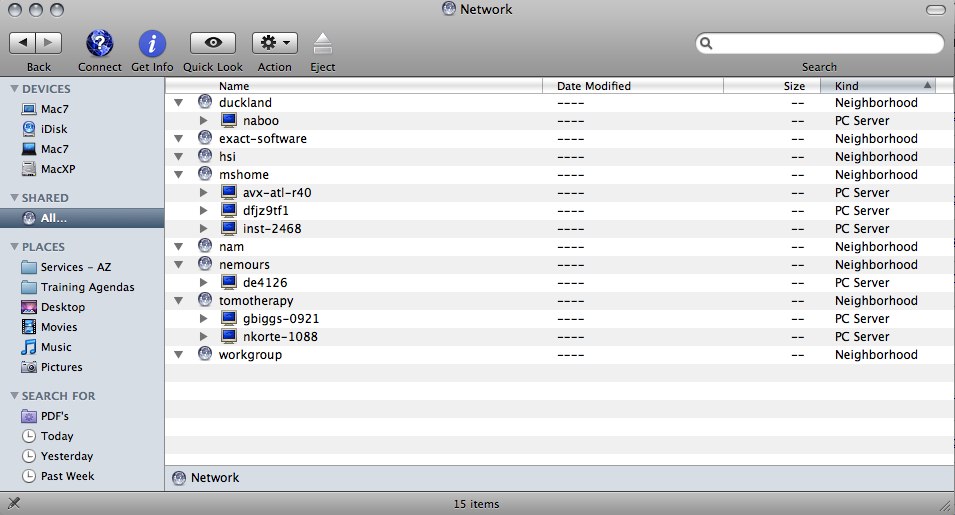

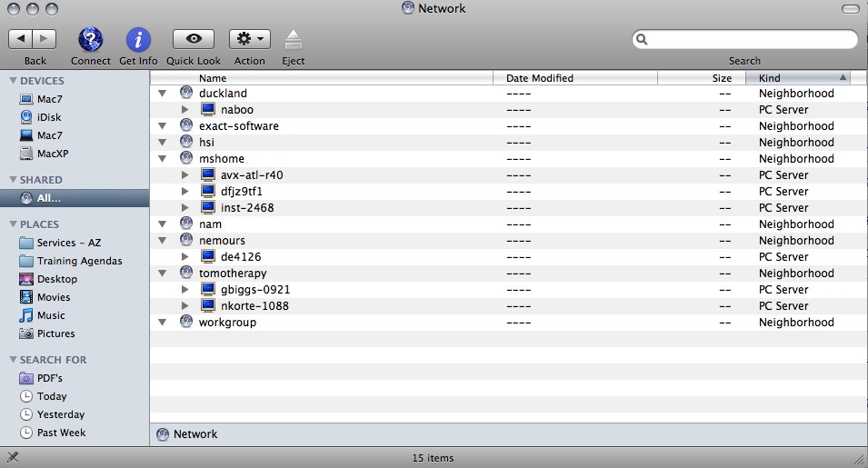

As has been stated, you see them, not necessarily them seeing you. Here's who I see from my hotel right now...
