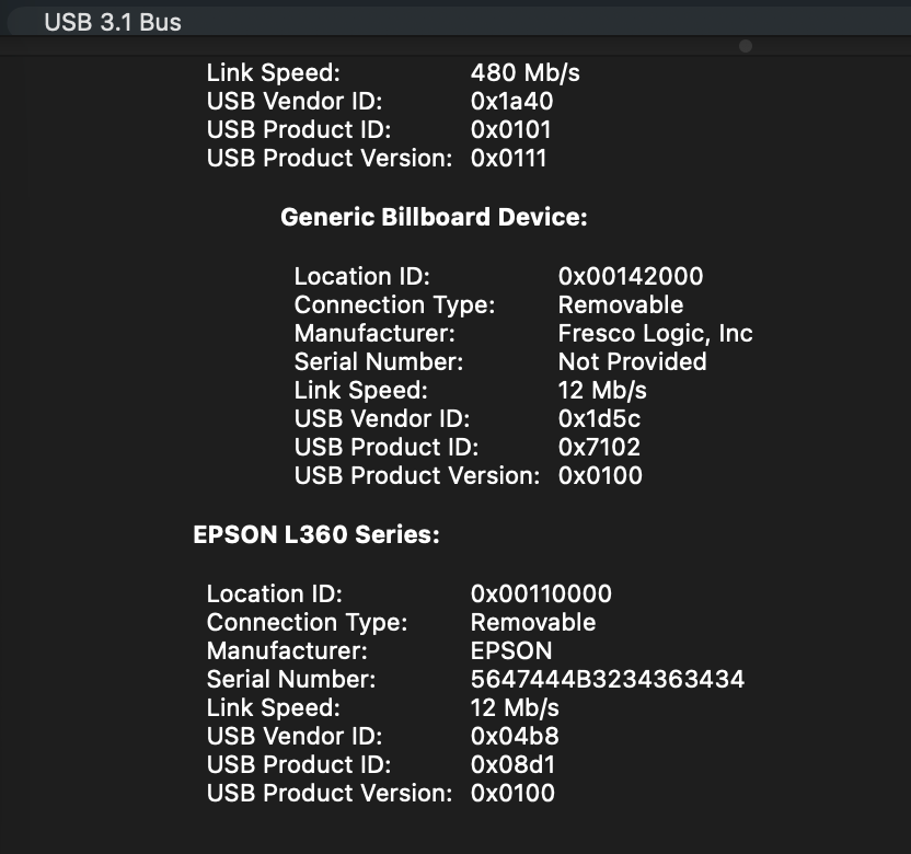

Tough one. Did you try the other USB port on the M4?
Yes, I did. The Epson printer shows up as a USB 3.1 device in system info.

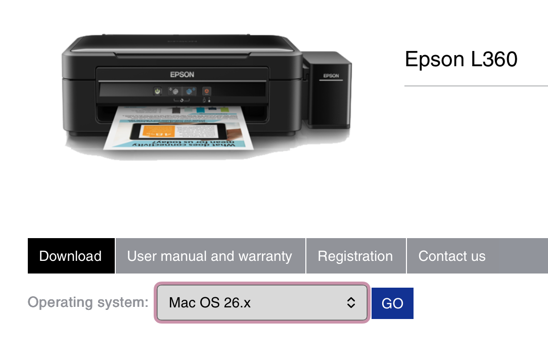

Tahoe driver available.​
